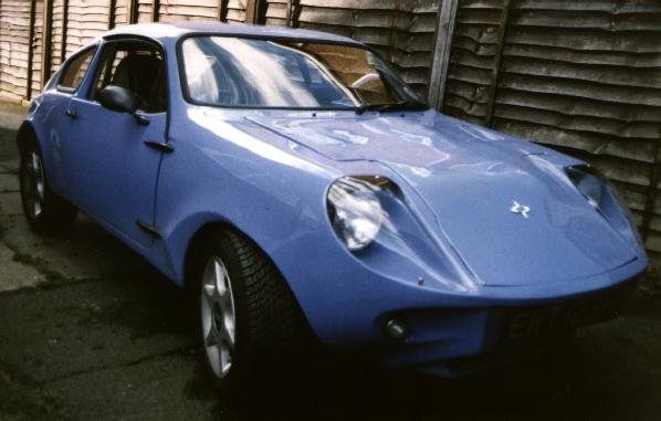

Having owned my Mini Marcos Mk. 3 for four and half years, I thought it about time to do a more detailed page for the website. Especially as I now find myself needing to sell the car. So it seems a good point to go over things I have been asked about at shows in the past before I am not around to answer them. The picture to the right shows how I inherited the car from the previous owner Mark Redgrove. Mark had done an impressive job of preparing the bodywork. However, that is about the only part that has remained. The body work being so perfect hasn't always been the blessing it might appear, but more of that later.

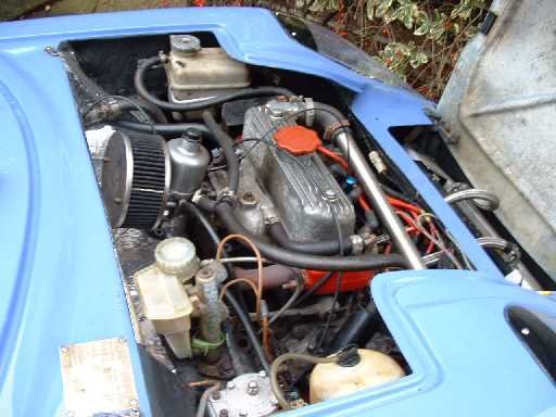

engine
Engine and Transmission
The Engine started lift as an MG Metro engine but has been completely rebuilt with new bearings throughout, special features include; an MED Fast Road/Competition Unleaded Cylinder Head, mm Inlet Valves, mm Exhaust Valves with dual valve springs, with Kent 286/2 cam. The bottom half of the engine is standard apart from a lightened flywheel and touch wood has been happy to rev to 7000+ rpm. The cooling system is mostly metro and uses a front mounted radiator. The Exhaust is completely Maniflow aside from a small section made by a local fabricator (Gran-Fabrication) to actually make it fit. I wouldn't buy the exhaust again (because of fitting problems) but the LCB seemed to add something to the performance when first fitted. The made floor was previously modified using a mould taken from a 2l coke bottle.
The transmission was also refurbished while the engine was out with race spec baulk rings, high strength shafts and a high spec differential kit, but no limited slip. The gear linkage has been extended to move the shift closer to the driver and has benefited from a KAD quick-shift.

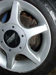

Brake System
The Brake system; Metro Turbo Vented Disks and 4 Pot Callipers, Rear drums, with front rear split and Adjustable Rear Brake Pressure limiting Valve. EBC Green Stuff Pads (Now there warn in they are great, but do have to like hanging off the seat belts, when they are cold their only average). The brake pressure limiting valve is a valuable addition, giving greater stability during braking (Mini Marci don't really need rear brakes).
