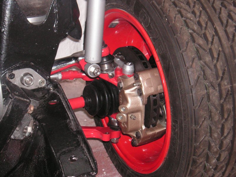

Phil Smethurst writes: “The pictures are of my Mini Marcos resto which I bought a long time ago and used for one year before the engine died ... now the car is prepared as a road car with weekend motorsport intentions. The engine is a 1293cc unit with Richard Longman GT15 head with 1.5 roller rockers and a non scatter 296 Kent cam. There is a reground, cross drilled, wedged, nitrided and centre strapped crank and a few other bits and pieces like a s/c c/r 4 speed box with 1:1 JKD drop gears and a tran-x 4 pin diff. I have done almost all the work myself except for some of the engine machining, the bending of the pipe for the rollcage and the wiring.”
