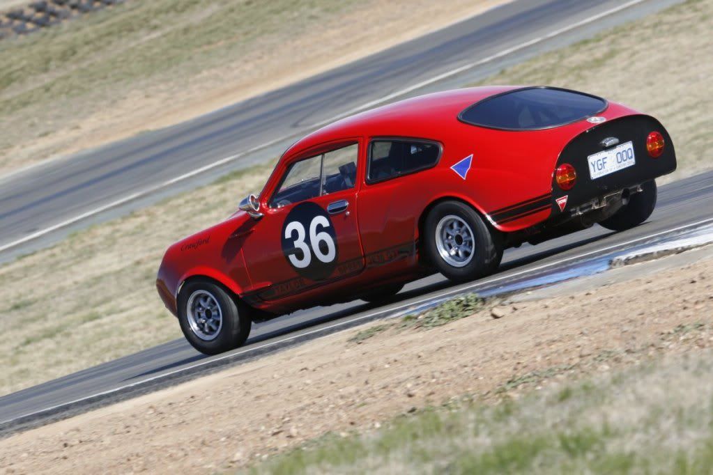

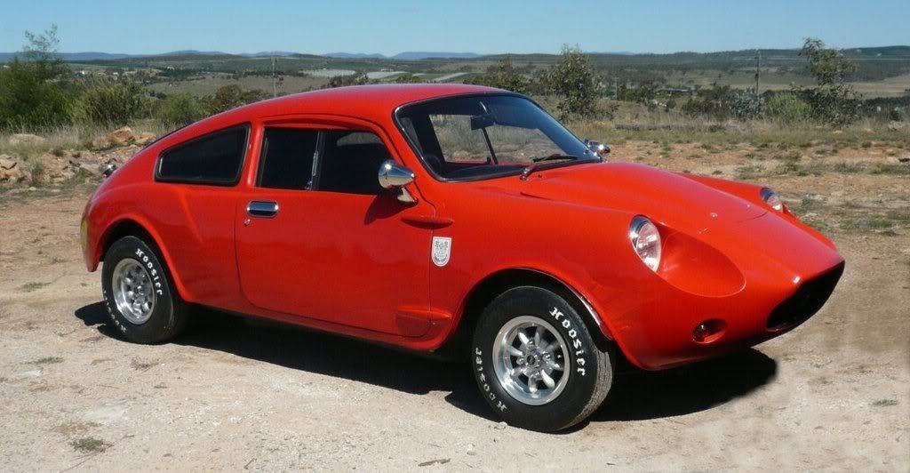

OK, so I thought I would start a thread (like I have seen on other forums) updating the progress, share idea's and ask questions concerning my car.

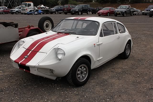

Here's a pic so everyone knows what we are talking about:
I finally got it registered last Monday so it is great to be able to drive it around finally! This really helps to identify faults and improvments that I need to do.
I spent last weekend sorting out all the suspension geometry. I hadn't bothered doing this until after I got it passed for rego (I had to jack up the front to get it through). It was wandering over the road quite badly so it was a bit of a priority to get this sorted. After I lowered it to a more suitable height I checked the castor and found it was way out! 0 deg on one side and -~5deg on the other (no wonder it wasn't holding holding a staight line to well ) So I set both sides to a more reasonable 3.5 deg. The camber on the front was 3.5 and 3 deg negative so I set both these to 2.5 deg negative. Did the toe in and the car was much better, still seemed a but taily though so I strung the car and found the rear drivers wheel was toeing out 7mm and the rear passengers toeing out 2mm! Both rear wheels had .5 deg positve camber as well. So I fitted some adjustable toe/camber brackets and managed to get both wheels aligned and toeing in 1mm and the camber to 1deg neg on both side's. Car is 20x better but it does seem to bump steer/wander slightly still so there are still improvements to be made.
Next thing I need to sort out is the fuel pickup from the tank. It has an enlarged van tank so it now has around 50 litres capacity but when it is at about the 22 litre mark it starts to suck air/fuel. This is about the height that the fuel pickup goes into the tank so I would say that there must be a crack or something in the pipe to cause it to suck the air. Does any one have any idea's on this and if the internal pipe can be replaced at all?
Edit: Shadow removed

Car is looking well Syd. Have you got rose jointed suspension on the front or is it just standard adjustable stuff, how did you adjust the castor ?

Looks like COTM for November is sorted! Just need to paint out that shadow at the front
You adjust the castor angle by using adjustable tie bars in conjunction with adjustable bottom arms. It needs a bit of juggling because changing either affects castor, camber and tracking. How are you measuring the castor angle?
I don't think you can do anything about the fuel pickup without opening up the tank. You might be able to cut a hole around the outlet union big enough to withdraw the pipe and filter, and then weld it back in when you've corrected the problem. It might be easier to block off the current outlet and fit a new pick-up pipe from the top, with an external filter.

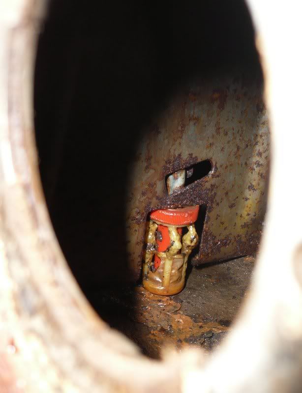

I pulled it off to have a look and found the flow from the tank was pathetic, so it is acctually the tank that is the problem and the pump has just died of natural causes (ie.. skid pan).

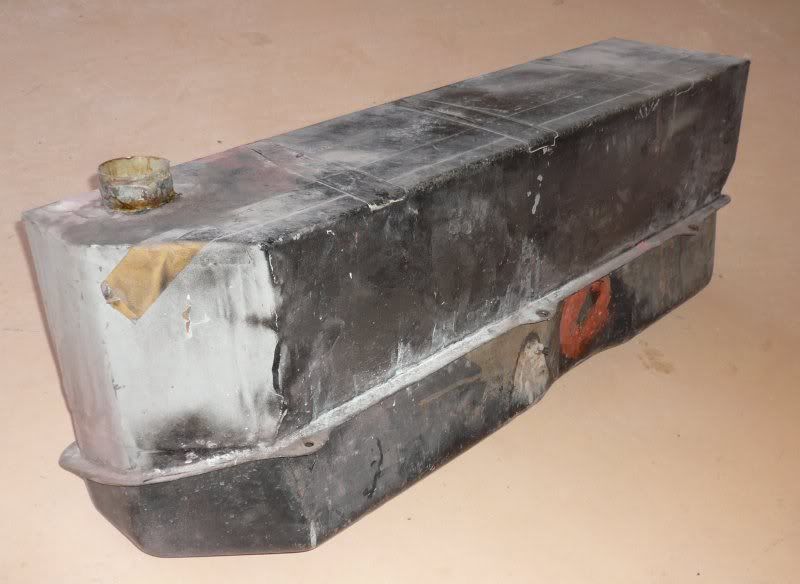

So I've pulled out the tank and fount this.
mmm... almost looks as if the filter has melted somehow there's heaps of rust and junk in the bottom of the tank as well so I'd say the pickup was getting pretty blocked.
At least with the tank out it is a good opportunity to fill the old tail light holes and fit my new ones

That's a fair sized tank Syd, there must be some distance between the petrol stations in Oz.

It looks like the tank has had a enlarged top welded on and probably melted the pick up filter at the same time.

Could be Paul, hadn't thought of that.

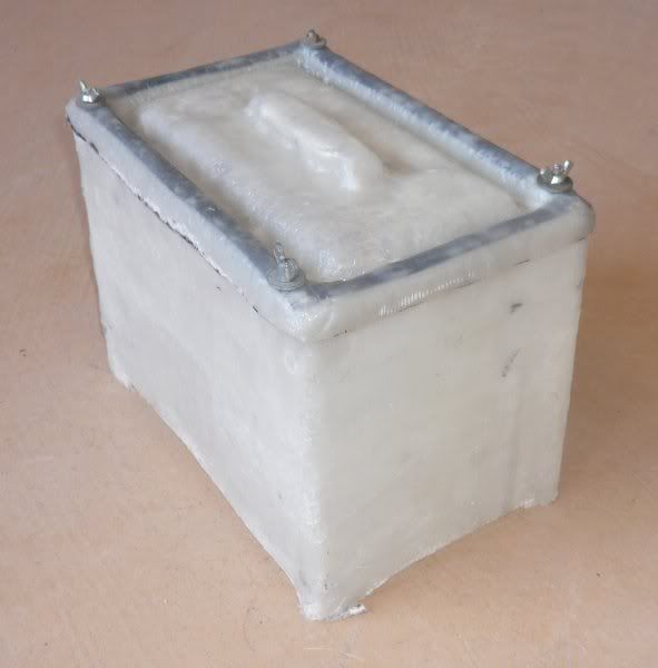

OK, a bit of an update. I've been busy over the last couple of weeks getting my Jem back on the road. What started off as just replacing the fuel tank turned into doing other things while I was at it. Seeing as the tank was out it was a good oportunity to replace the tailights (ex VW combivan) with some nicer ones (I think anyway) that the number plate would fit between. So I fibreglassed up the old light holes (first time fibreglassing), hi-filled, repainted (Black), and fitted the new lights. Then I had to remake the rear wiring harness because the new lights were further apart. While I was enthused by fibreglassing I decided to make up a properly sealed battery box:
I'll glue it into the current box and drill holes to vent it to the outside.

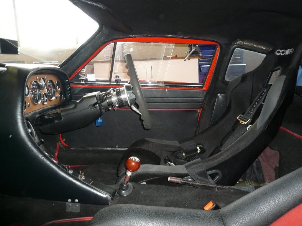

I replaced the column with a Mitsubishi Lancer one (Double uni, colapsible, height/length adjustable) but haven't got around to replacing the wheel with something more suitable to the car. I was thinking of one of those quick release hubs as well (especially when I get a roll cage fitted).
I don't think you would really want that bridge - imagine all the Aussies that would be hassling you with NZ jokes

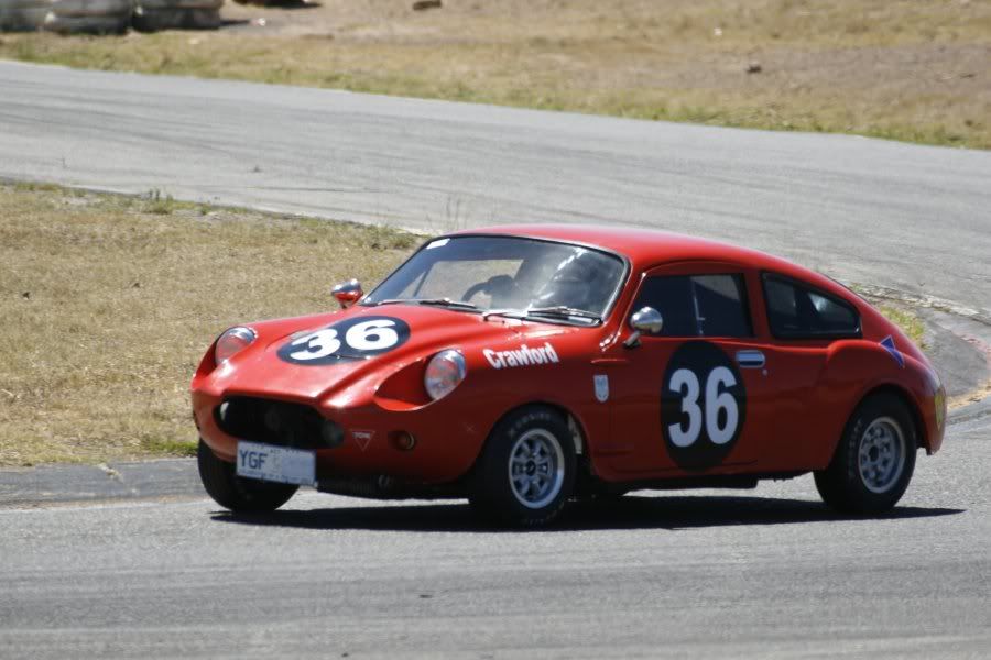

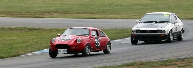

Took the car up to Wakefield Park on Monday. Nice to stretch her legs finally!

It has to be fun to get it on the circuit! That Subaru was thinking... I can get you.. NOT

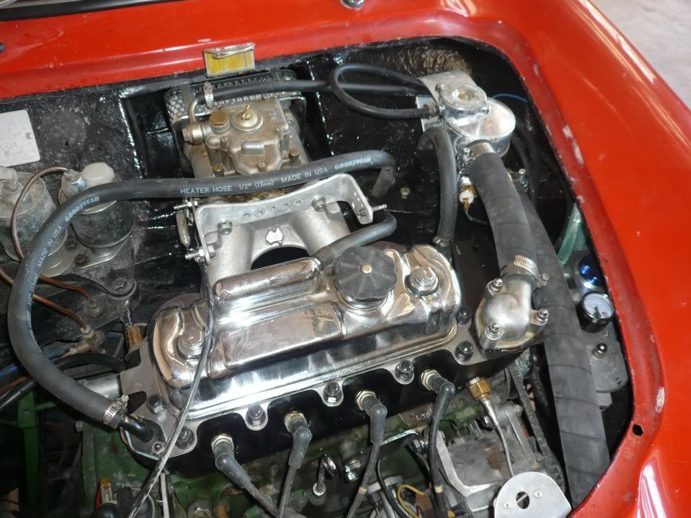

A bit of an update.
Car is almost together again after a few improvments.
Fitted a D1spec quick release steering hub and adapted it so I could fit my Maxrob wheel. It brings the wheel a fair bit closer but I needed this so it works well (Thanks for the recommendation Tim
Had a swirl pot/header tank made up to replace the useless system I had before. Had the guy put in a threaded outlet for the thermo fan switch as well. Also fitted an expansion tank.

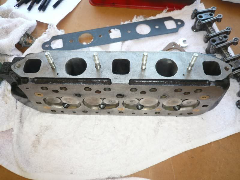

I purchased a race head from a guy over in South Australia and it arrived yesterday so I was able to fit this as well. Also changed the extractors to a better set. All that's left to do is modify the exhaust system to fit the new extractors. Looking forward to seeing how much of a difference the head makes

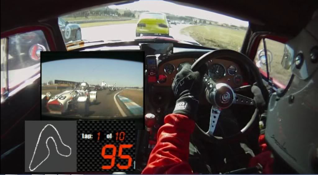

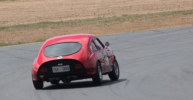

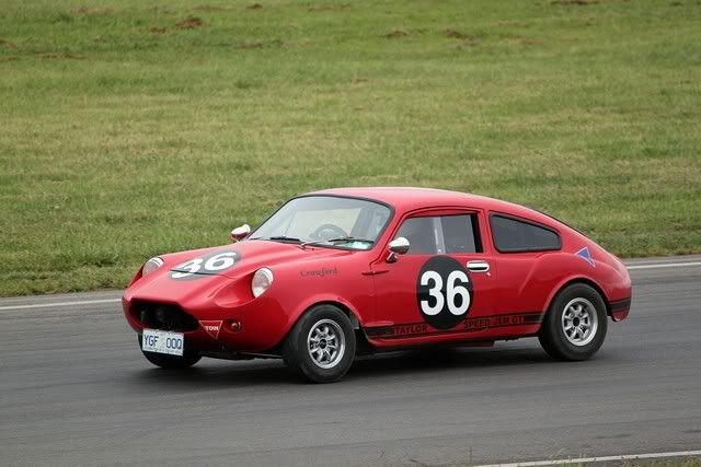

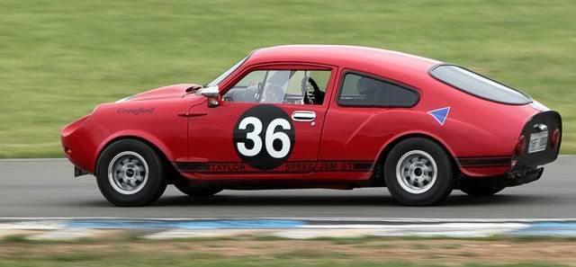

I've been busy trying to get my car ready for it's (and mine) first race at 'Oran Park' before they close this track for good. All went well, kept out of trouble had heaps of fun. Only snag was in the last race the main oil cooler hose blew off at the end of the main straight! Luckily I switched it off before it did any damage - but it did red flag the race which was unfortunate (especially seeing as it was the last Mini race ever at Oran Park).
Photo's here: http://www.ausmini.com/forums/viewtopic.php?t=59534
and here: http://www.ausmini.com/forums/viewtopic.php?t=59544

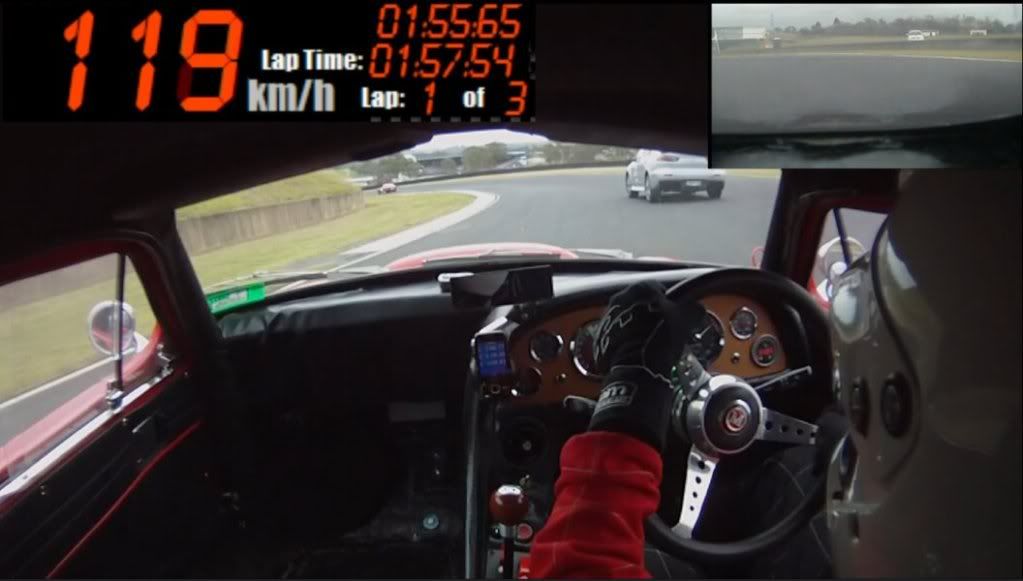

Incar Video of race 1 here:
Syd
Last modified February 3rd, 2010, 06:09:36 by Syd Crawford
