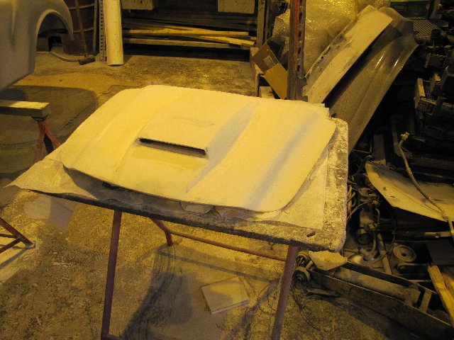

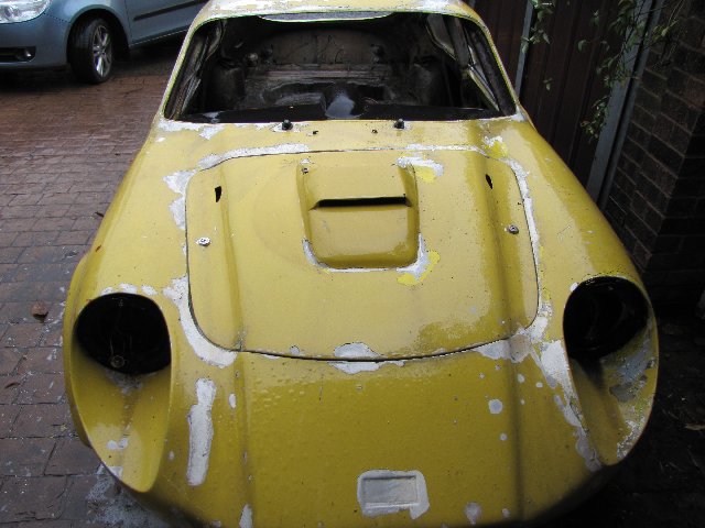

I have decided to refurbish the original window frames and use acrylic for the door windows and rear screen. I have found that the passenger door has a glass window and some old felt in the runners so it needs a gentle push to get it up or down. The driver's door has been changed to perspex at some time and there is no felt in the runners, causing it to drop like a stone when released. I had my old perspex rear screen measured and it is 5mm, so, assuming I can get suitable felt channel for the door windows, I intend to have all the acrylic pieces made with that size material. I'm going to the kit-car show at Stoneleigh over the May-day bank holiday to see exactly what felt channels are available and how others seal their cars from the elements these days.
I have also had a lot of trouble fitting a suitable bulge in the bonnet. It sounds so simple, but has proved to be rather difficult. I decided that this should be done before the car was stripped and with the original 850 engine in place. I fitted my 45 DCOE to the rusty 850 engine and told the bodyshop to make sure the bonnet bulge cleared the 45 DCOE throttle linkage. This was done and it looked great. However, when the new front sub-frame complete with 1380 engine was fitted to the body to make sure everything fits (gear linkage etc) before removing it again for painting, I found that with the 1380 in place, it is a MUCH taller engine than the 850, so the bonnet now catches the rocker cover, thermostat housing and the throttle linkage, so all that work on the bonnet has been an expensive waste of time and I'm having to cut it all out and fit a much larger bulge to ensure clearance. In hindsight, the bonnet should have been the LAST part of the bodywork to be fettled and I don't suppose this will be the last of my problems with this re-build!

There are at least three different bonnets. The Mk.1 bonnet has a different outline (bigger), and there are two different size bulges for the Mk.2 and later cars. The small bulge is OK for small block engines (up to 1100) but you need the larger bulge for 1275s.

I have bought another bonnet vent on e-bay. It is called an XXL 11, which measures 47 cm wide, 50 cm long and is 4 cm high. I have measured the bonnet and I think this one will do the job. Photos will follow.....eventually!!

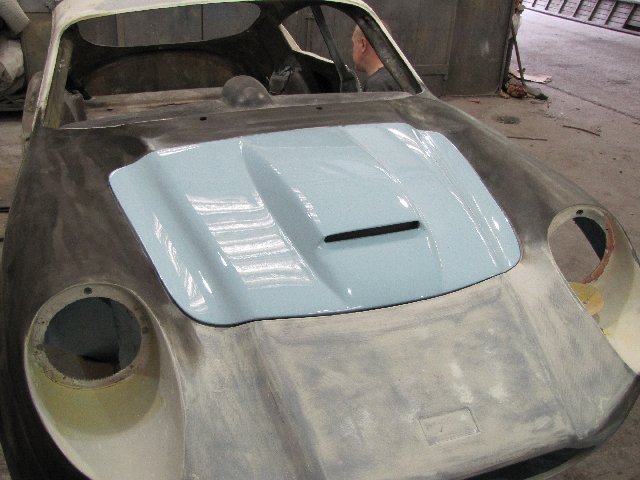

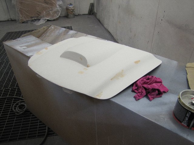

The Mini Jem bonnet is finally finished. It now has a double,
forward-facing scoop, which clears both the rocker cover and the 45 DCOE
carb. It is painted in  BMC Iris Blue and fits correctly in position.
