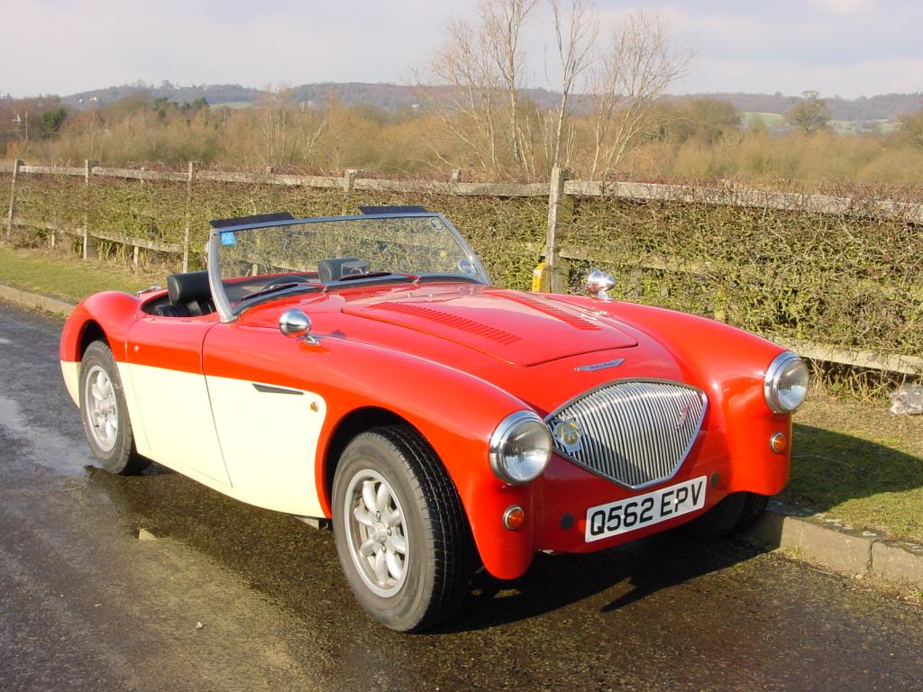

Well I thought that I owed you all a great big THANK YOU for all your support and encouragement during my 6 year project of refurbishing my brother-in-law's Jem. I will, over the coming weeks, post some details of my trials and tribulations encountered on the way.
It all started way back in the early 70's when he and I both built kit cars, which were all the rage at the time before rust prevention. He built the 1100cc Jem and I opted for a 2lt Pinto engined Healey 100 replica, a Haldane 100 (now residing in Germany I believe).
The Jem had a minor front end bump and was taken off the road for 'upgrading' and spent the next 40 years or so languishing in the drive under tarps.
Approaching retirement, I was looking for a project and asked if he'd like to see the Jem back on the road. He said "yes" and gave it to me, lock stock and barrel.
Well it's just had it's first MOT and is 99% finished (they're never 100% are they?).
I'll attach some before and after pics.

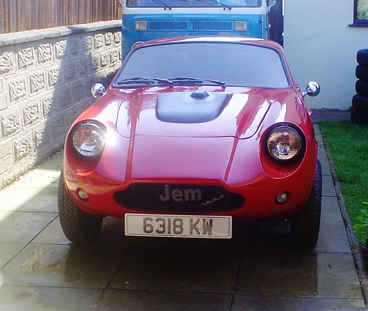

John_Campbell
Posted on: June 6th, 2017, 10:19:18
Quote Report to Moderator
Minimum Member
Posts: 94
After
Private Message Reply: 2 - 68

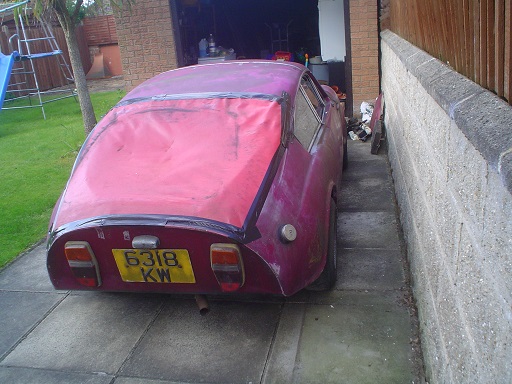

John_Campbell
Posted on: June 6th, 2017, 10:19:40
Minimum Member
Posts: 94
Before
Private Message Reply: 3 - 68

Goff_Allen
Posted on: June 6th, 2017, 15:43:33 Quote Report to Moderator
Location: Maltby ,South Yorkshire
Posts: 399
Nice to see you got on the road , I like the cut out for the number plate and the back lights .
Private Message Reply: 5 - 68
John_Campbell
Posted on: June 6th, 2017, 17:27:15 Quote Report to Moderator
Minimum Member
Posts: 94
Thanks Goff, the thin strip under the plate is an LED array and acts as the reverse light. I kept to the original where I could but gave in to some modern updates when tempted. I modelled the back end on a classic Alfa (can't remember its name).
Private Message Reply: 6 - 68

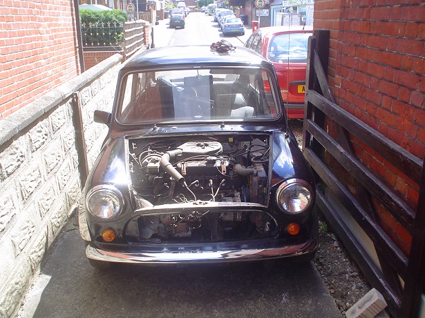

Posted on: June 8th, 2017, 09:24:49
Minimum Member
Posts: 94
Well here were my initial discoveries. Engine was OK but leaded so would need unleaded conversion (or those little bags of 'lead' balls that you dropped in your tank, remember?). Bodywork had every fibreglass problem known to man, stress cracks, breaks, holes, osmosis spots, you name it, and bodywork is my least developed skill. Interior was completely trashed but subframes looked not too bad at this stage. I wanted to keep as much of the original as possible, if for no other reason than to keep costs down, so refurbish where I could. So that was the plan.
Private Message Reply: 10 - 68

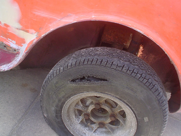

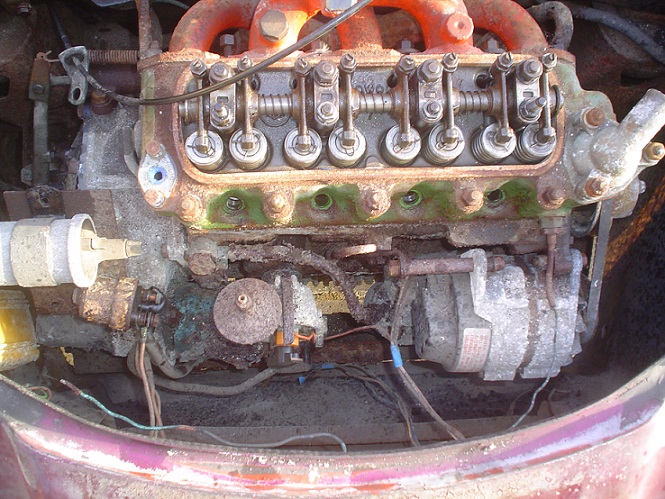

John_Campbell
Posted on: June 8th, 2017, 09:25:50
Minimum Member
Posts: 94
and more
Private Message Reply: 11 - 68
Simon Robinson
Posted on: June 8th, 2017, 21:04:06 Quote Report to Moderator
Location: Northampton
Posts: 338
John - an alternative to unleaded conversion is using Castrol Valvemaster - liquid added to the tank every time you fill up. A lot cheaper than converting the head, especially if you're doing limited mileage. Costs about £12 a bottle and that will treat 250 litres of fuel.
Private Message Reply: 12 - 68

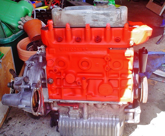

John_Campbell
Posted on: June 9th, 2017, 09:04:39
Minimum Member
Posts: 94
My thoughts turned to that engine. If I strip it and recondition it and get the valve guides 'unleaded' it would probably set me back as much as getting a 2nd hand 'runner'. So my quest began. If you have no rush, on eBay, and bide your time, you can often drop on some great bargains, and so it happened for me. After many months of looking, local to me, a garage had posted a 1992 Mini Cooper 1275, 64k, MOT failure with good mechanics but dire bodywork. I posted a speculative bid and managed to win it for just £500 and got them to throw in MiniLite alloys with new tyres - result. So I now had my new donor for the kit. It ran well and selected all gears easily with the additional bonus of having all the ancillaries that had perished on the Jem.
Private Message Reply: 13 - 68
John_Campbell
Posted on: June 9th, 2017, 09:26:37
Minimum Member
Posts: 94

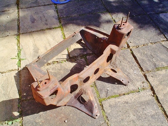

Moving forward a year or so and I'd sold the original 1100cc engine to a restorer in Scotland (£160), stripped the donor using what I needed and reselling the rest, getting £350 for the rolling shell from a very grateful Mini lover and topping up my Jem fund substantially. Hang on, at this rate I'll be making money out of this build, which got me thinking (what do you mean 'that's unusual'?)............ Using eBay could be a big help in funding the project, so I sold everything I could lay my hands on and made a small fortune (well more than £1000 anyway). My piece de resistance was stripping down a broken £200 GTech vacuum cleaner into its component parts and selling them for a total of £223.07.
Private Message Reply: 14 - 68
John_Campbell
Posted on: June 10th, 2017, 10:50:25
Minimum Member
Posts: 94
So onto the strip down which is by far the easiest bit, even with all those rusted nuts and inaccessible niches. Time to find out that I can't actually fit into a Mini Jem (the clue is in the name John) before months of bending and craning, reaching and stretching finally transform me into the lithe supple man I am today. Surprisingly, the subframes turn out to be almost pristine (good old red lead) and once the underseal came off, I discovered that the rear one was once owned by the Air Ministry, so obviously not from the original donor. MiniFins all round, again in remarkable nick, as was the tank which was still shiny inside! so most bits looked eminently reusable, Hurrah. After a few , many, lots, thousands of hours of scraping, sanding, scouring and cleaning, I used Vactan rust converter which seems to do a great job on the bits that were left, covered with Hammerite and finished off with underseal/Waxoil. Funny thing is, I used to mix Waxoil into my underseal 40 years ago to make it more sticky/flexible, do you think I could get some royalties? Old school, I know, but it did the job originally so who am I to argue? And so onto the bodywork - Oh no!...............

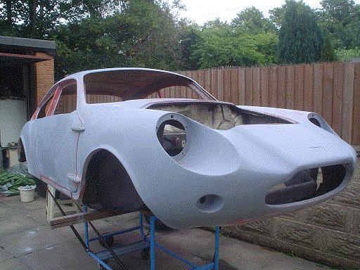

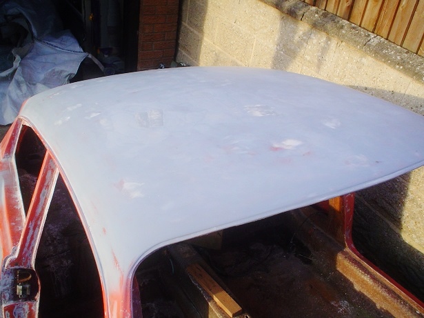

John_Campbell
Posted on: June 13th, 2017, 09:43:21
Minimum Member
Posts: 94

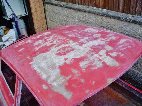

I think I mentioned that I was rubbish at bodywork, well here's the proof. After extensive research on repair methods, you guessed it, I ignored all the good advice and did it my way (and you wonder why I'm so bad). All hairlines got ground out and filled with Isopon P40, then skimmed with P38. Proper cracks got the 'grind both sides and lay up glass' first. Osmosis was ground within a hair's breath of its life first. Then came the rubbing down. Who'd have thought it would take forever to rub down such a small car? The observant amongst you will have noticed that I didn't skim the whole car (mistake) and that creating a mirror finish with 600 grit at this stage is not conducive to getting paint to stick. Still I was still pleased with the result. Then on to paint next (lovely).
Private Message Reply: 18 - 68

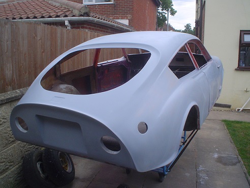

John_Campbell
Posted on: June 13th, 2017, 09:44:08
Minimum Member
Posts: 94
Mid way through
Private Message Reply: 19 - 68

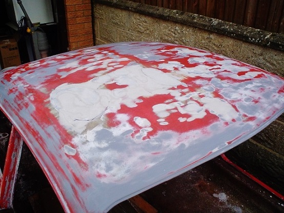

John_Campbell
Posted on: June 13th, 2017, 09:44:47
Minimum Member
Posts: 94
After (Hmmmmm....)
Private Message Reply: 20 - 68

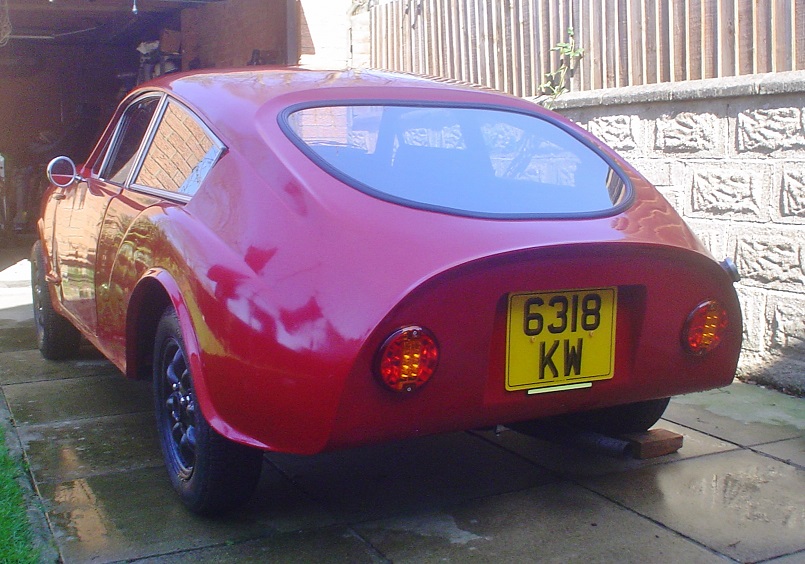

John_Campbell
Posted on: June 13th, 2017, 09:53:27
Minimum Member
Posts: 94
And rear.
BTW I took her out on her first long run yesterday to see my 97 year old Mum up in Grimsby. Yes she fitted in and of course she loved it (after all she is my Mum). 240 miles, Norwich to Grimsby, looks like around 50+ to the gallon?? No real issues, the only minor (?) one was a slight hesitancy at the sweet spot between accelerating and decelerating.
Private Message Reply: 22 - 68

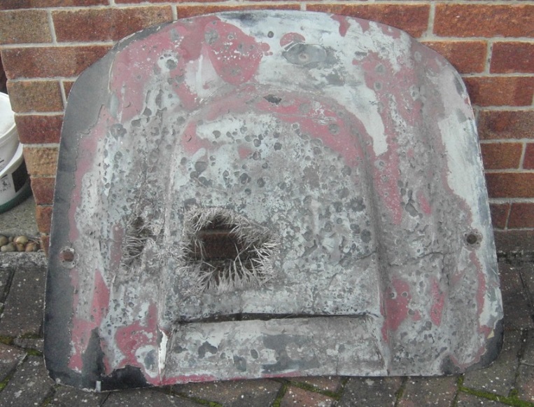

John_Campbell
Posted on: June 13th, 2017, 11:06:02
Minimum Member
Posts: 94

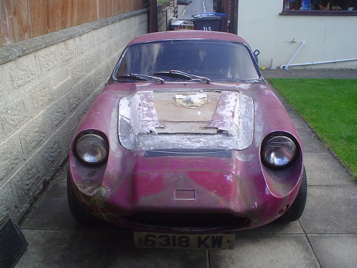

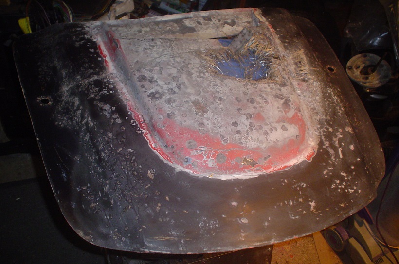

Oh! I forgot all about the bonnet. I was missing the bonnet (no surprise there then) when I got the Jem so I put a plea out on this site. After a few false starts Good old Richard Porter offered me an old dusty one that he had lying around to see if I could use it.
Private Message Reply: 23 - 68

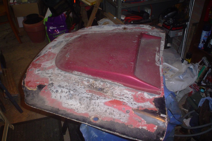

John_Campbell
Posted on: June 13th, 2017, 11:08:33
Minimum Member
Posts: 94
After a little (a lot actually) elbow grease, it started to look a little more presentable, of course you had to be there.
Private Message Reply: 24 - 68

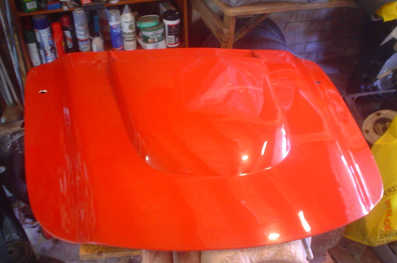

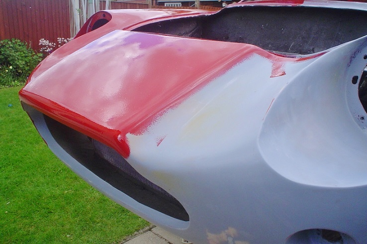

John_Campbell
Posted on: June 13th, 2017, 11:11:33
Minimum Member
Posts: 94

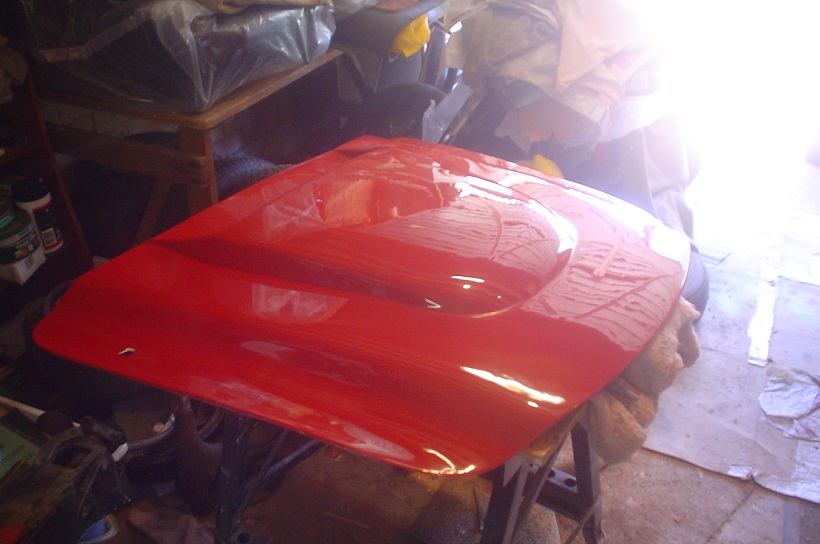

The problem that I could see (how could you miss it?) was that the vent in the bulge was a bit bigger than I needed. Fortunately I did have the original bulge cut from the original bonnet so I decided to do a transplant.
Private Message Reply: 25 - 68
John_Campbell
Posted on: June 13th, 2017, 11:16:08
Minimum Member
Posts: 94
Then a bright shining thing appeared at the the garage door and 'Voila!', a transformation occurred.

Your method of repair whilst not the best will give good long lasting results. It's much worse when people use just filler or gel coat as the cracks just come back through. P40 has fibres in it so all good.
Your car looks great in just wish I had the time to start mine but alas to many other projects in the queue at the moment.

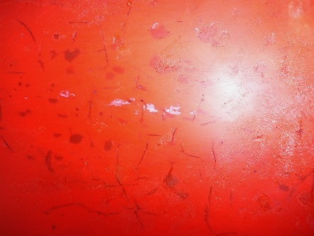

So on to paint. Before I explain, I want you to take a deep intake of breath and make yourselves a strong coffee as this makes difficult reading for traditionalists, (but you do get the last laugh).
My other current project is a VW T2 camper, and during my research I found that 'Dubbers' (as they're called), have found a paint which a) is oil based, b) can be hand painted, c) is rust inhibiting and d) is cheap as chips, called Rustoleum. Well that suits me down to a T (especially the cheap as chips bit). It takes a bit of elbow grease but seems to give a great finish.
So buoyed with this secret out came a £35 tin of Rustoleum and a roller!
Private Message Reply: 29 - 68
John_Campbell
Posted on: June 14th, 2017, 09:14:22
Minimum Member
Posts: 94
Lots and lots of rubbing down, followed by Rustoleum Crystal Clear and more rubbing and polishing, and Hey Presto! look at what we've got.

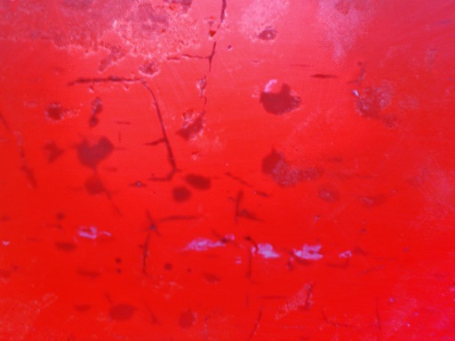

John_Campbell
Posted on: June 14th, 2017, 09:45:34
Minimum Member
Posts: 94
Ok OK I hear your deep intake of breath. Now for the 'I told you so' moment. Yes, from about a yard (metre for youngsters) away, it looks pretty passable, but to the observant it does sport several problems. Firstly, through no fault of mine, insect crap (why on earth do they call it honeydew? Yuk), after removal has etched through the gloss and left a matt spot (not good). The points where I'd run out of grey primer and stupidly rescued a tin of yellow from the top shelf, if you look very closely, altered the colour slightly (not too bad). Elsewhere I was too aggressive with my finishing sanding and have gone through the clearcoat in a few places (oops!). A few pinholes that I missed in my euphoria followed by many dings and scratches during its rebuild in the garage. But having said all that, for less than a hundred quid, I'm pretty pleased with the outcome. And so onto the rebuild now. Stop laughing.

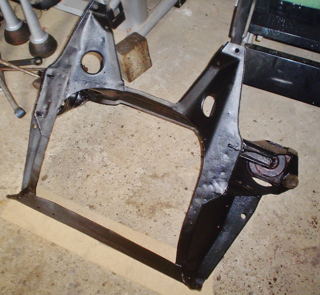

John_Campbell
Posted on: June 15th, 2017, 08:20:44
Minimum Member
Posts: 94
Most of this was carried out in my new custom built Japanese style garage as 'our' double garage (in length) isn't really for cars, it houses everything but. This would have to change before winter set in.

Oh yes, ha ha. I did try to make some front bonnet hinges. I designed, mocked up, prototyped and eventually manufactured some beauties out of ali. They didn't fit! they scraped the front of the bonnet, no matter what I did, so I came up with a novel (and far easier) method, bullets and sockets, and they work a treat.
Minimum Member
Posts: 94
So, subframes fully loaded and fitted, engine in, cooled, fuelled, oiled and powered. Electrics connected and tested, and five hard years of toil described in one sentence. And we've yet to talk about the interior consuming another year of my fast declining quota. Anyway here she is.

Just a final word referring back to the bonnet and new found bulge. When replacing the bulge with the original, I hadn't spotted the thread on here about different bulges for different engines (oops!). Also when I got the Jem, I mistakenly assumed (never assume, John) that it had been running with the after market exhaust/inlet configuration, so when I fitted my HIF carb, yes you got it, it stuck up a mile. AND the damned thing wouldn't clear the thermostat housing or the rocker cover. That was a sad, sad day. So, added additional bulge for the carb, fitted low profile thermostat housing, fitted ali rocker cover and filed off a few fins and she just slips on nicely (good job John, nice one, your the man) Phew!
