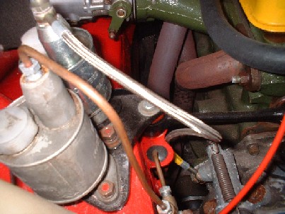

This weekend I am again working on my Marcos, I came across the problem of a sticky clutch. Also the hose from the slave to the pipeline was broken, this I knew. I have replaced this with a metal wired one.
While dismantling the clutch hose I had to remove the top engine stabilizer, here I noticed the rubber bushes where in bad shape. These are going to be replaced with polystyrene bushes.
Rebuild engine  1312CC  .

Neil KilBane
Posted on: May 6th, 2007, 09:58:21
Quote Report to Moderator
Maximum Member2
Posts: 1,391
Reputation: 0 (tot: )
You should use the Goodridge hose with the banjo bolt ends that goes directly from the mastercylinder to the slave cylinder, the hose you have is for the non-verto type clutch slave cylinder, I think.

Neil KilBane
Posted on: May 7th, 2007, 23:43:12 Quote Report to Moderator
Maximum Member2
Posts: 1,391
My post was in response to reply number 14.

So the following problem aquurt one of the brake calliper was leaking so this needed a little T.L.C.
I have just mounted my brake calliper and it doesn’t leek anymore so tomorrow its test day.
