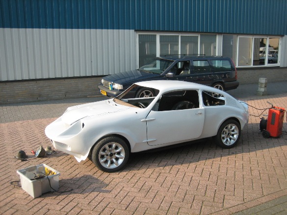

I've almost finished the speed-build of my Marcos, but don't know how much space is needed between the exhaustmanifold and the bulkhead?
It's a MK3, I've got a Sportex exhaustmanifold.
There is a space of 1,5-2 millimeter between them..
Is this a problem and is it gonna catch fire or something??
I hope to sort this, as I'm gonna leave for IMM Denmark in 2 days!
cheers, Oliver

Unless your engine is solid mounted the manifold will probably hit the bulkhead when you rev the engine. Which will either be very annoying or brake the manifold. It might be worth extending the top engine steady bar or fit an ultimate engine steady that you can adjust to the right length.
You could insulate the bulkhead with a plumbers soldering mat which plumbers use to protect the wall when soldering pipes together.
Good luck with the build it is looking good so far.

Mine got so hot that it singed the carpet underfelt on the INSIDE of the car! - and the manifold was further away than 2mm's. I fitted a thin metal heatshield with that non asbestos type silver foil that the racing guys use, glued onto it on the engine bulkhead side. It seems to work well. I am aware that some of you guys don't appreciate this...but I also wrapped the upper branches of the manifold with heat tape. Sorry!!!

Oliver - do you have a rear view of this car?  It looks to have a neat rear spoiler fitted.
Oh, and it looks good on Sportspack alloys too!
