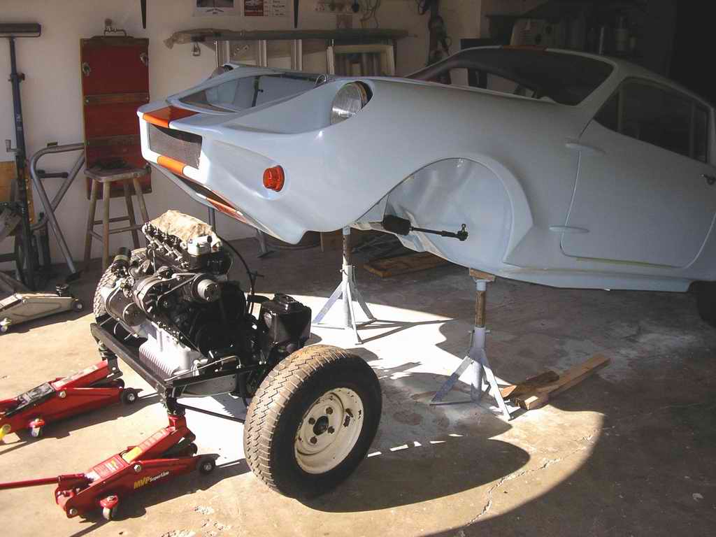

At last, the engine is back in the sub-frame.
Lovely jobble. ???
how the *$#@!?!!*** are we going to get the engine back in!!.

Bent Larsen
Posted on: April 23rd, 2008, 13:02:30 Quote Report to Moderator
Medium Member
Location: Denmark
Posts: 125
How did you get it out??
Private Message Reply: 32 - 46
Tertius van Zyl
Posted on: April 23rd, 2008, 14:47:41
Posts: 289
Reputation: -1 (tot: -1)
The normal way I suppose
Private Message Reply: 33 - 46
Gert-Jan Westerveld
Posted on: April 23rd, 2008, 20:31:47 Quote Report to Moderator
Medium Member
Location: The middle of Holland.
Posts: 164
the big moment is approaching engine is ready to be fitted.
It is not going in the way we  took it out.
We made us a things to do list, it is working, one day ahead.
Rebuild engine  1312CC  .
