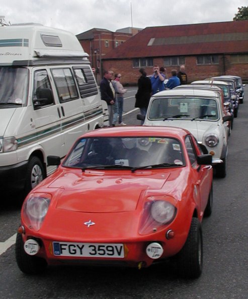

I just wonder how much it's worth trying to save a bit of weight when you still have that big lump of A-Series iron at the front?
Actually I chopped out quite a bit of weight when I rebuilt foggy's front end. Now the original flat nose panel and lump of wood supporting the new panel are gone, and it's much easier to get at the radiator and the front of the engine.

New front end looks good Rich
Do you fancy sorting mine out, seeing as how you're such a dab hand with the fibreglass???
Got to stay original I'm afraid - cast iron block it has to be... maybe I can loose a bit of weight myself...
