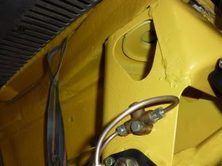

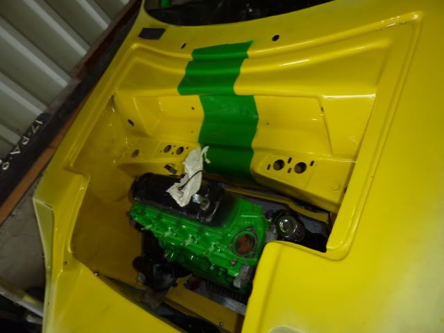

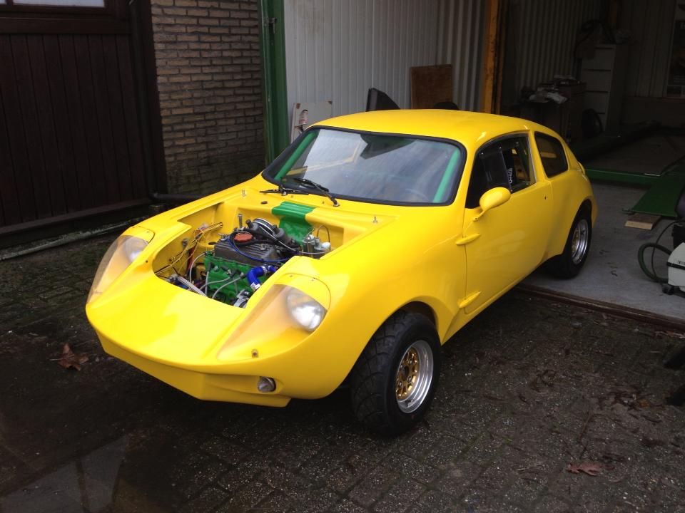

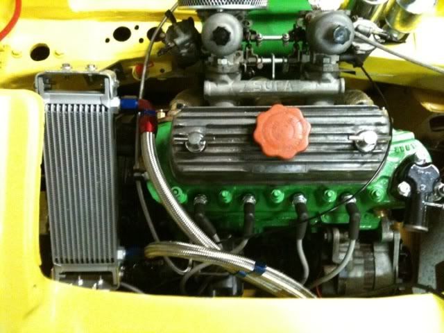

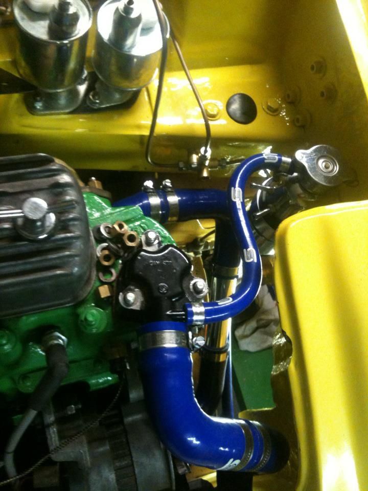

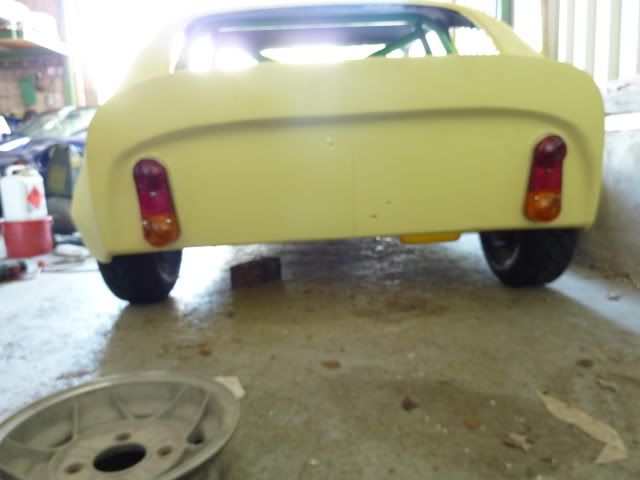

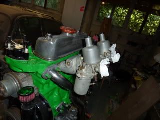

Hello,
I've been bussy preparing the engine for a respray. And this is the result. The colour is the same as the stripe that will run over the car and the nose.
Front
Back
First I sanded the engine to get rid of the rust. Then I sprayed 2 K epoxy on and wet on wet sikkens 2 K car paint. And ive polished the clutch housing! Please comment! (The pulley housing need work so dont look at that!)

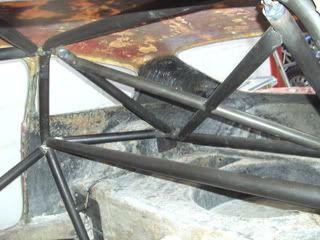

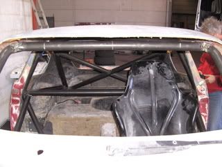

And the cage is in the making. Here some photos. (The hoop is going new because it needs a dubble bend, so dont look at it please) There is much more to come but this is a rough base.
The cross
Above the doors
Love this picture...
Please post comment!
Cheers
Last modified September 7th, 2008, 15:25:27 by Joost van Dien

paul harcourt
Posted on: September 7th, 2008, 18:47:37 Quote Report to Moderator
Location: Hampshire
Posts: 363
Looking good Joost, keep going!
Private Message Reply: 1 - 45

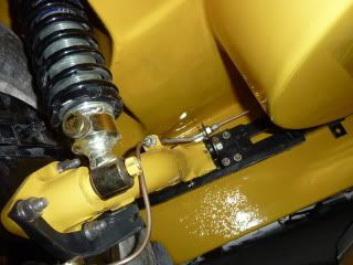

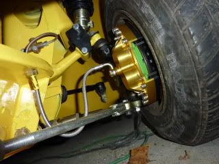

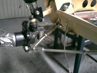

Hello,

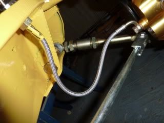

An update about the suspension so far.
I've blanked all the parts with a very hard steel brush which I fitted on the grinder. It works very well it only cost you a lot of hours for all the parts .
Then I sprayed 2k epoxie and then wet on wet Autocolor 2k car paint, the same color as the car gets! (sneak preview) I've made a compilation about the new and refurbished parts!
Rear setup with refurbished radius arm (not included brake setup)
Other side with new brake line and new bearings for the hub
Piece of the front setup with refurbished arm
Front brake and suspention setup with brake line
Front again
My excuse for the photos that laydown.. but can't get them right..
Please comment!
cheers
Last modified September 28th, 2008, 17:46:06 by Joost van Dien

Syd Crawford
Posted on: September 28th, 2008, 22:53:48 Quote Report to Moderator
Location: Canberra, Australia
Posts: 252
Well, that's just mini porn
Make sure you check for clearance with the coil overs. My friend had no front suspension yesterday at a race meeting here until he realised the bottom flange  that holds the spring on the coilover was locking up against the subframe tower. Fixing that improved his times by 2 seconds!
Last modified September 28th, 2008, 22:54:56 by Syd Crawford

Tertius van Zyl
Posted on: September 29th, 2008, 05:49:17 Quote Report to Moderator
Posts: 289
Reputation: -1 (tot: -1)
Syd, I recall someone here once telling me that ex motorcylce coilovers could be used on the rear in order to save costs. Ever heard of that?
Private Message Reply: 6 - 45

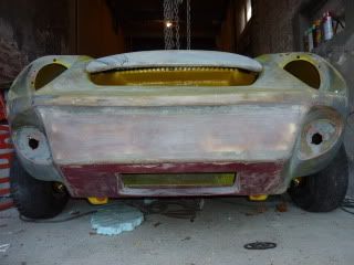

hello,

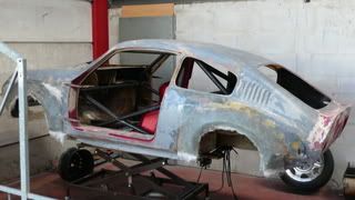

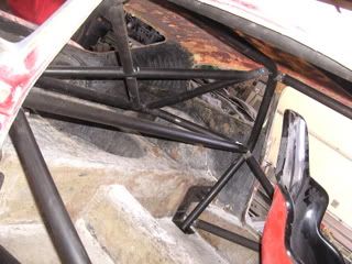

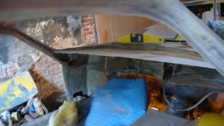

New photos from the cage! Its not compleet yet but nearly. Its A fully removible cage.
The front. Cross in the doors need to be completed, above window tube, and diagonal above the head.
Rear piece. Hoop is different with a bend in it. Extra tube between cross and diagonal for more stifniss but needs to be added.
Taken from front window
Please post comment
Cheers
Last modified October 5th, 2008, 16:18:37 by Joost van Dien
Private Message MSN Reply: 9 - 45
Syd Crawford
Posted on: October 5th, 2008, 21:21:09 Quote Report to Moderator
Posts: 252
Thanks for the pics. Havn't seen a main hoop bent at the bottom like that. Keep up the good work.
Private Message Reply: 10 - 45

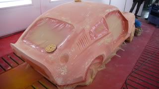

Joost van Dien
Posted on: October 13th, 2008, 08:57:12 Quote Report to Moderator
Drive it as much as possible!
Posts: 293
Reputation: 0 (tot: )
shame me.. I dont know lb/in my shocks are.. front is the lowered gaz and rear is normal hight gaz.. Has anybody got any experience with those shocks? And I never heard of motor bike shocks.
cheers,
Private Message MSN Reply: 15 - 45

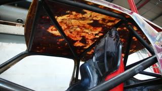

Posted on: October 25th, 2008, 17:41:13 Quote Report to Moderator
Posts: 293

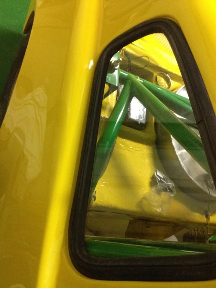

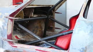

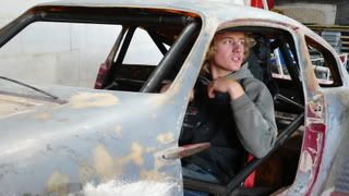

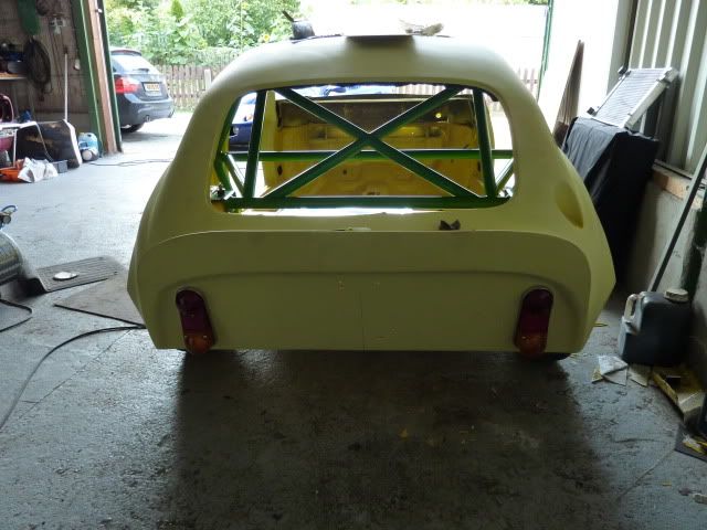

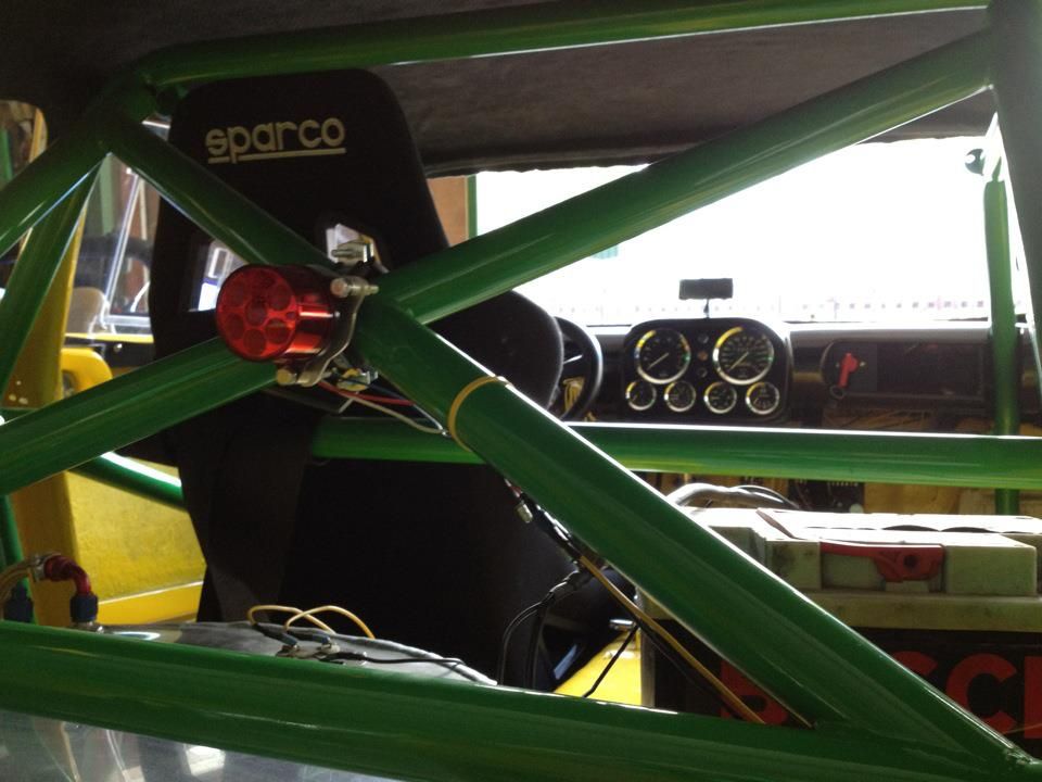

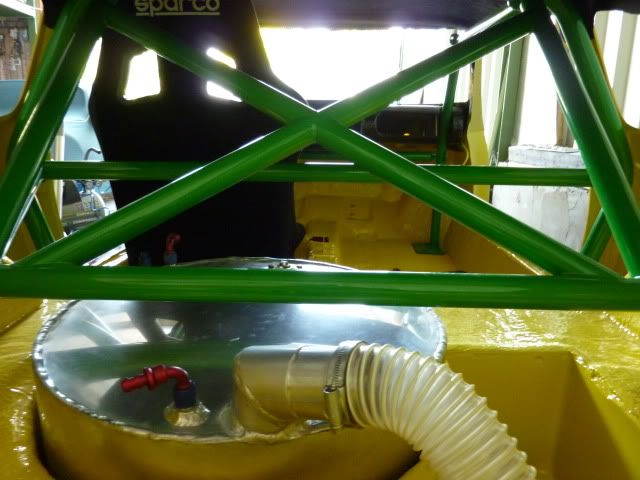

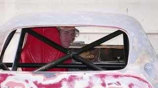

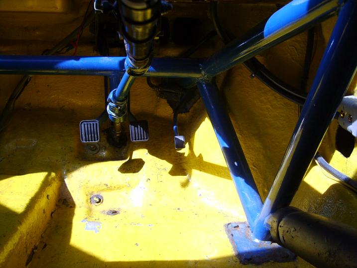

The cage is finished! Here the final pics of an unpainted cage.
Please give me feedback
Front
With proud owner
Peace of rear
Rear
Rear
Roof section
Front again
Me again
Love...
If any one wants full size pictures by mail please send me an pm with your email adress and I will send u a email with large photos (~3mb per pic)
Cheers,
Joost
Last modified October 25th, 2008, 18:04:55 by Joost van Dien
Private Message MSN Reply: 21 - 45

Allan Brown
Posted on: October 25th, 2008, 19:06:43
Team Member Administrator
Location: Billingshurst, UK
Posts: 452
Looks good.
I guess you will have a removable steering wheel like I have. With door bars like that it makes it very hard getting in and out with a fixed steering wheel.
The only thing I would recommend is triangulated bars going forward to the front subframe towers just incase of a front impact.
Allan
Private Message Reply: 23 - 45

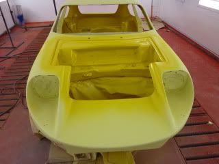

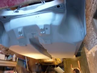

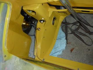

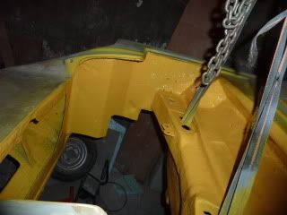

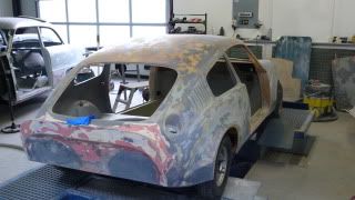

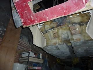

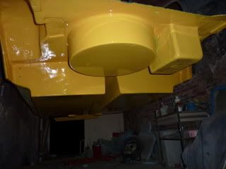

Hello,

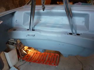

After a lot of sanding and working with the steel brush on my front subframe I was called that the cage was fully welded! And I have some pictures of it.
@ Allan I think I go for the Raid HP removable steering device. I was thinking about your idea of building the cage out into the front subframe, but because of the cost of the cage I let it be for what it is. But thanks for the tip!
Front above
Back above
I update when I have sprayed the front subframe and cage.
Cheers
Last modified November 8th, 2008, 21:52:04 by Joost van Dien

Syd Crawford
Posted on: November 8th, 2008, 21:00:46 Quote Report to Moderator
Posts: 252
Looks good Joost. Nice and strong
Private Message Reply: 25 - 45

Rodger Howard
Posted on: November 14th, 2008, 08:52:16 Quote Report to Moderator
Medium Member
Location: Melbourne Australia
Posts: 162

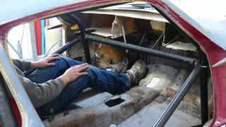

What is the cage resting on to stop it pushing through the floor in the event of an accident?
Private Message Reply: 28 - 45

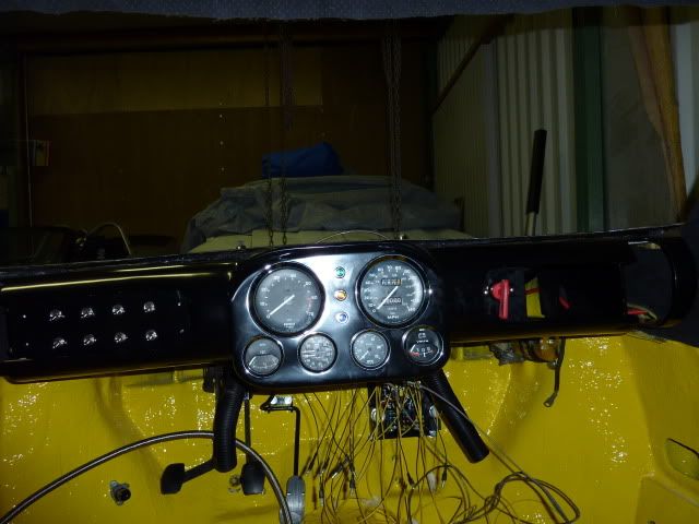

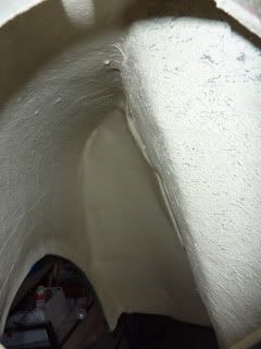

A new update! After a lot!!! of time! This is because of school and work.. I work 5 days for school and 2 days in the weekend so not much time.. But bit by bit there are lots of things done on the mm sometimes you can not see them directly..

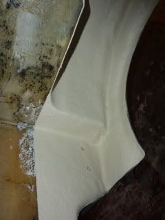

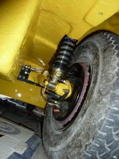

I wanted to do the underside first. Because then I could put the rear beam and front subframe with wheels under the car and sand the car on a normal height! So after 2 weeks of working on my back under the car! Sanding fiberglassing and more sanding and sanding.. It was finally ready for the structure couting for the inner wheel arches. There was so much fiberglass work done on them that it was not always the best vieuw under the car so with a bit structure coat it was much better. Then I sprayed it with 2k grey epoxy couting to seal it of from water.

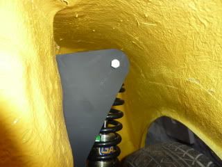

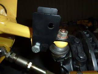

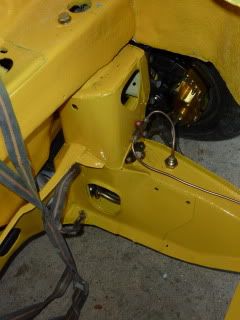

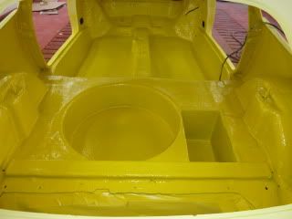

The front plates were you can mound the shocks are reinforced with steel welded plates. At the outside there is a 3mm thick plate made to fit. I have drilled 2 extra holes at each side. Because all the weight will be on these point now.. It is only the body with all the stuff in but it is still not bad to reinforce!

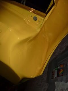

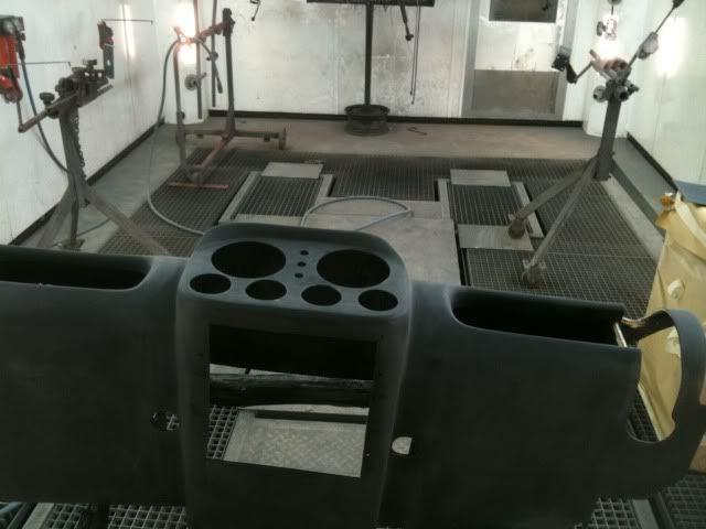

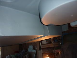

Wheel arches before spraying so you can see it was straight before spraying and no filler!

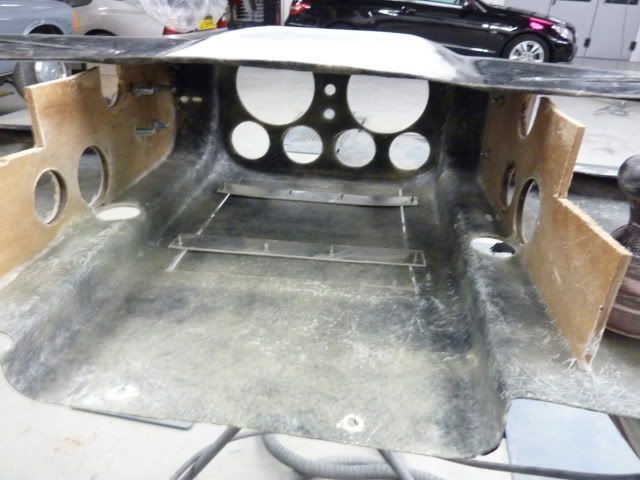

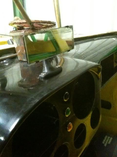

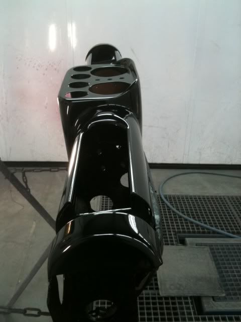

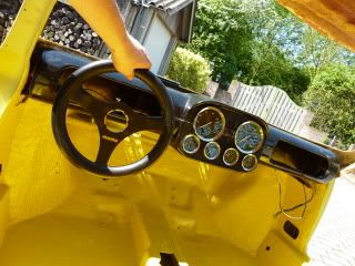

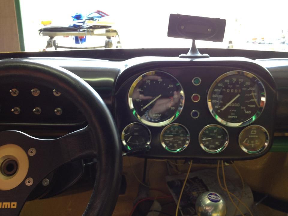

I remade the dashboard as it was grinded away by someone who was not capable of having a mm. I did this with a flat plate under the old piece and fiberglassed over the old pieces that were left. Result:
I also have made some changes to the engine. Polished the LCB so it can get nice blue shinny:
Front and rear suspension before fitting:

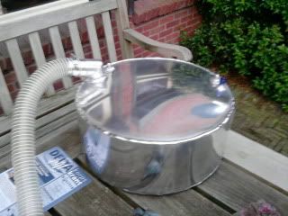

It costed me 2 days to polish but the result of the fuel tank:
Fitted front and rear suspension:
It took a long time but now a big update!

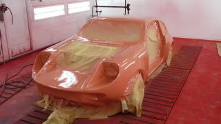

Posted on: May 26th, 2010, 10:33:47 Quote Report to Moderator
Posts: 293

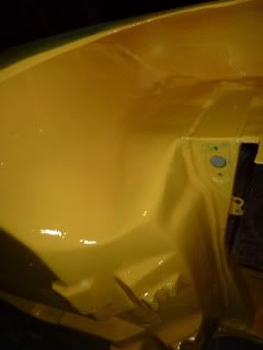

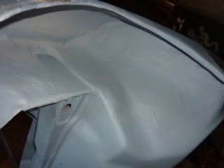

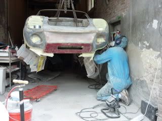

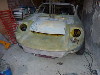

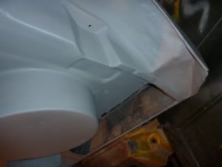

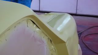

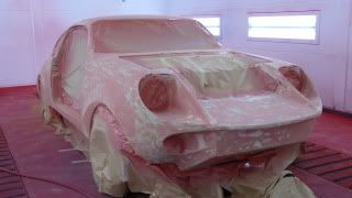

Hello,

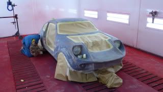

Its a long time ago.. I was very busy with school and work.. But the car has transformed as well!!

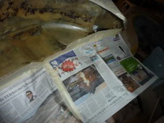

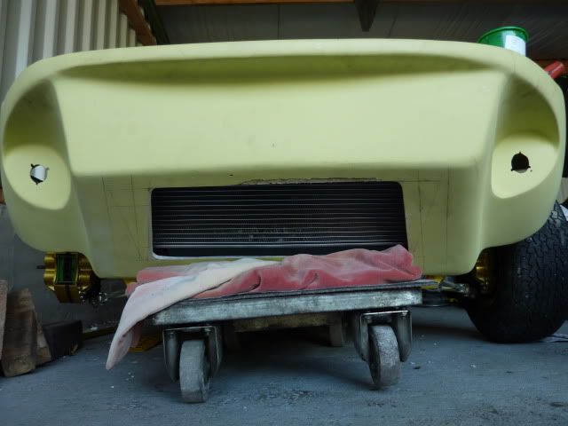

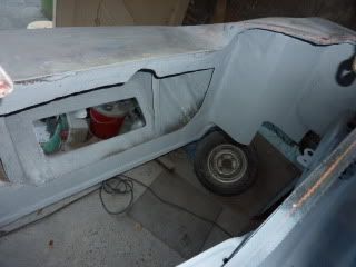

Sanding and sanding..
spray cabine
first 3 layers of 2k epoxy
next day sanding it a bit back and fill up all the pin holes.
Then 3, 4 or 5 layers of spray filler in different colour, so you can see were you are with sanding and flatting out.

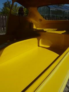

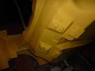

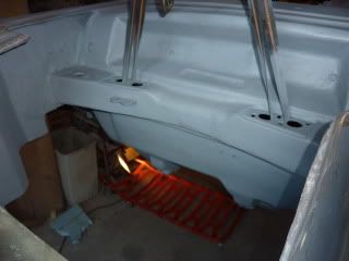

Inside and engine bay spray
First epoxy and then paint.

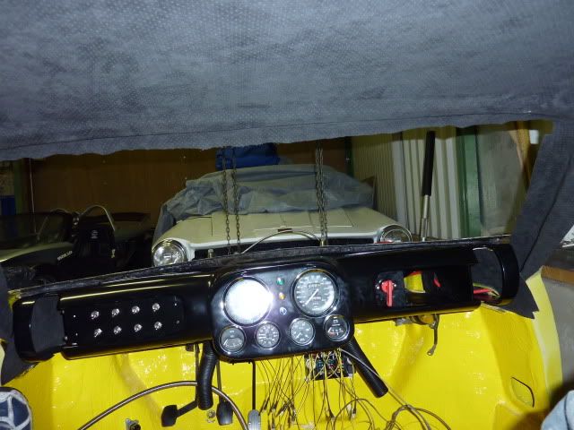

With dashboard

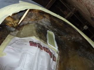

Covering plate for the old fuel tank hole.
It was lots and lots of hard work, but I think its worth it!

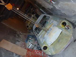

It has been far to long ago... Now there are updates!
Thanks for all the advice, help and good compliments!
@ Garry, This is far to long ago... But I've checked the spring rate. At the back it is 120 lb's. Front I cannot find.
@ Peter, I am so addicted to the car and colour.. I thought to spray my arm the very same yellow! In fact it is a sort of marcos tattoo  .

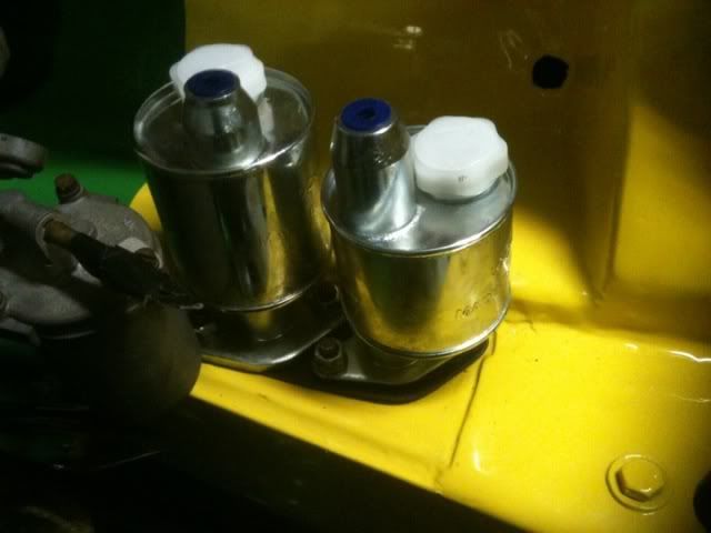

The car! The last pictures were from the spray and a few small other bits. In more than a year there has been quite some new stuff. The engine bay now has a green stripe (same as engine and cage). By the rear and of the cage is fitted and only needs to bolt it through the body. The fuel tank is lying under the cage and fits perfect now. It wass quite a job to get the rear van lights good in possition.. Measuring measuring etc etc.. Then drill the holes and file the to the right size. The radiator is a very think aluminium version of a golf 3, because the in and outlet are on the same side and a good cooling capacity. The radiator hangs in home made brackets with rubber shocks (with thanks to G-J!)
The next step was to put the engine in. The engine was lifted up and the car was pushed under. It was tricky to get it in without damaging the engine bay. But it did go well. In a few hours I had the drive shafts and engine mounts in place. The job of dressing up the engine was begon. An oil cooler with thermostate switch was added. This only fits just, and sits in a quite unusual place I think.. There was just not enough room elsewere without chopping some big holes in the car. The pedal box, clutch and brake master were put in place. Now it was time to do something with the dashboard.. To get the dashboard to fit with the front section of the cage, some holes needed to be cut. And this is not a German car so measuring was not quite an option. After the cutting I wanted to strengthen the dash by laminating some wood panels in. This worked very well and made the das a stiffer. Then it was time to spray it, sprayed with a layer of 2k epoxy to get a good bond, afer that a lot of layers spray filler. After sanding I finished it with 2k semi gloss black (ral 9005, ~70% gloss). The window vents come from a MG B and fits perfect. All the room in the middle was used for gauges so I needed a new spot for the switches. This was done by putting an aluminium panel in place.
The fuel pump was next. Because the fuel pump is at the back of my seat and I didn't want to be covered in fuel when it would be leaking (you never know). So I bought an aluminium casing were I carefully made a hole in it and put a yellow piece of persplex in it  . The fuel pump is now in the casing standing on rubber shocks. The fuel line is in place. I made some side windows but didn't want to use the original push down system.. So I bougth a sliding kit and made a hole in the window. It fits very good and works well. The wiring loom had to be made.. (still working on this one). I bougth a ready to use panel with all the fuses and relays already on it. (not that far so will update about this later on this year). Also made a 3rd brake light, mounted on the cage. Made an alloy bracket to support it (this was when it was christmas and your not allowed to do anything but socialize... sneaked to the garage  ). I will post some pictures.
If anyone has questions or wants photos.. just ask here or email me!

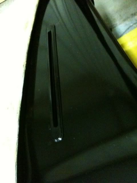

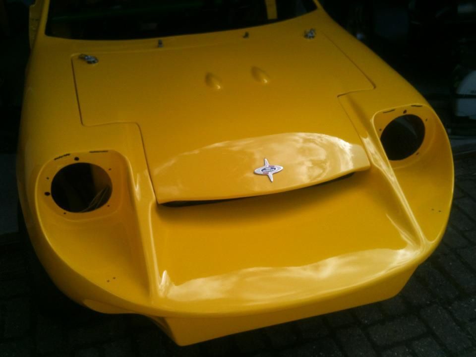

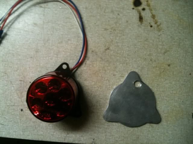

Hi all,
Ak; Welcome to the forum. (haven't been online since a long time). Yes the dashboard is a new item. Rae Davis has the mould for it and can supply you one. But beware, the man is ghost. I ordered a dashboard for a mate about 10 months ago. The was going to make 2 dashboards and I haven't heard from him since. So I try to contact hem from time to time, via email and phone, but nothing. This was the same with my dashboard. Took me 5 months to get it here. So eventually you will have a dashboard but it will take time. His website is: http://www.raedavisracing.com/
Try to ring him on both numbers 5 times a day and send him a few emails. I hope you can contact him! Good luck!

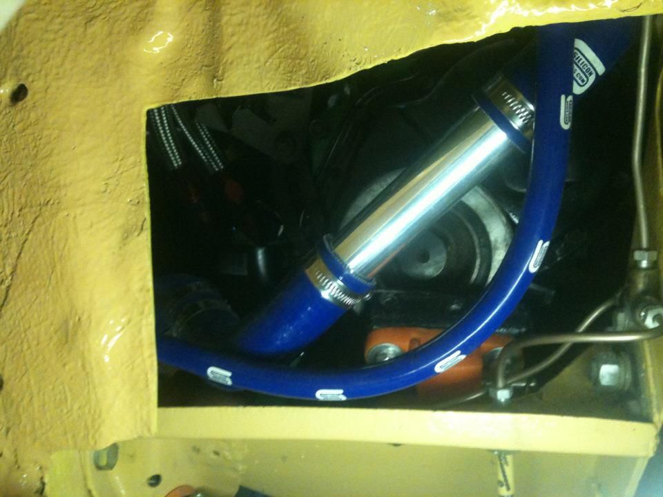

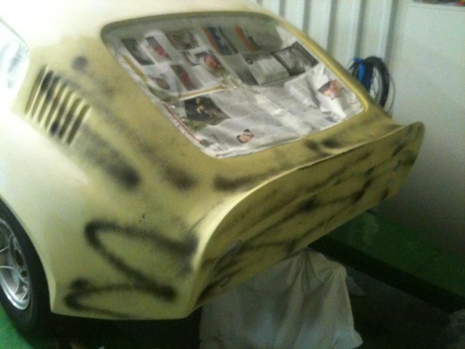

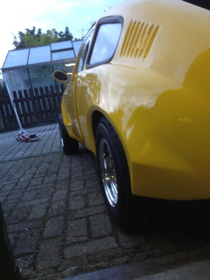

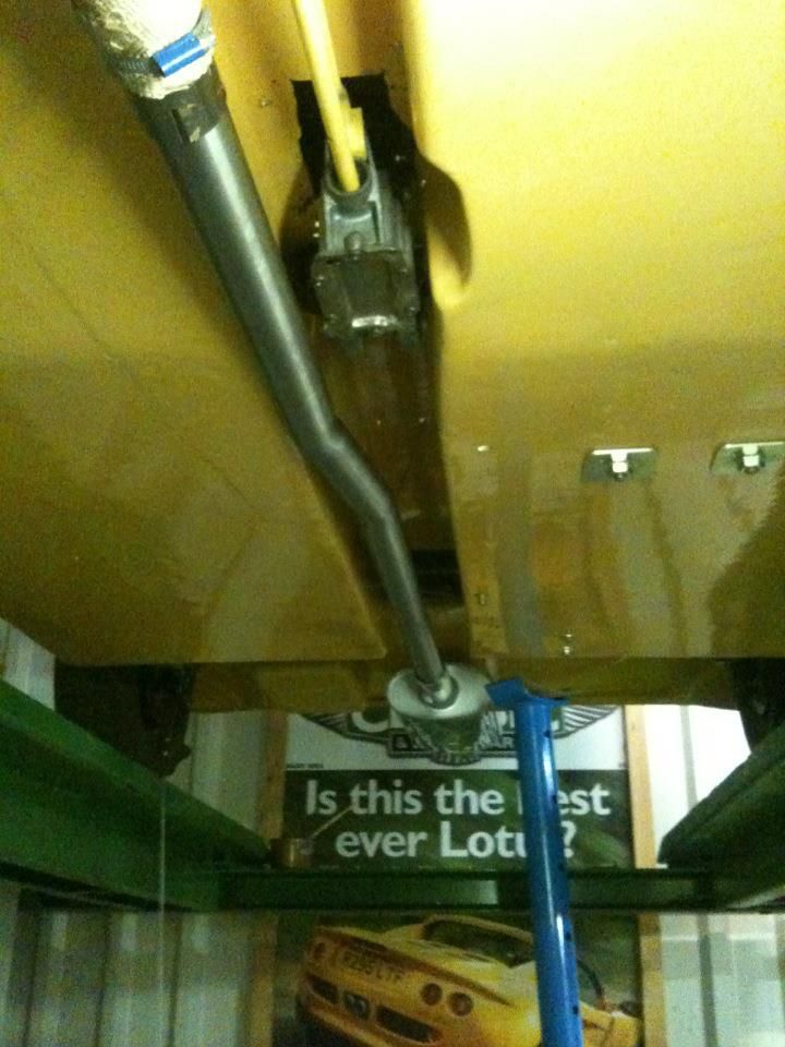

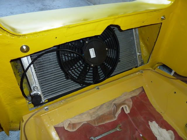

It has been a will since I last updated this tread. I am very very busy with school. Went back to school after a year of work. Now learning for mechanical engineering. This is the reason my cars are a bit behind and the thread as well.. Some of you can sometimes see an update on facebook. But now there will be an update, at last!!

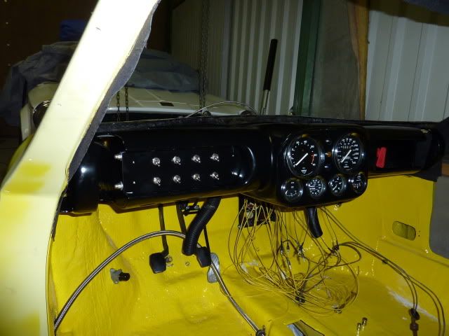

The last updates are more about interior and engine. Done all the electrics on the car. Was an absolute pain in the donkey... But its now working all with 2 small things to fix. The engine has all the coolant hoses in place. Same for the oil cooler hoses. Mounting the engine was a bit of a problem. I didn't want to use the top engine steady (thermostat housing to bulkhead). It is a big lumpy thing and not pretty. I went for the Kad top and gearbox steady's. So no need for the thermostat engine steady. But when you have a Kad engine steady it's not nice to use the standard fixing brackets on the bulkhead and engine. So I made them myself out of alloy. Takes some time but then you have something to look at. Exhaust was another bit to get sorted. Since the marcos mk1/2/3 is a bit longer than a saloon and smaller than an estate, you cannot by an exhaust off the shelf. With the maniflow lm004ss installed and the playmini damper on the back I could measure the link pipe. Went to a small company in Belgium that makes exhausts. The man made me a link pipe and it fits perfect. No need to weld or grind with this one...

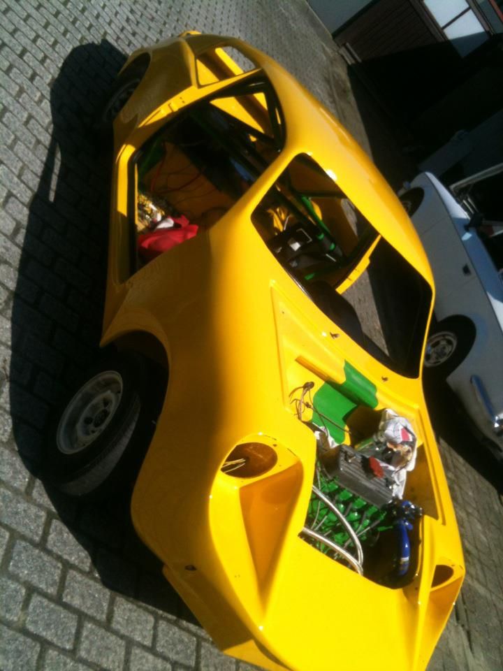

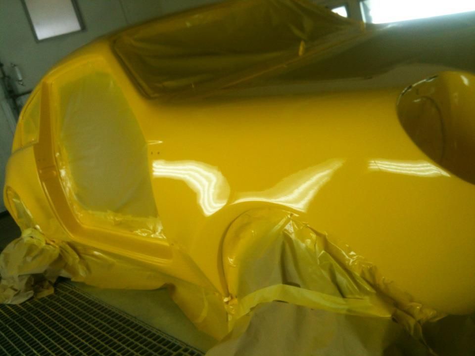

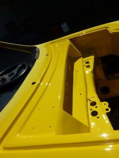

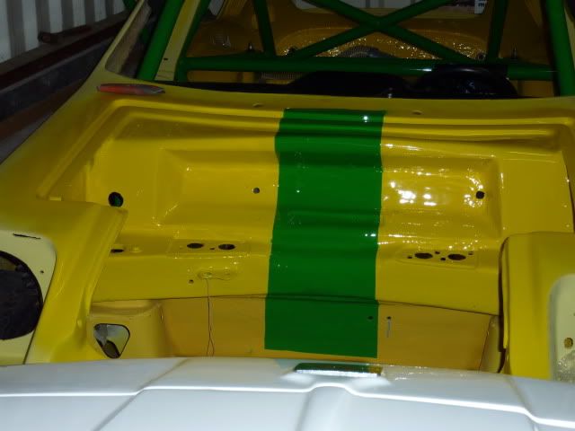

Well for the people don't know, it has been sprayed!  . It was still in the spray filler so I needed to sand it down first. Bought myself a mirka electric sander and began with the dusty job of sanding and flattening out a few areas. Sanding it with grid 320 on the machine. After that grid 500 by hand. Took another 2 days to get it right. Constant looking with a flash light to be sure there were no coarse marks of the 320.
After that it was time for spraying. Well, not really spraying but prepare for it. Took me around half a day to mask of the car. At this point you realize the marcos has some really funny angles. With the masking done I could degrease the car. Degreased it 2 times with oil based degreaser and 2 times with a water based to get any sweat marks off. Time to spray! I sprayed the whole car myself except for the very last layer. After that it was time to wait a few days and pick the car up.
I waited weeks before working on the car. I wanted the paint to be really dried. It was time to fix the small bits. The windows, doors, headlamps etc could go in.
I think I have written enough for now . Pictures tell the rest. I have more pictures so if anybody wants a close up, send me an email.

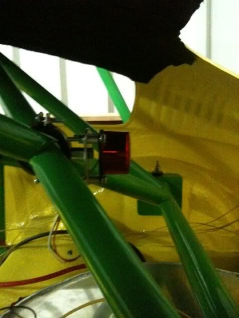

Before the last cables were fixed
Interior by now
Coolant hoses
Another one, take in the wheel arch

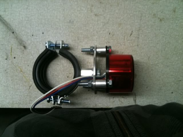

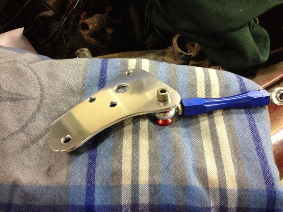

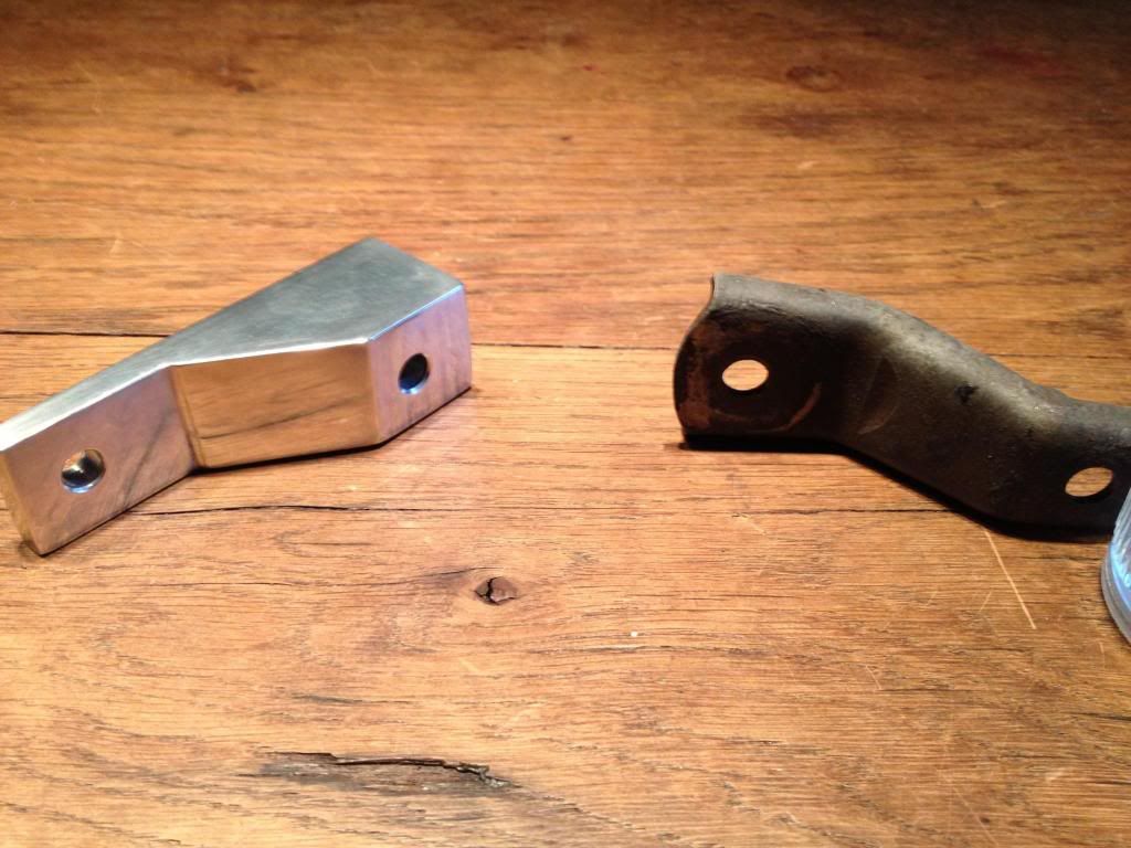

Kad top steady with alloy bracket
Other side of the bracket
Oil cooler bracket
Exhaust system

Sanding starts
Preparing
After the last layer

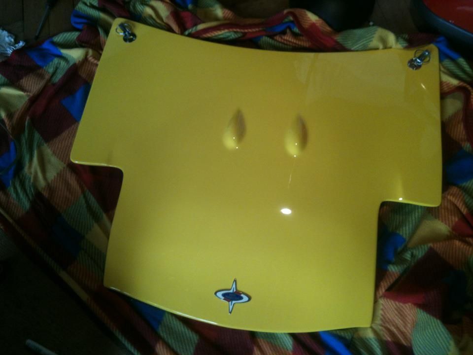

Bonnet

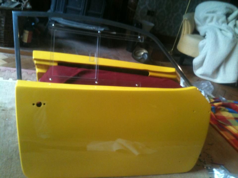

The doors

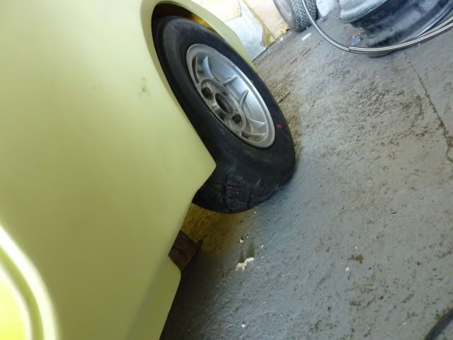

The MB's with Kad 4 pot. At last a wheel that has good clearance
