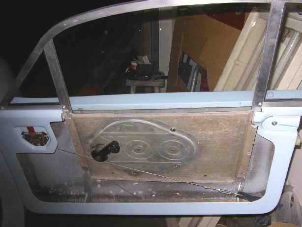

You could always fit the Mini window winder mechanism Like Tertius did.

Tertius van Zyl
Posted on: October 11th, 2008, 18:44:16
Quote Report to Moderator
Posts: 289
Reputation: -1 (tot: -1)
Saw my name mentioned Patrick. This is the way I handled the problem using the Mini Clubman donor car winder mechanism. I made up a fibreglass panel to hold the Mini mechanism. Door cover panel not in place. Works a treat.
