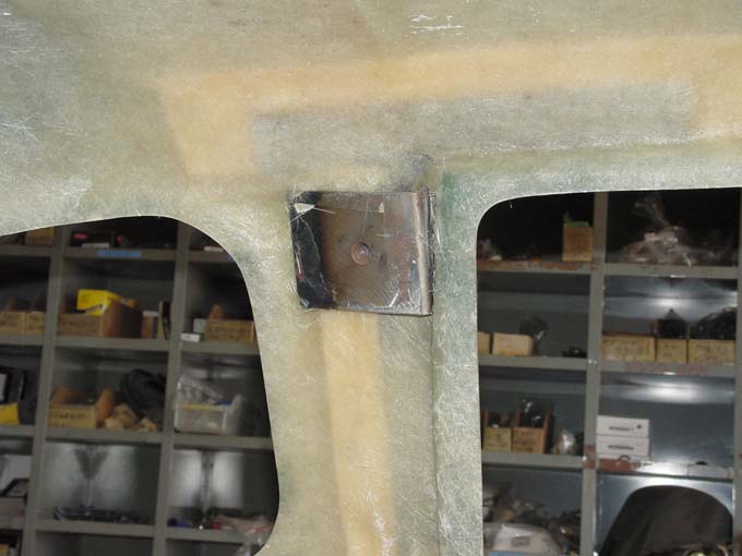

Here is a pic of the upper belt anchorage point on a MkVI shell, This might not be possible with your car as it is a MKIII and has a much narrower B pillar.

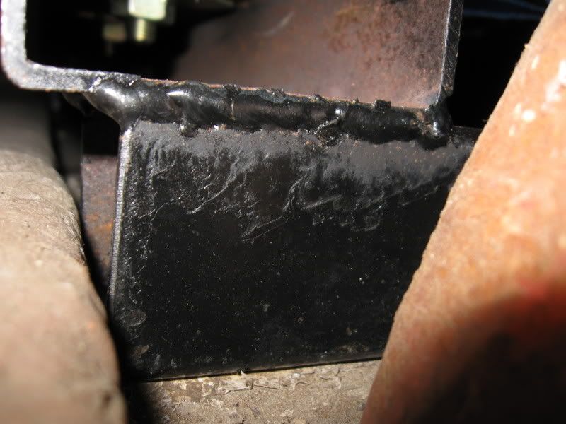

Here are the lower anchor points,

Whatever type you go for, make sure that you use spreader plates on the outside of the shell to give extra security, these can be glassed over if needs be.

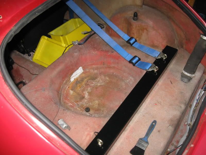

For anchoring my harnesses, I put in a bar across the top of the rear subframe mounts, Its raised up slightly and I have eye bolts attached to it. I'll get a pic up later on this evening for you.

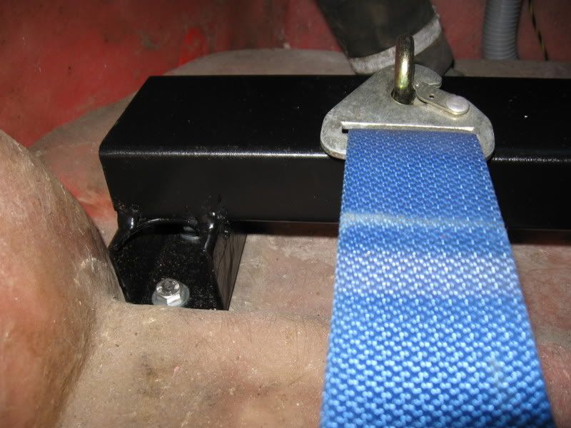

Sorry for the late reply Patrick, but here is what I am doing for my belts,
The cross bar is raised slightly, this is to allow access to the tank mount bolts and also to give a little extra room for the spare wheel, (12"),
The bar is fixed using the original rear subframe mount bolts.
