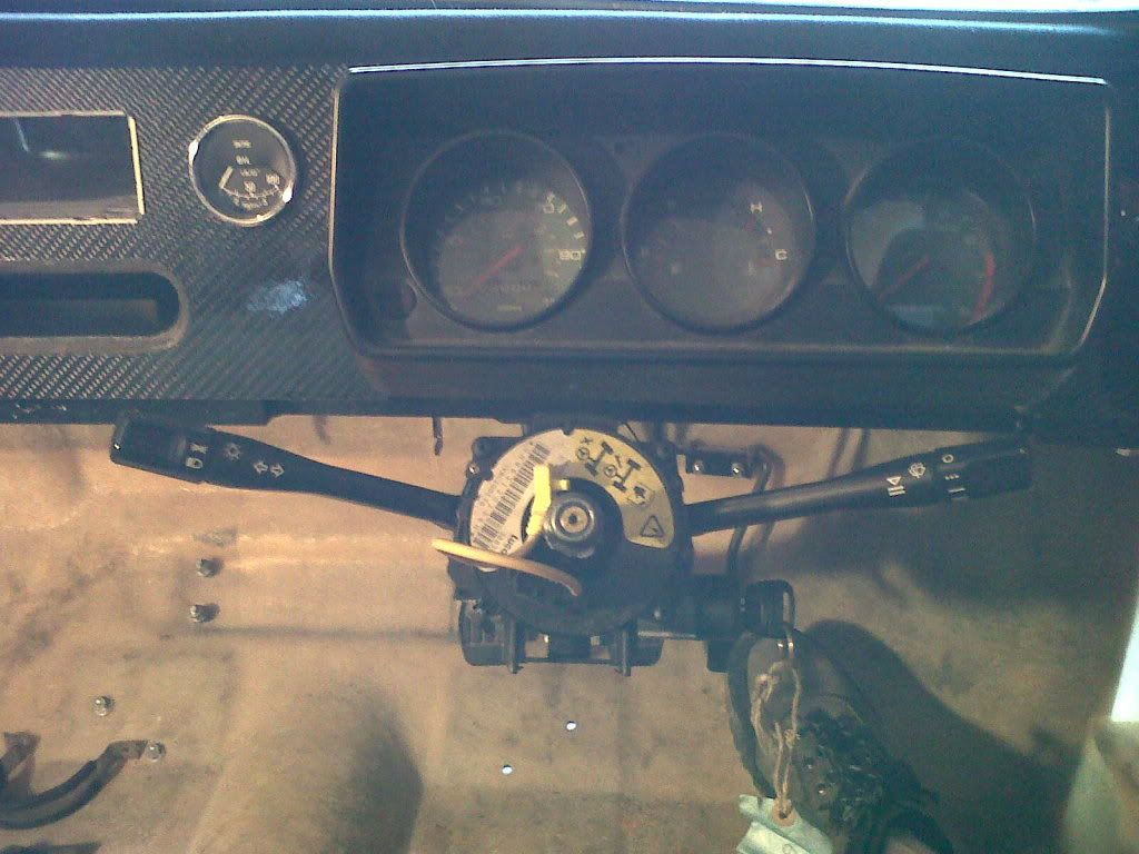

Then I decided to take the steering column off to give me more room to manouvre underneath - that took some doing, it obviously hasn't been off for a good while, but eventually it gave in and I couldn't resist quickly fitting the MPi one in:
I didn't notice it at the time, but in the picture the column looks quite noticeably offset to the left (more so than in a mini) - is this the norm?  In the picture the column isn't clamped up (to the dash rail mount), just positioned on the spline.  I don't fancy forcing the column over - won't that just stress the spline and increase the steering effort/wear?

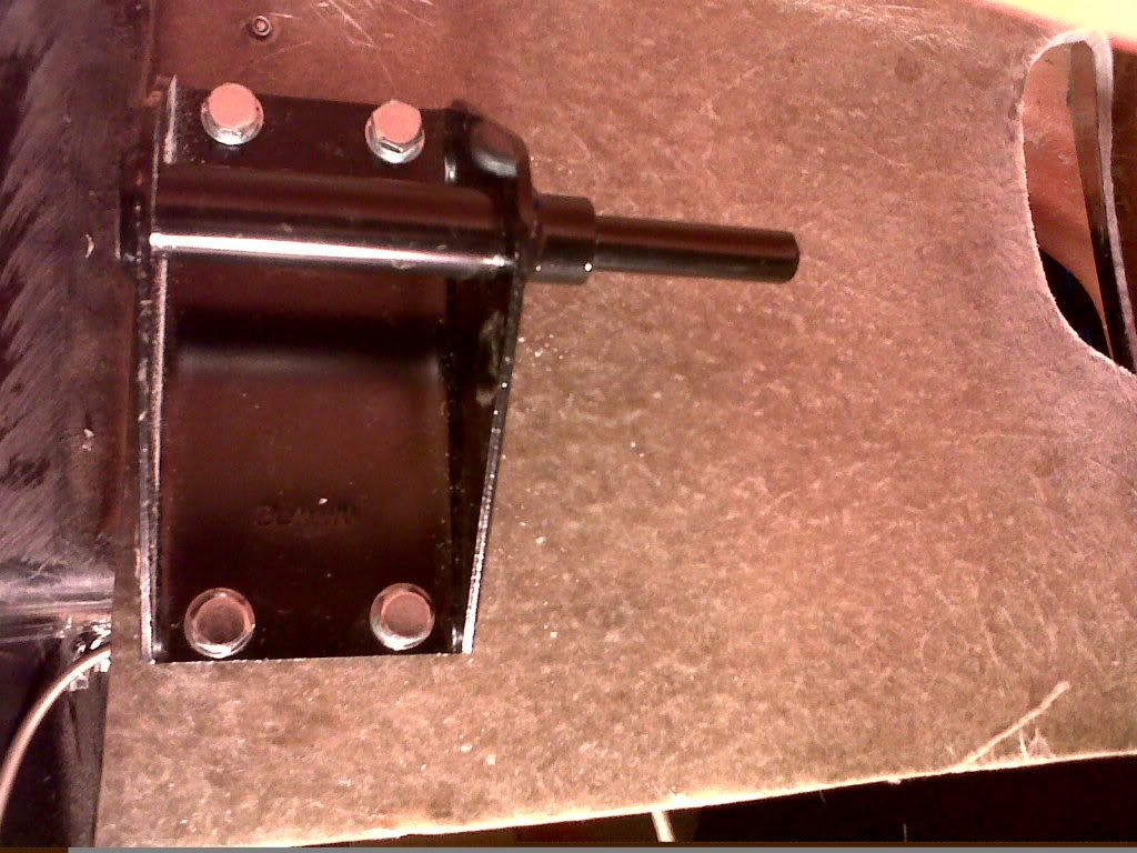

So at least I've been able to do something today - put the RHF top damper mount on:

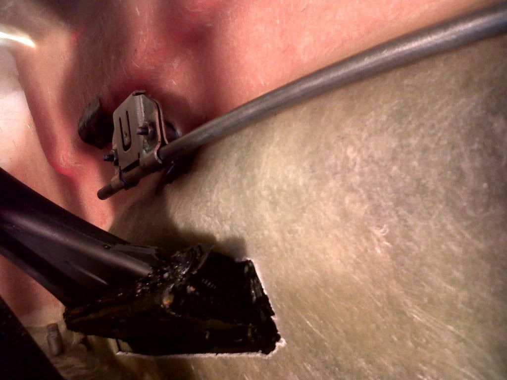

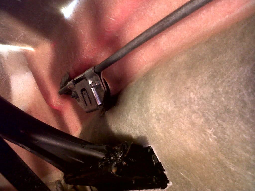

Anyway, I offered up the wiper mech to the holes in the scuttle with the wheel boxes either way round.  This looks the best way to me:
as opposed to this, which would require a lot more cutting I think:
Does this seem right?  I have found out that the early mini's had smaller wheel boxes - don't think I can wait to find some of them though!

Hello, no great knack to removing the screen. Mine was in and out like a fiddler's elbow! I just pull out the filler strip, spray some diluted washing up liquid around the edge. Then using a filler strip inserting tool I gently lift the rubber in one corner and push that corner from the inside. Once it starts to come out it's very quick and easy. I expect you can use a screwdriver, the insertion tool has rounder edges.
