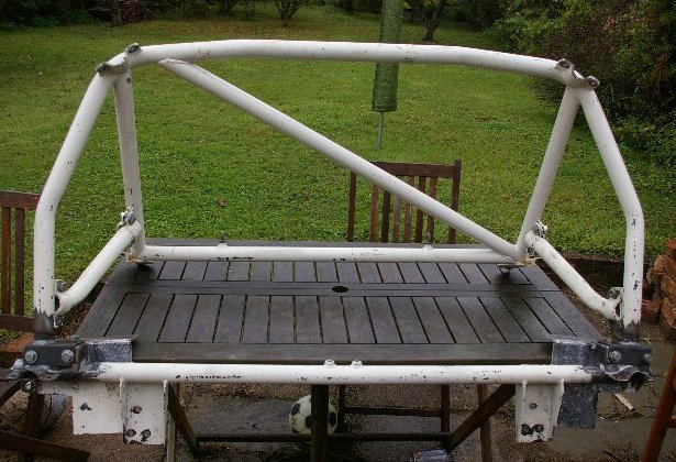

Interesting because I was wondering about an efficient way to fit a rollcage in a marcos...
To get it clearer, is it possible to have some pictures of your roll cage and the mounting plates?

The cage is back out of the car awaiting painting at the moment, but I can take some photo's of it in that state. It might even be clearer!
I'm not saying mine is the best way of doing it BTW, but I am now happy enough with it.

Posts: 13
Even it is not with the final painting, it could be interesting to see it... If you have time to take some pictures, it will be great.

Sorry can't work out how to attach more than 1 picture to a message so it's going to have to be lot's
To start this is the cross beam

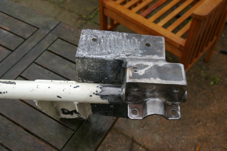

jimnaylor
Posted on: August 26th, 2011, 13:32:31
Quote Report to Moderator
Location: Bedfordshire
Posts: 222
Attached to the rear cage - the attachment has just been changed to a more conventional foot, it was a plate in shear before which I was not totally happy with.

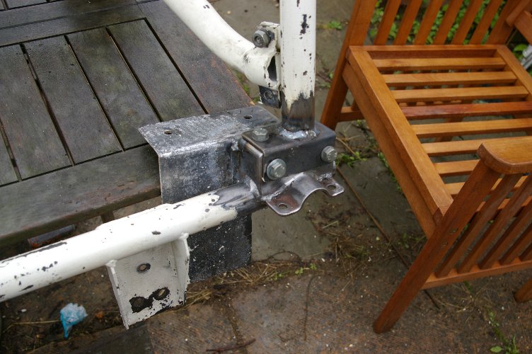

jimnaylor
Posted on: August 26th, 2011, 13:34:47
Posts: 222
Detail of the top of the attachment the two bolts go into the reinforced section of the shell infront of the wheel arch and above the sub frame.

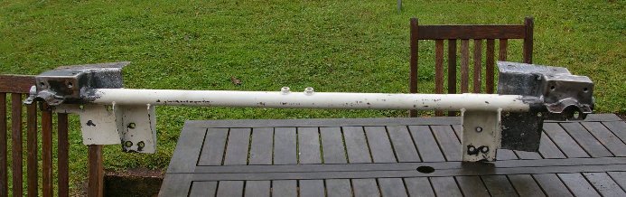

jimnaylor
Posted on: August 26th, 2011, 13:37:37
Posts: 222
The front of the attachment. The bolt hole on the right is to the top subframe bolt. The two in the middle into the reinforced upstand. The three on the left pick up on anchorages on my rear beam axle.

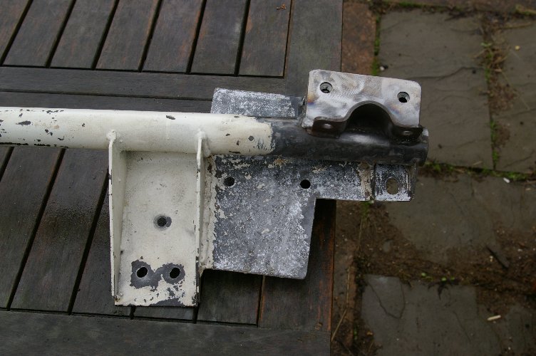

jimnaylor
Posted on: August 26th, 2011, 13:39:28
Posts: 222
The main hoop attachment.

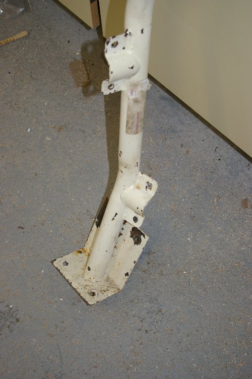

jimnaylor
Posted on: August 26th, 2011, 13:42:37
Posts: 222
My old front leg. The MSA don't like the lower bend so I've had to change it, but I always thought that if it did bend there in a roll it would transfer the load into the sill which is stronger than the floor.... still I had 19 years of use out of it.
