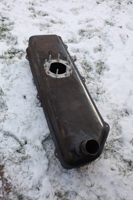

What fuel pump have you used? Where have you mounted it? What pressure does it run at - 3 bar?  How did you fit the fuel return to the tank (van tank yes)?  Have you a charcoal cannister fitted?
Are you using the SC Typhoon ecu? How easy is it to map?
Questions, questions!!!
Private Message Reply: 12 - 20
Matthew Payne
Posted on: December 19th, 2011, 22:03:41 Quote Report to Moderator
Medium Member
Location: Bawdeswell, Norfolk
Posts: 105
It looks good!
Mk3 MR2 fuel pump (same as Celica) with a built in regulator - One fuel line only so no return. It's a little deep, so an extra box has been welded to the base of the tank. It's higher than the exhaust, so should still be okay
Pump mounts through a hole in the top. The pump has a built in swirl pot which should improve on my 'surge prone' Clubman Estate MPI I had. The pump was then surrounded in fuel foam too...
I haven't used a charcoal canister either. The pump did have a 'let-off' for an extra line to a charcoal canister, but I plumbed this back to the fuel inlet. Oh, and fitted a vented cap... Not very IVA!
