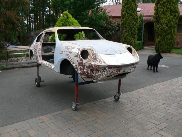

Thought I'd share my Marcos frustrations of today
I'm working on the door frames of the bodyshell, removing as much of the old paint as I can; but it's slow going with all the little corners and steps to sand back. The passenger side had a large hollow area about 6" long in the upper section below the edge of the roof where the fibreglass was exposed, as well as several cracks in the gelcoat along the bottom sill section. The driver's side door, had once been hit by another car so I wasn't surprised to find cracked and missing gelcoat around the frame area as well as a few cracks right through the fibreglass near the lower hinge and door latch areas. I was, however, surprised to find how thin and flexible the fibreglass was where the latch hardware mounts and the adjacent flange. Because the flange was cracked right through here, I've substantially reinforced that whole area with a double layer of 600g matting to effectively almost double its thickness.
Lots of filling and sand sanding to go before I'll be satisfied with this area and move on the rear quarters.
Lower hinge area of driver's door frame
Cracked latch mounting area and very thin flange
Reinforced flange and area behind latch mounting area
Steve (MM 7056) Downunder

The build is slowly progressing and at a stage now where I'm happy to leave the shell to age in its new coat of grey primer whilst I tackle the doors which are in serious need of repair. At some stage the driver's door has been damaged and some fairly agricultural repairs made. The passenger door has metal embedded in the fibreglass where the hinges mount - is this normal, because there aren't any metal plates in the driver's door - which could be because of the repair ? The aluminium window frames are severely corroded, but salvageable. The oval-shaped pocket into which the door handle sits is broken on both doors, allowing the handle to slip too far inwards - that's going to be a fiddly repair and I'd be grateful if somebody could post a picture of what the inside of the handle pocket is meant to look like
I would love to have seen how the moulds of these cars were constructed and how the cars were put together. The more I worked on the body shell the more, shall we say 'creative' aspects I came across. I've mentioned previously about the different sized and shaped internal sill panels and of course the skewed rear panel, but now I find that the vertical front panel (where the numberplate usually fits) has a different angled taper at either end, has anybody else noticed this?
Here's some shots following today's session.
