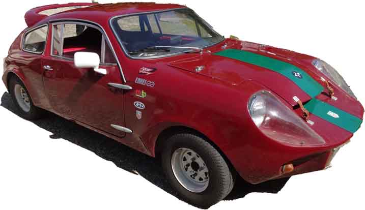

I just bought a mini marcos MkIII from 1968, number 7184
The mini based is a BMC Saloon from 1972 (thanks Richard for information).
I hope learn more informations on Mini Marcos, my target is to do some modification regarding suspensions, brakes... to drive it in regularity rallye.
I will restore the body too. Delete the rear fin to have the genuine body shape...
Color not choose for moment, I am looking for mini color on 1968.
See you on forum or french roads.
Herve

Thanks,
for the moment, I have no specific questions, I read diffirent forum, more mini at this time to see all what is done on suspension....
After, I will see whith what I will start. One of my disapointed is the engine, it is a 12A2B so not from 1968. No important for that time, perhaps I change it in the future.
My idea is to put disk brake, tie bar rod adjustable, HI LO kit, new cones.... to have a better feeling on road. After, make a new interior. I will keep the seats but change carpet, dashboard & steering wheel.
