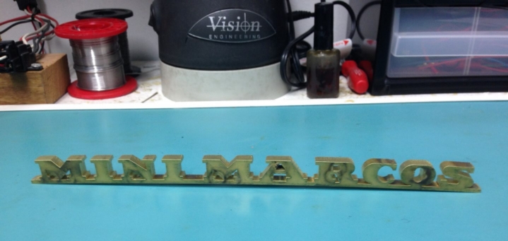

i'm just finishing off the finer details of my car

Looks good! I tweaked the pic a little to get it all on my screen.

Thanks for sorting the picture. I will mill down the letters to leave a raised line below them then polish before chroming.

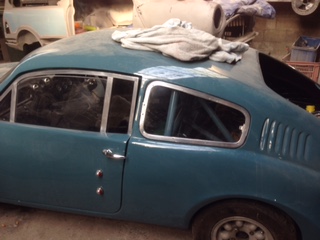

I've been saying this for a number of years now but i think i can actually see the end of my mm project.
The trim was done late last year and over the past few weeks all of the glass and perspex has been fitted and the aluminium parts polished and clear coated. This week the paint will be polished and touched up where necessary ready for the last mechanical items to be fitted.

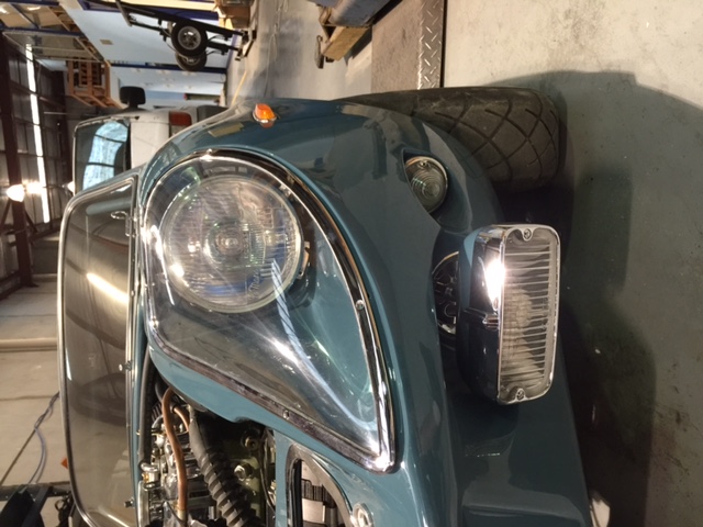

Have i done justice to the front corner of a lemans style mk3?
I've used ferrari teardrop side indicators
Kept the wheels under the original shape guards
Lemans lucas lens with h4 innards and low beam globes included
Custom steel covers and lens made from scratch
Frenched in the ferrari indicators
Air vents for the brakes turned in aluminium behind the original cibie spots mounted on removable plynths

The restoration journey consists of many small steps, your attention to detail and customisation has extended that journey well beyond what many, including myself, would be satisfied with. It's a credit to your vision and persistence, just a shame you missed the Classic LeMans anniversary.
