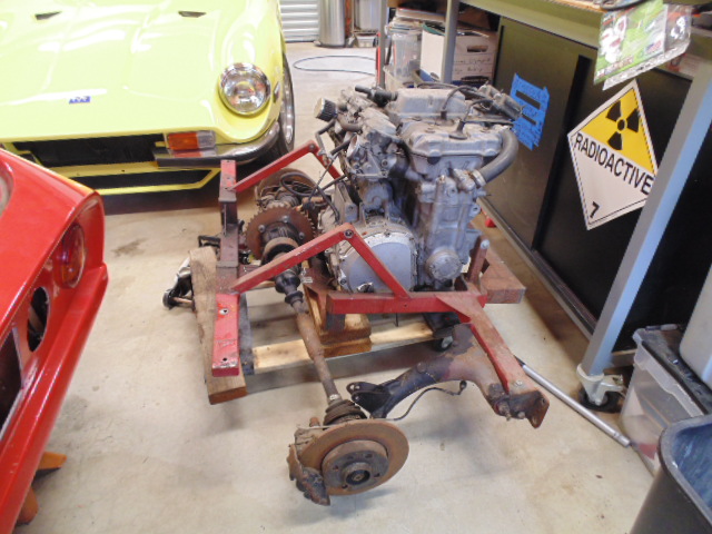

So my youngest son and I started the removal of the mid engine Honda motorcycle engine and subframe.
The car was unusable in this set-up.
Toooooooo   llllloooouuuddddd....
Danger Danger no rear vision with me sitting on the wrong side for us roads.
The fire wall made rear vision only possible thru tiny windows and tiny mirrors....
Massive oil leak from the Honda.
Last the chain broke while driving about 75 mph on the freeway could have been a very bad scene.
Anyway it's out and being sold to a local guy to build a race mini.
I need to start gathering parts now.

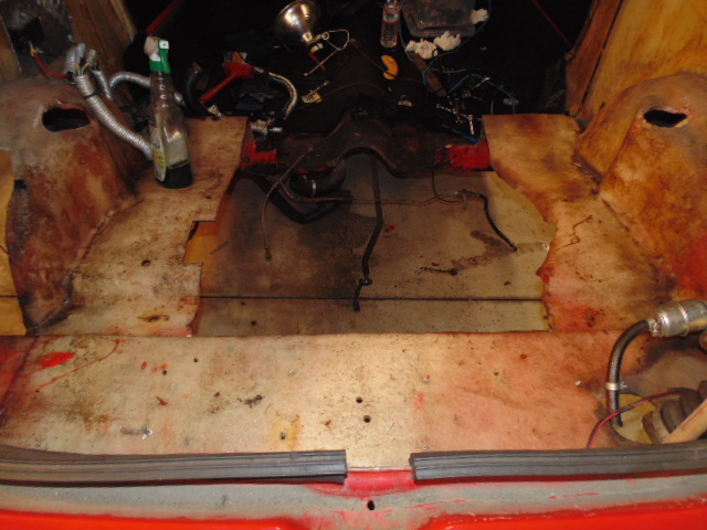

Need to repair the hole in the back of the chassis.
Has anyone used metal as reinforcements to the shell?
I would like to add a roll bar and incorporate the mounts into reinforcing the chassis and
suspension pick up points.

Hi here's some pictures of the hole.
regards
Robin

Hello
One idea was to make a form from the underside that spans across the flat floor.
I think i would make it flat as forming a battery box and wheel well might exceed my FG skillls.
I thought about building a tower brace with tabs for the shock tops and
also plates for the roll bar to kick too.
I also thought about attached steel or aluminum z-bars that went the full width of the opening at say
10" on center.  i would attach with small bolts and then glass them it.  this would make this area super strong.
I also thought about glassing it flat and then cover the back with a 1/8" aluminum plate in the shape of the flat area.
this might be a much.
I am worried as the unibody is dependent on the entire structure being rigid.  the twisting forces of the suspension will find the weakest areas and start to crack.....
Anyway I will practice on fenders holes and start making up the form for the bottom.
Robin

A flat former (mould) would work fine if your worried about strength add layers or add foam ribs (check they don't melt with resin) and glass over them. Whilst the battery box and spare wheel well add strength in the way of shape foam ribs would work well. A tower brace is never going to be a bad thing.
Nice car by the way.

Well here's the frame out.
Robin

As for the rear mini subframe vs beam setup, it would seem like the standard subframe would work around any structural issues created by the big hole in the floor? It looks like all four standard subframe attachment points are intact. Though the damper attachment points are going to need some work.
As for metal reinforcements under the fiberglass, I believe all the cars have that in some form or other. My MK6 had metal plates moulded into the door hinge areas, the front crossmember, the seat belt mounting spots, and a few others.
I've been having some fiberglass work done at a local corvette restoration place, and he stiffened up my hood with some balsa wood glassed in.
