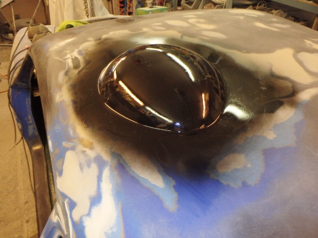

Let me present the car, it is  serial 7012 previous owned by Dennis until September 2013 when he sold it to us. By us I mean two school kids with a common dream of racing together. Well we have been out of school for 40 years now so it is time to realize our project!
My friend is Henrik Kjaer 61 and he has been at all Le Mans since 1972
and myself Joergen Rasmussen 62 and a little less Le Mans visits.
Dennis did dismantle the whole car into pieces as you properly have seen earlier and also started rebuilding the fibreglass but realized he didn't had the time to finish the project so he sold it.
So what are we going to do with it? The plan is to make a number 50 replica and race it. Obviously it has to be "a sort of" replica as it is a mk3 not mk1
Most of the fibreglass work is now finished with a Gurney bubble. Henrik is 1.94m so the car is a bit tight for him but with the floor is lowered and a bubble? Lets wait and see.
I have heaps of photos for later use where I will try to describe the work further.
Then a question. Did all 50 cars from homologation certificate go racing or was it only a few?
Best regards Joergen

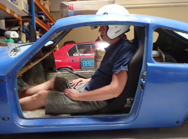

As you can see in the previous picture a 1m94 person is a challenge in a Mini Marcos! We have handled this by lowering the floor by 5 cm in the back end of the seat. This gives the 5 cm of course but also a few cm from leaning back. This gives room for daily use but for racing with a helmet we also added a Guerny Bubble.

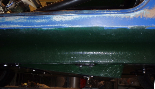

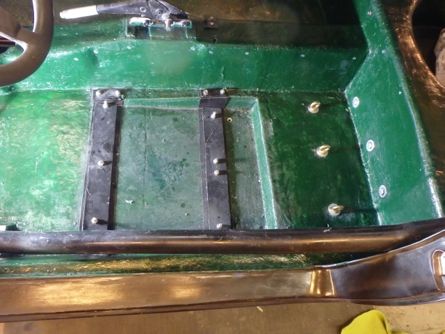

A few photos showing modification to the bottom with seat reinforcements and eyebolts for harness.

and
