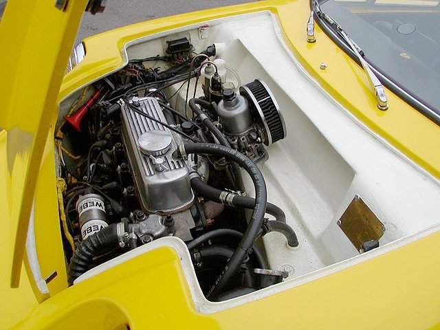

My understanding is that the MM engine bay is nominally similar to that of the standard Mini. So if you go with a process that will fit on a mini, then it may fit on the MM.
A few places that may be different: I suspect that the bonnet height is a bit lower. So you may be putting a bonnet bump in. Also, as in stuart's picture, he has some space behind the cross member for his air cleaner -- my mk6 didn't have that cut out, and i had to do a hole in the firewall to get an air cleaner in there. Granted, I also had a weber 45 with a taller air cleaner.
Also, note that the inner wings and the front panel would be easy to cut out. So you may be able to get a touch more room there.
If I were doing a conversion like that, I'd probably look at making the car into a removable nose, for access. However, you do lose a bit of structural soundness.
And as for the honda conversion...it's a very light car, and a lot of power. Even in the stock minis that have done that conversion, it's quite common for a person to finish the conversion, drive it for 6 months, and then decide that it's undriveable, and sell it at a large loss. I'd probably look hard at least at doing an AWD conversion at the same time; add a bit of weight to the rear, and divide the power out a little bit.
