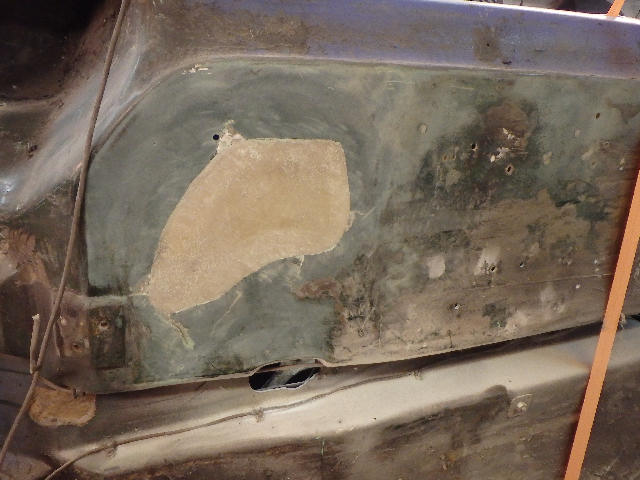

I think 7012 could easily have looked nice when it was acquired for Stoneleigh. Still only few holes in the outer skin but a lot of holes in the bottom. At a point I thought it was a test bed for a seat manufacturer!
In the photo there is a nicely repaired very big hole in the passenger side and that's why I think 7012 must have been in a ditch or so.

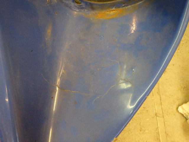

I think this photo also point in contact with a ditch or so! Filler, sanding and paint job was nicely done but fiberglass repair inside wing was mainly chicken wire.

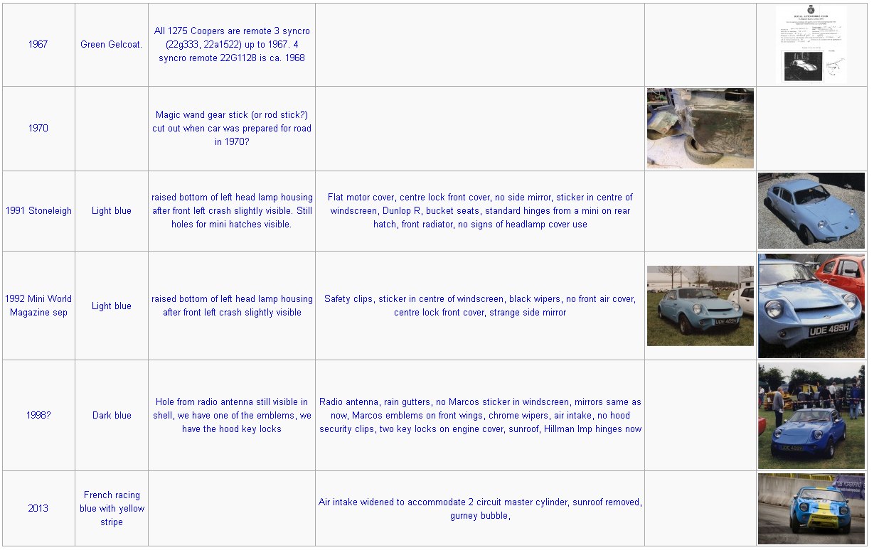

I will continue with a technical table covering mainly technical detail in knowns photos
