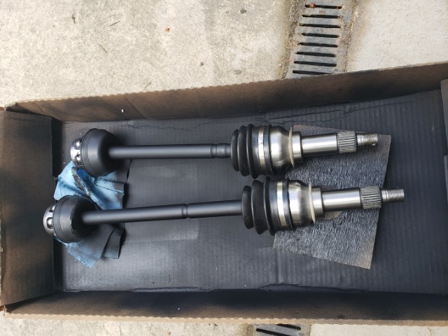

Got the rear sub frame rebuilt, all new bits.. suspension and braking.. and brake lines run..  now onto the fronts.
Mike in Victoria BC - building 8042

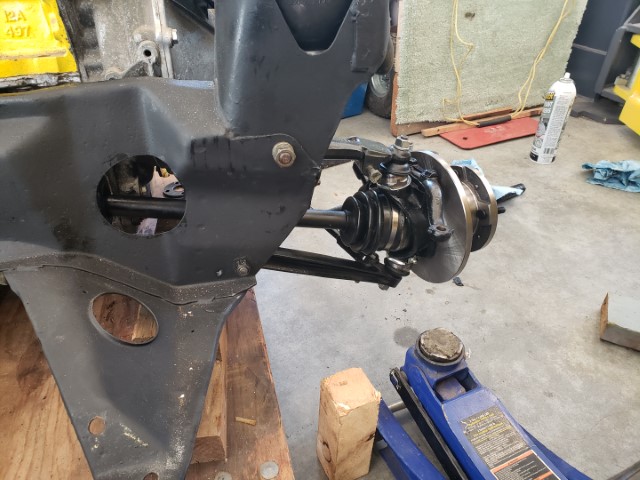

Moving onto the front subframe, , rebuilt with new cones, adjustable trumpets, brake hose and lines, wheel bearings, ball joints, tie rod ends and new CVs. Waiting on new brake discs, so I can then install the new pads as well.

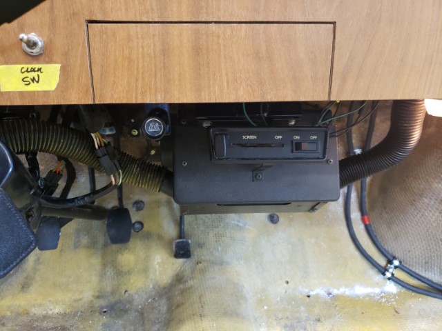

Next I fabricated two brackets to hold the heater assembly.. each bar goes across the opening in the center of the dash area and provides mounting points similar to how they are in the Mini.  The heater is help up on the two back rods, and two screws up front. Undo the screws and the heater will swing down.

Heater brackets on the car..

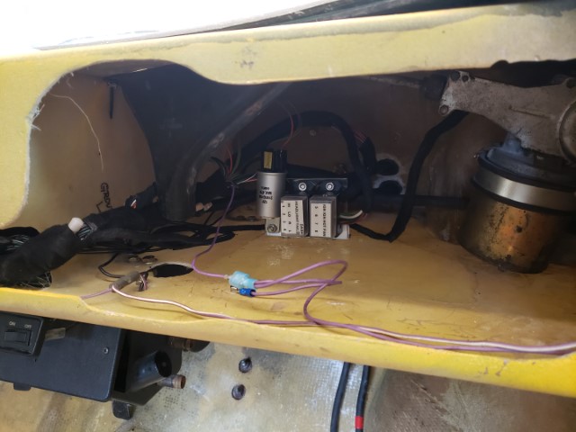

Heater box and defroster vents now installed and access holes for defroster tubes cut.

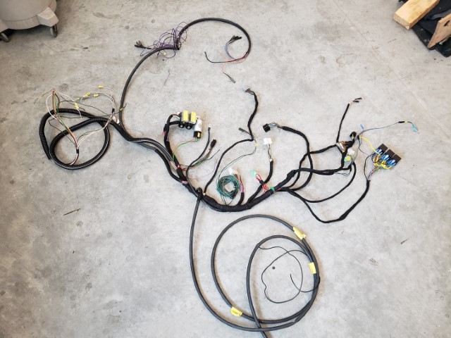

Work started on the wiring harness. This is a Luca Uniloom from Premier Wiring. Very well made, but no connectors come with the kit. I have added the standard bullet connectors for the lighting and scavenged other harnesses for the rest of the connectors.
The harness is getting laid out in the car to adjust the lengths of the wiring and then will be wrapped and tidied up.  The dash is getting a sub harness so it can be removed easily later if required. The back lights are also on a sub harness I built.
The harness comes with pretty comprehensive ground wiring, but as the car is fiberglass I have added additional grounding wires so that very device has a ground wire directly to it.

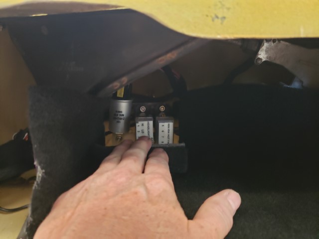

Mike_Smith
Posted on: May 5th, 2022, 18:47:00
Quote Report to Moderator
Minimum Member
Posts: 72
The dash sub harness

Posted on: June 15th, 2022, 02:29:59
Minimum Member
Posts: 72
Wiring harness wrapped and ready for final installation

Mike_Smith
Posted on: June 15th, 2022, 02:33:30
Minimum Member
Posts: 72
Pretty much all the firewall holes have been drilled for wires, throttle, speedo, choke etc... with the fiberglass so much thicker than a typical steel mini firewall, I had to find grommets to accommodate the thickness. and in some cases grind carefully around the hole so the grommet would fit.
Private Message Reply: 46 - 72
Mike_Smith
Posted on: June 15th, 2022, 02:34:54
Minimum Member
Posts: 72
The fuse box and the turn signal/4 way flasher hides in the glovebox area.. to be covered up with a small glove box container.
Private Message Reply: 47 - 72
Mike_Smith
Posted on: June 15th, 2022, 02:35:29
Minimum Member
Posts: 72
The glovebox interior...
Private Message Reply: 48 - 72
Mike_Smith
Posted on: June 15th, 2022, 02:36:04
Minimum Member
Posts: 72
And the secret door to find the fuse box!

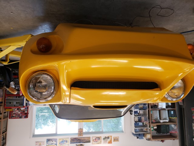

Mike_Smith
Posted on: June 15th, 2022, 02:40:29
Minimum Member
Posts: 72
The small front panel on the nose is not being installed on the car, so I am building a grill which covers the hole between the hood and the body of the car. It's made from some generic ABS grill panels material and will be removable with 2 small bolts.
Even the interior light works.. you can see the door switches in the picture. For now as the doors are off the battery will be disconnected.
Last modified June 15th, 2022, 02:41:38 by Mike_Smith
Private Message Reply: 51 - 72
Mike_Smith
Posted on: June 15th, 2022, 02:42:09
Minimum Member
Posts: 72
A close up of the grill in the opening..
Private Message Reply: 52 - 72

Posted on: June 15th, 2022, 02:43:39
Minimum Member
Posts: 72
Drive shafts rebuilt with new CVs, all new boots and greased up..
Private Message Reply: 54 - 72
Mike_Smith
Posted on: June 15th, 2022, 02:44:29
Minimum Member
Posts: 72
All cleaned up, painted and reassembled. Ready to install on the subframe and engine.

Mike_Smith
Posted on: June 15th, 2022, 02:47:15
Minimum Member
Posts: 72
Heater connected for defrosters, and heater cable installed under the dash on a bracket, rather than on the wood dash..
Private Message Reply: 58 - 72
