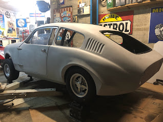

As the shell is 'new' it has no holes for the window tracks on the doors and i don't know how to fix these tracks, i don't know what to put as a lock for the rear hatch either.
I've searched a lot but I couldn't find the information.
the shell is cracked in a few places and I don't know how to fix it so that the paint doesn't crack later.

The window frames are normally screwed/bolted at 4 points along the top edge of the door, then you will need to glass a block or plate into the door where the frame touches the skin. The Mk5 uses later type mini door lock and a panel lock on the tailgate.
The cracks will need grinding out (you may need to glass the inside first) then lay some glass in, flatten off then fill and fair to shape.

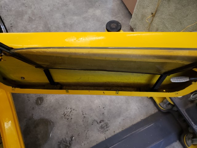

Here is a picture of what the window frame looked like in the MKIV I just built. The frame looks longer than yours and the bottom was fastened to wood blocks that were fiber glassed to the bottom on the door
Mike in Victoria BC - building 8042

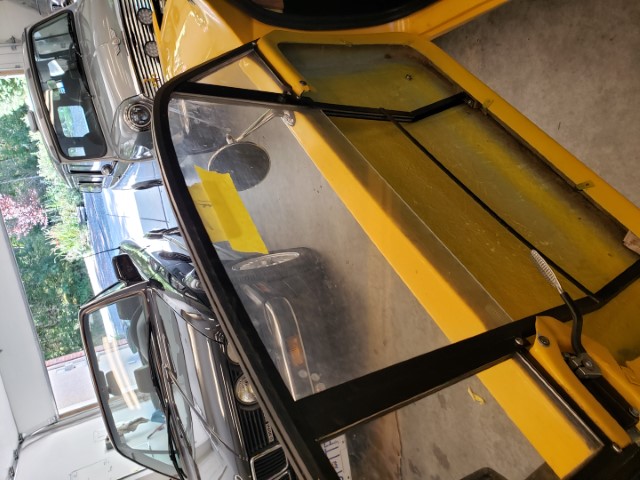

You can see the door bottom with the wood blocks in this picture.. not screwed in place in this shot.
