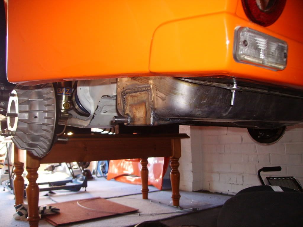

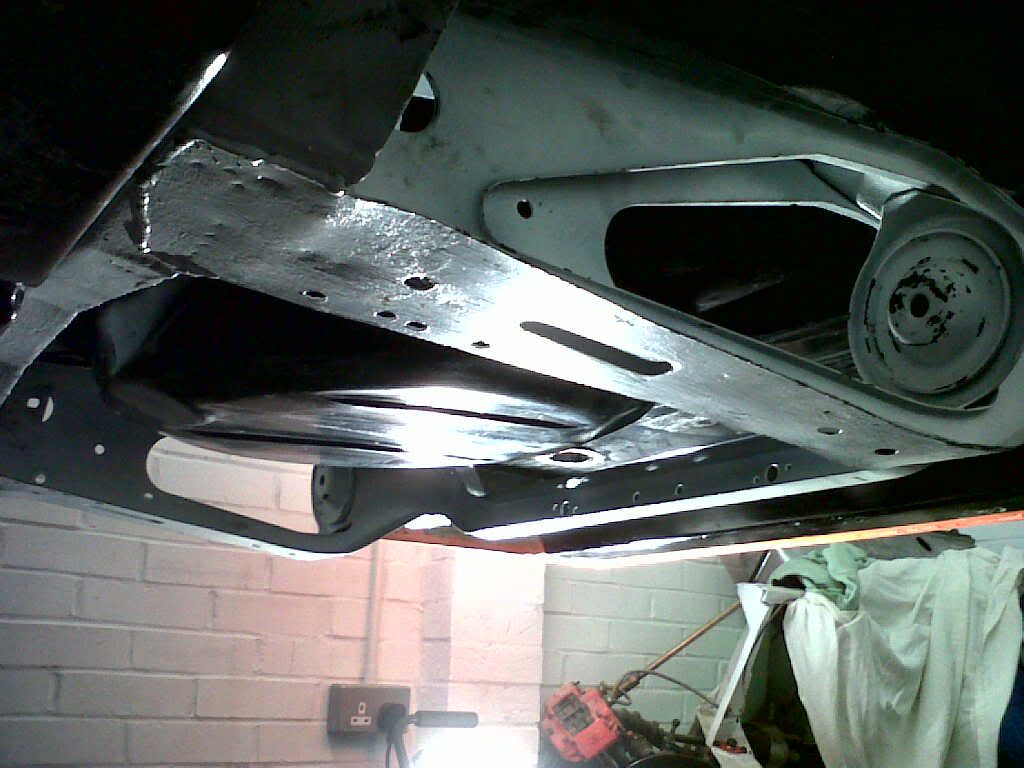

So,  a little grinding, a little advise (from a certain Mr Dickens - thanks John!) and realisation that my wheels will stick out one side more than the other and:
Tonight I tried to fit the radius arm to the 'easy' side (right, with more space) and.... not a chance.
Well, I could struggle and probably get it in place, but I wouldn't be able to grease them up!  So, it looks like I'll definitely need to drill holes in the bodywork (which will also make it easier to fit the radius arm in the first place too).
How's best to do this?  I know some of the older mark's of MM have this - is there a standard size to drill (corresponding with a suitable cover/grommet)?  And seeing as how the cars painted is there a best way of doing this?  And how do I repair the gelcoat afterwards?
(You really would have thought the original owner would've done a dry build and discovered all of this prior to painting, wouldn't you?)

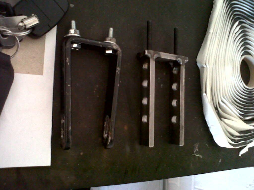

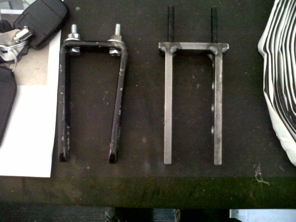

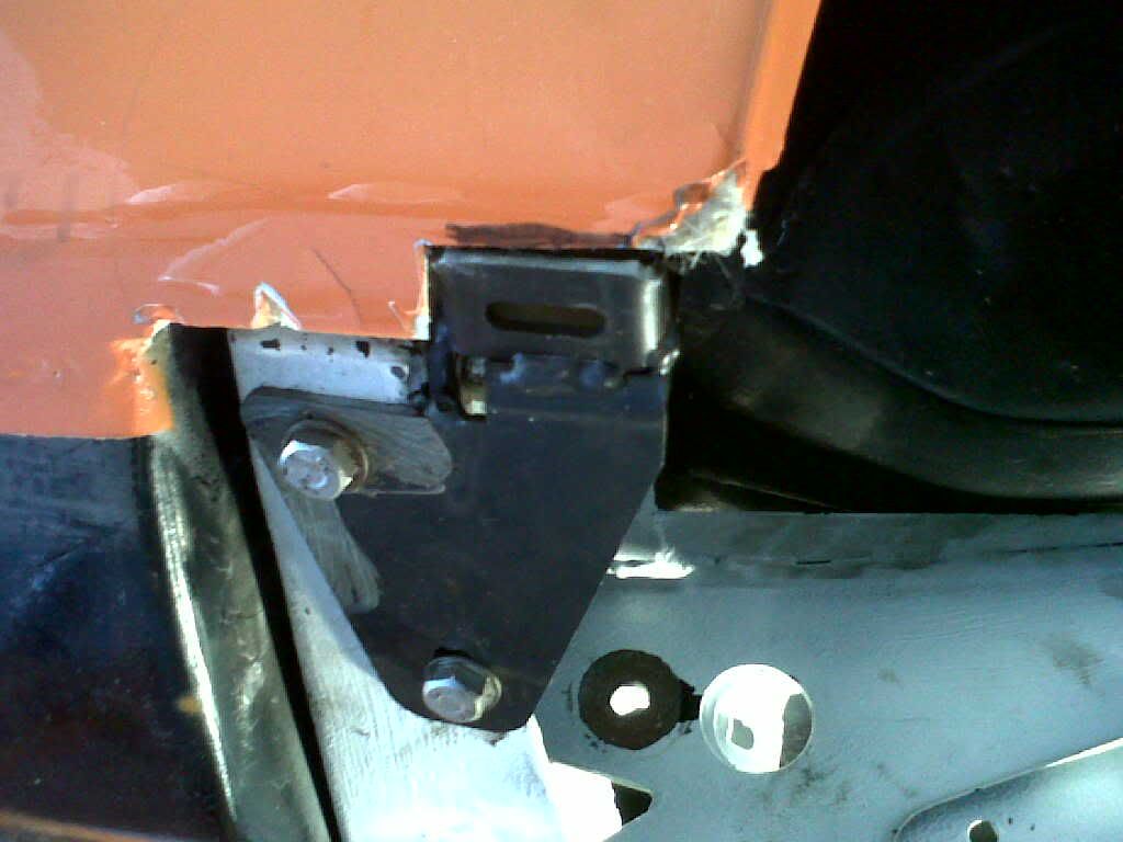

I did manage to get the new steering column bracket fabricated:
I'll cut it down to size when I offer up the column and get it fully welded up:

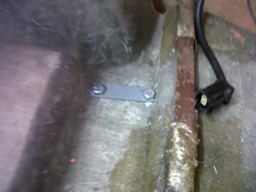

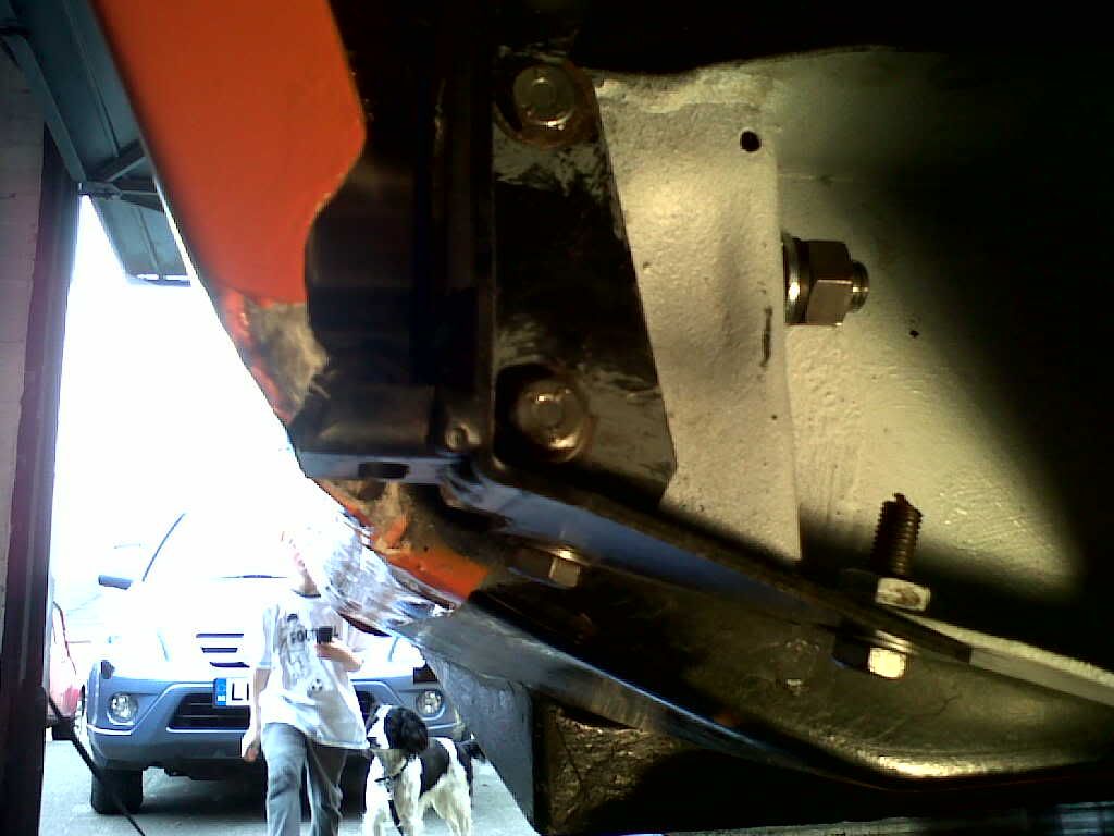

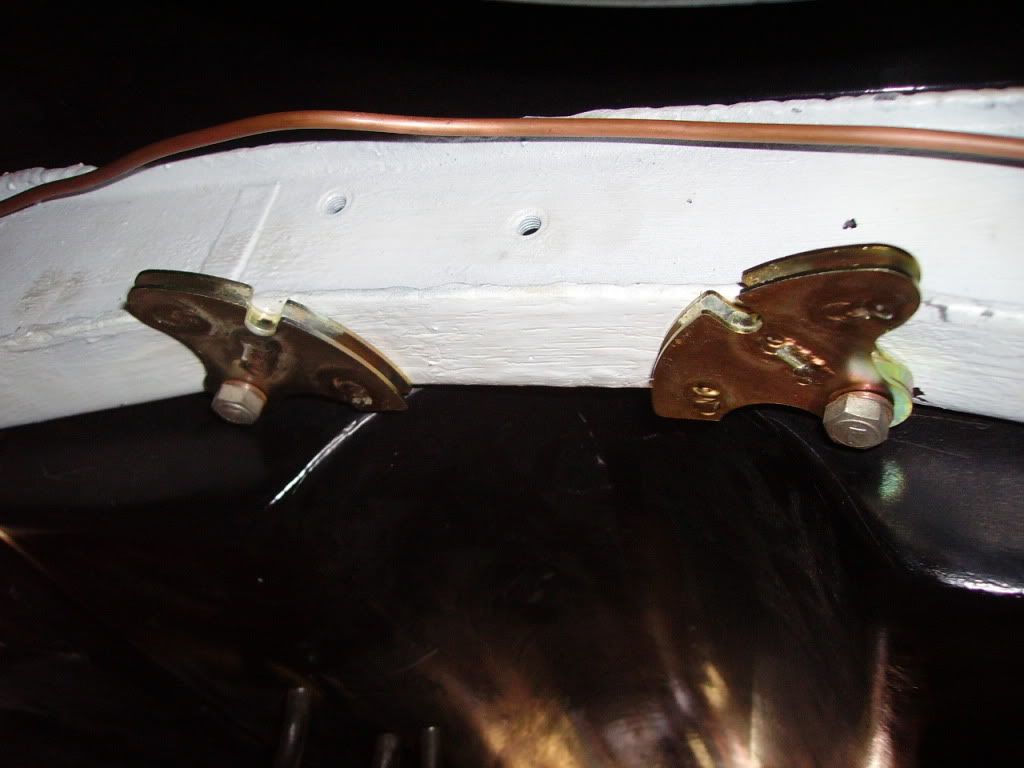

Forgot to show last time, I made up some spreader plates for the subframe bolts:

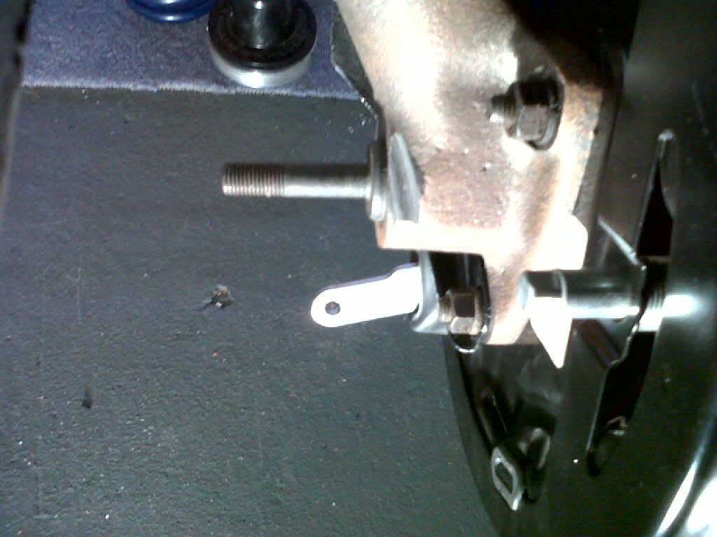

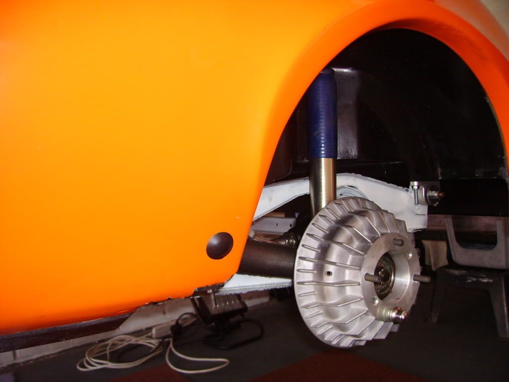

Today I managed to get the radius arms fitted (I now hat ethat job!).  With the subframe being offset left, it was neccessary to take a small part of the 'sill' away on the left hand side:
The worst bit is knowing I'll need to take this all apart again to reinforce these areas and repair the gelcoat/paint.
When fitting the shock I noticed the body of the shock was contacting the raius arm.  I think I've read about this in one of the magazines and I'm sure they ground away the area of the arm that was in contact.  I'll try and dig the mag out.
The right rear was the same, except that on that side the top of the shock couldn't fit in the hole through the body - hopefully it will when fitted correctly onto the radius arm.

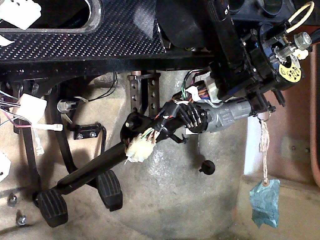

Finally, got the steering column offered up.  Again this'll have to come apart again for final welding when everything been connected and tested.

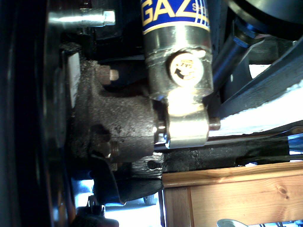

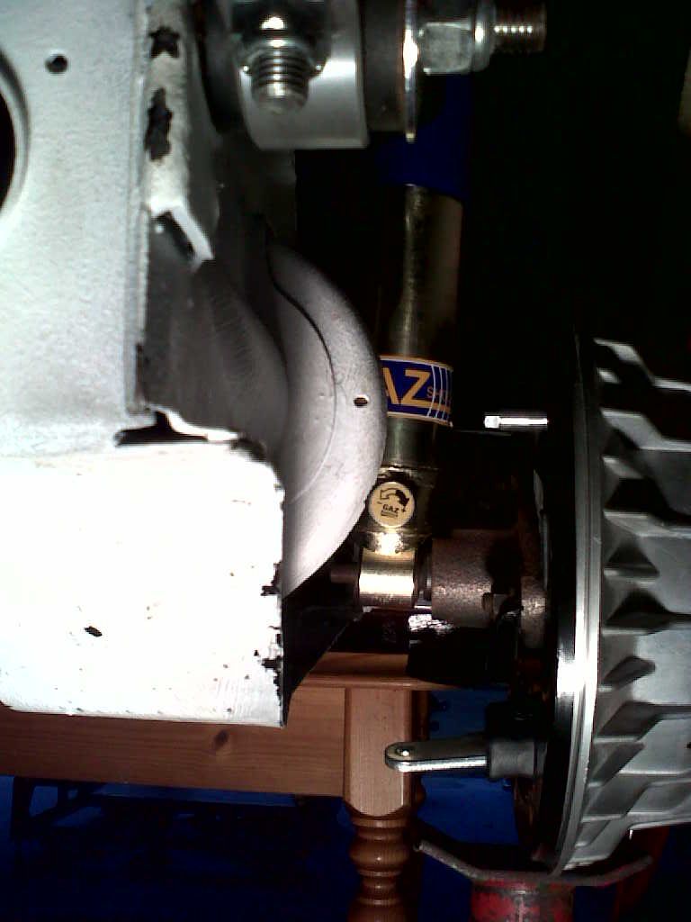

This was neccessary to get the dampers to clear the radius arm:
Although I've got Gaz units, in Keeping Your Mini Alive 5 they had to do something similar for Spax units.
For the RHR unit, although I've got it fitting, the hole for the top nut isn't aligned above the radius arm.  I guess this is another example of a hand made shell idiosyncricies, but am I okay to elongate this top hole to align the damper correctly?  Is there a risk that the hole could be made too big (long)?

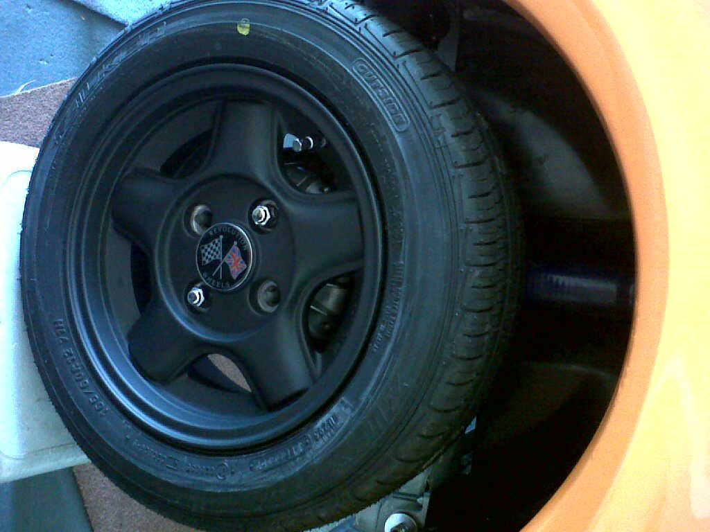

But I couldn't resist fitting a wheel on temporarily:

I'd be a bit wary about elongating the hole. I'd prefer to fill it in and glass over the area on both sides, then drill a new hole where needed. Some shocks have offset studs at the top so you don't need to do this.

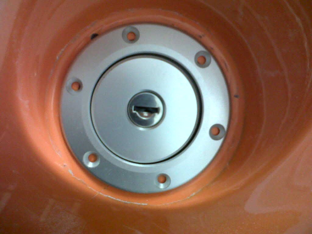

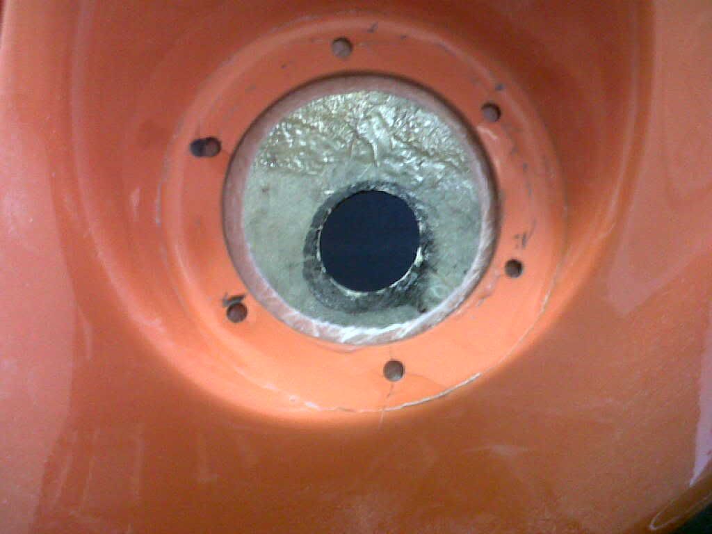

I've cleaned up the fuel filler hole this morning.  The cracking is worse than I thought around the securing holes, so I followed John's advice and placed a couple of layers of CSM across the back of this area to stiffen it.  My GRP work is probably best described as, err, workmanlike!  More practise needed I think (although I hope not to get more practise, if you see what I mean!):
I opened up the hole to accept the filler.  From this I can see that I need to fill in the holes (countersink and resin in individual fibres yes?) and I'll probably fill in the 'lip' thats been created to provide a bit more rigidity too:
I'll need the gelcoat soon as well to make the best of this job.
ETA I realise that the cracks don't show up as well now I've seen the photos large scale, but would I now just treat these as cracks in the gel coat?

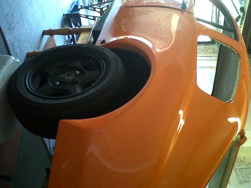

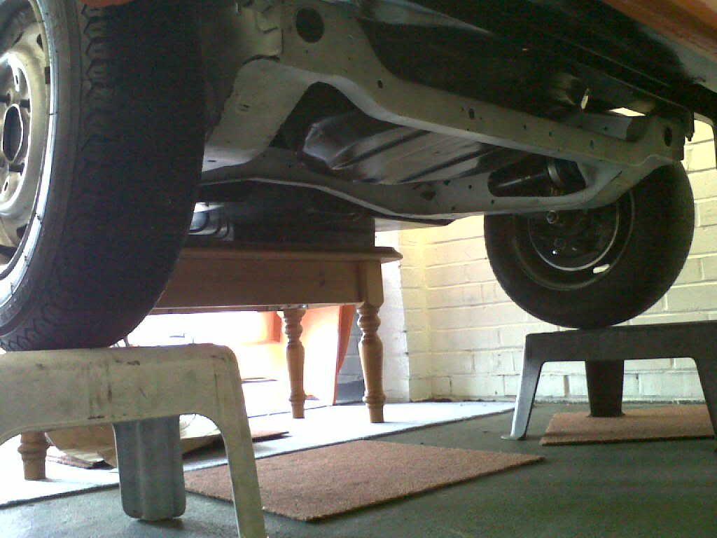

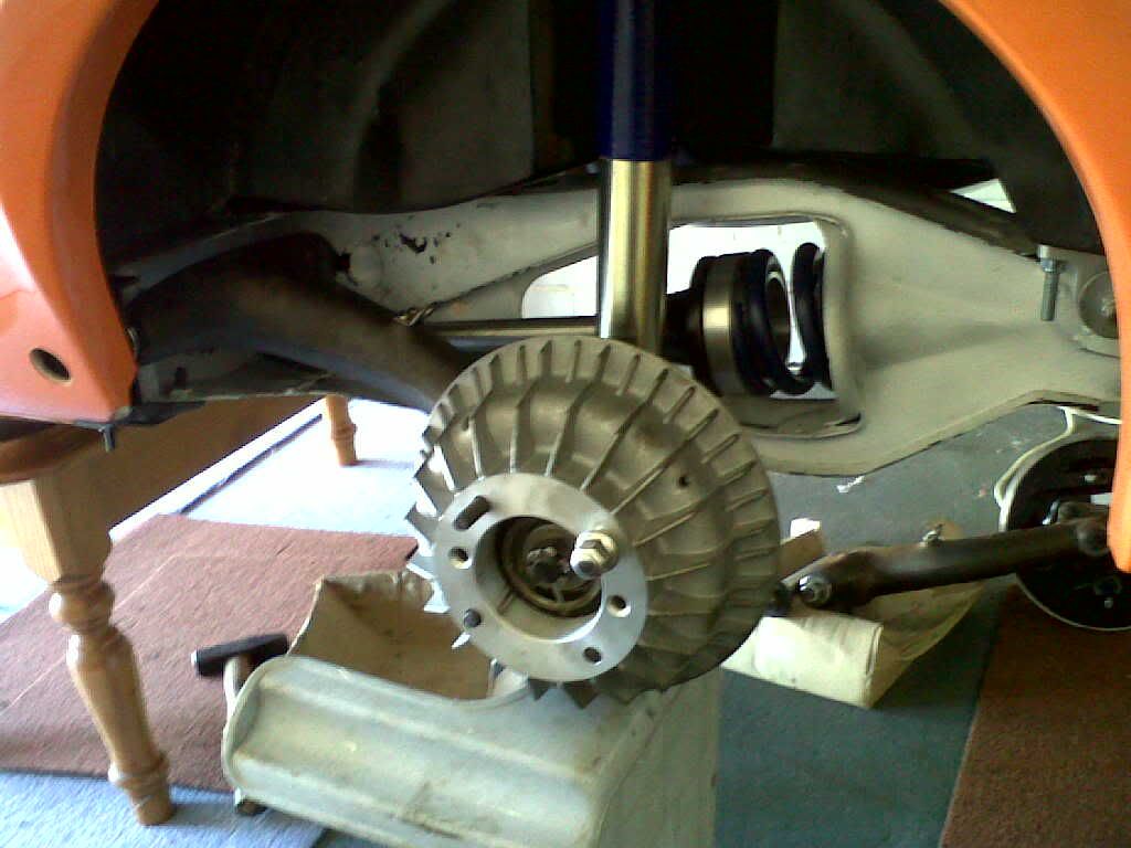

With a mixture of measuring and viewing, I've got two wheels on my wagon now:
Strut and spring in place:

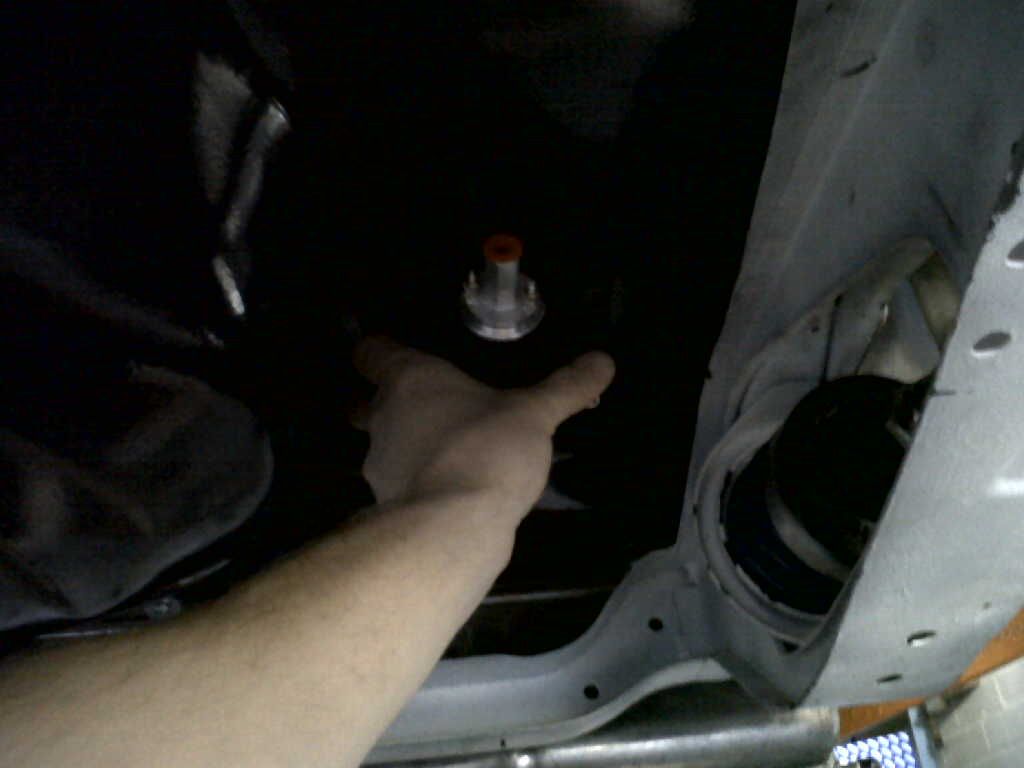

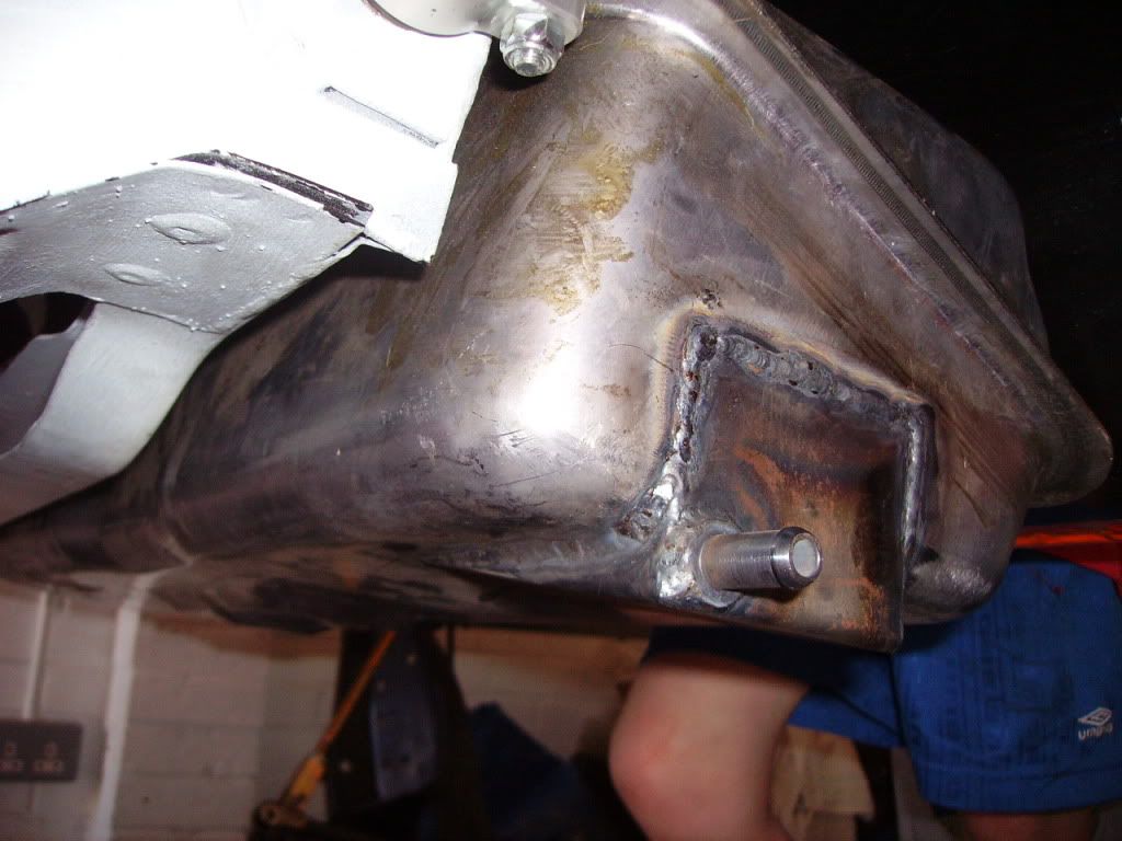

This is the solution I have for part of the fuel tank problems - supply outlet fitted:
I'll run a filter directly after this (i.e. before the pump) and it doesn'tt protrude to low either:

Hope this picture comes out!  I'm proposing to put the fuel pump here:
Is this going to be too exposed?  What could I use to shield it?

Steering column correctly fitted now, heater refitted.  Does anyone have any pictures of where the heater pipes go through the bulkhead?  Comparing with the mini, the heater pipes would protrude directly where the chassis plate is.
