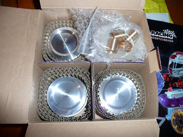

Tom Wiggers
Posted on: February 5th, 2008, 22:04:56
Quote Report to Moderator
Location: Hengelo
Posts: 224
Reputation: 0 (tot: )
Here they are. Recieved them yesterday.
Omega forged dish +060 6222.0.1
Last modified February 5th, 2008, 22:07:46 by Tom Wiggers

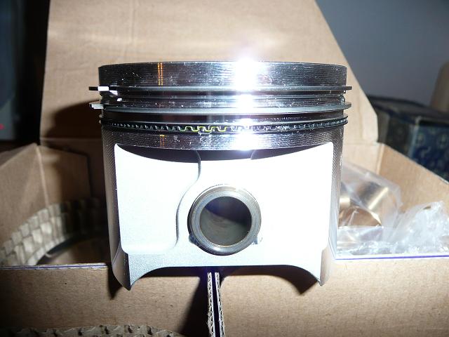

Tom Wiggers
Posted on: February 5th, 2008, 22:06:25
Location: Hengelo
Posts: 224
next photo (I can only upload one at the time?)
Logged
