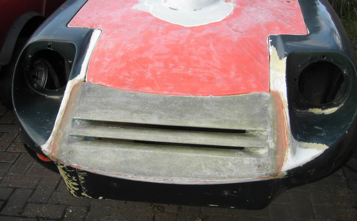

If anyone wants a nose panel like the one on Howard Plant's (ex-David Pounder) car I have the mould. The panel has two horizontal slots in it. 8407 has the original panel off this mould attached.
My preference is to have the nose panel bonded in, but remove the original flat panel to provide better access to the radiator.

admin
Posted on: April 11th, 2008, 16:27:26
Quote Report to Moderator
Team Member Administrator
Location: Maidenhead, UK
Posts: 2,369
Reputation: 1 (tot: 1)
I don't think I ever took a photo of it when it was more or less complete. This is the nose:

They were offered by the factory, and I guess there are moulds knocking around for them. Also there's a ducted version which has been used on several cars, including Andy Wright's (which for some reason appears to be missing from Members' Cars).
If you use a full length bonnet keep the existing panel for stiffness, although you can cut out a hole in the middle of it for access. If the new nose panel is bonded in then you can remove a lot more of the original fibreglass.
