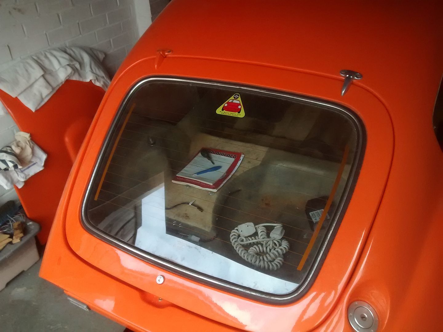

I bought a new boot hinge (less than £6) and offered up the hatch:
I didn't realise the hinges were handed - luckily I took along the old one.  I also learnt that the reproduction hinges are M6 thread - another possible reason why the old one was stripped?  So I've now got one that's imperial, one thats metric  .  Fits in with the rest of the car then!
Despite loosening off the hinge to body to hatch fastening in order to try and get the best fit, the 'unique' way these cars are built means that the hatch catches on the body slightly:
The panel gap isn't that bad around the rest of the hatch.  I'm hoping the rubber seal I've ordered will lift the hatch slightly and prevent too much rubbing.
I can also only lift the hatch this much:
Does that look about right?  I can't lift it any higher (well I could but don't want to cause damage) because the lip of the hatch goes hard against the shell and I don't want to stress the area around the holes in the shell (for the hinge screws).
I did buy the gaskets that fit under the hinges (couple of quid) which will lift the hinges up a couple of mil, and I suppose careful mounting of a pair of struts will stop the hatch opening too much.

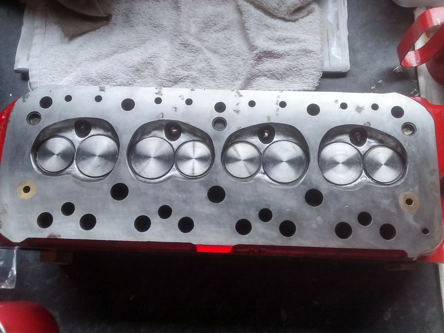

I also took the opportunity to measure the combustion chambers on the cylinder head I've ported for this engine (I couldn't remember if I'd matched them up or measured them its so long ago since I cut this head):
I must have because they were pretty close:
The first head I did, I spent ages measuring these again and again, trying to get them exactly right until I realised the little syringe I use (free with kiddies medicine) isn't really that accurate or finely marked.  But these seems pretty good so I stripped the head down again and dried everything off.

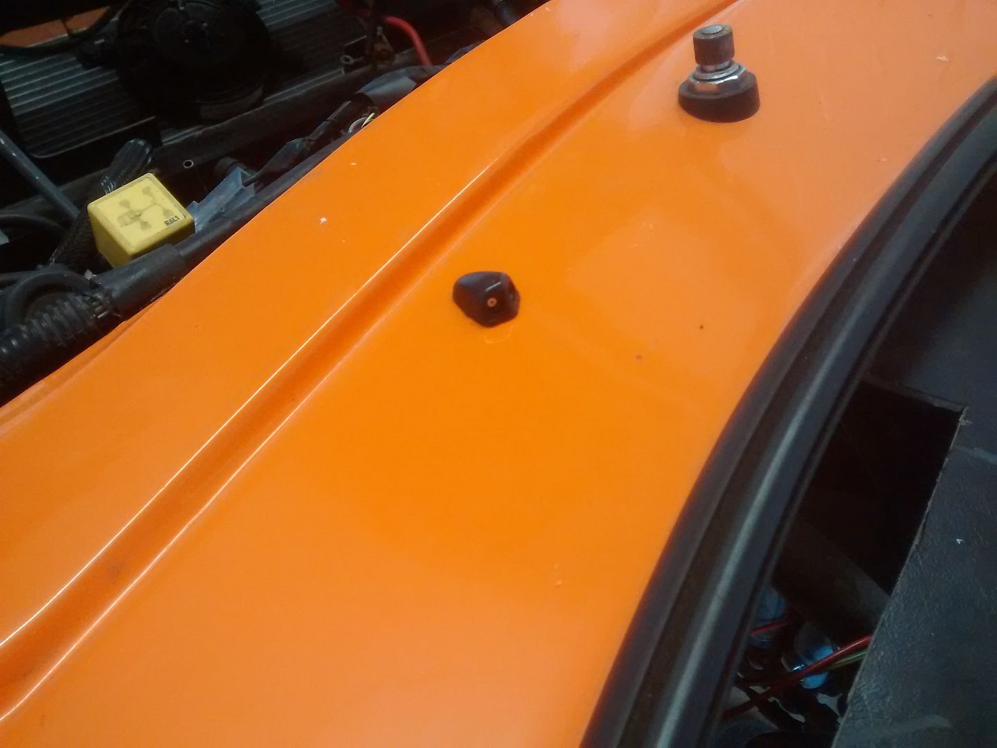

I marked up the washer jet positions:
I ended up moving them forward by about an inch as this position (which looks the best - sort of in a nice straight sweep, in-line with the spindles.  'A straight sweep'???? ) as the tube for the washer motor runs directly below here.
Anyway, got the drill out, set out the tape so the drill doesn't slip and couldn't then find the washer jets!
Bugger.  So stopped there for the night.
Oh well... A little bit further forward!

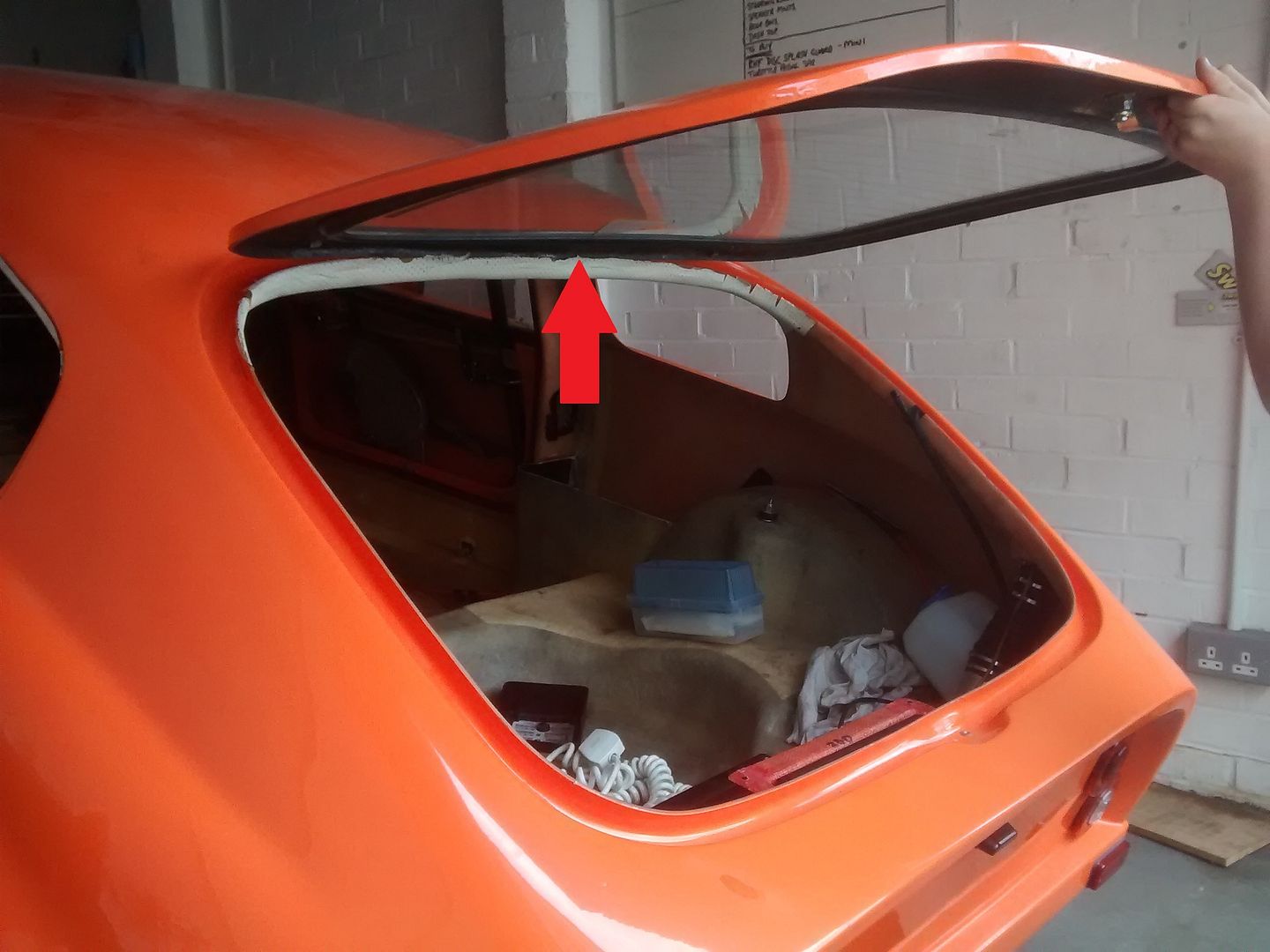

You need to trim the vertical edge of the hatch where it hits the body normally a "bump" in the trim line is enough to get it to clear. As for the lifting height again trimming the vertical part of the hatch shoould allow it to open further mine used to go to about 45°. Both these trims are quite common on Marcos rear hatches in fact I'm pretty sure the mould I have (i made it off a friend's hatch) has them in it.

Mike - you mean trimming here:
Could that lead to potential problems with rain ingress?
Simon - I had though of that as a solution but I know that the Heritage car has struts and it would prevent the possibility of accidentally knocking the stick!
So they can be fitted.  Perhaps they are glued/bonded onto the hatch (as opposed to drilled/screwed).

Fitted the boot seal this afternoon.  The shell thickness gets bigger at the top of the hatch so I only put the squishy stuff around the bottom:
Notice I've adopted the wooden stick approach at the moment also
I looked closer at the top edge (where it was sticking/catching.  Closer inspection showed that the way the headlining and the sponge under it has been fitted was causing the hatch to bunch the sponge/lining up against the lip of the body.  Carefully trimming the excess lining back (where it had been folded over the lip) gave clearance to open the hatch wider.  I've attempted to put a length of 'U' channel over this lip, but all I think I've succeeded in doing is putting the restriction back in place.  So I'm not sure how long that'll be staying in place.

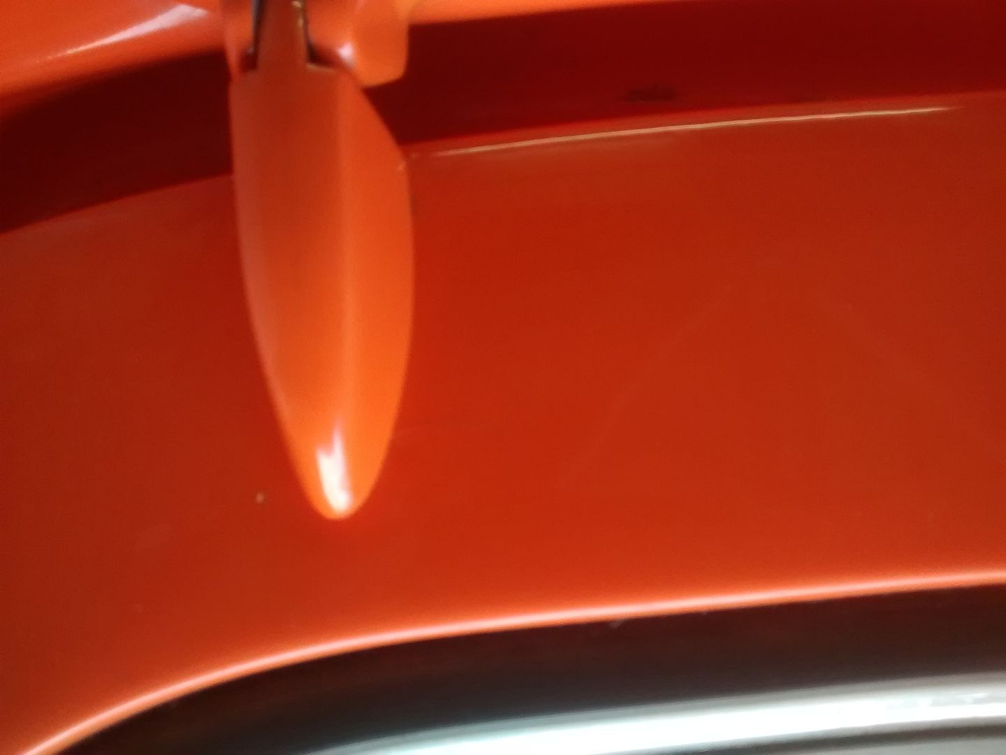

Something I haven't noticed before (and I'm not sure if the photo will show it) but there's a couple of light (stress?) cracks to the right of the left hand hinge:
Have these been there all along?  Have they appeared since putting the hatch on?  I don't know.  But I'll keep an eye on these.

The other thing I got around to doing today was drill and fit the washer jets:
I've ranted on here before - who paints a car before drilling for all the fixtures/fittings  >
Despite careful use of tape and using new drill bits, on removing the tape there was flakes of paint broken away.  Judging by the colour the gel coat has at least some thickness left.
