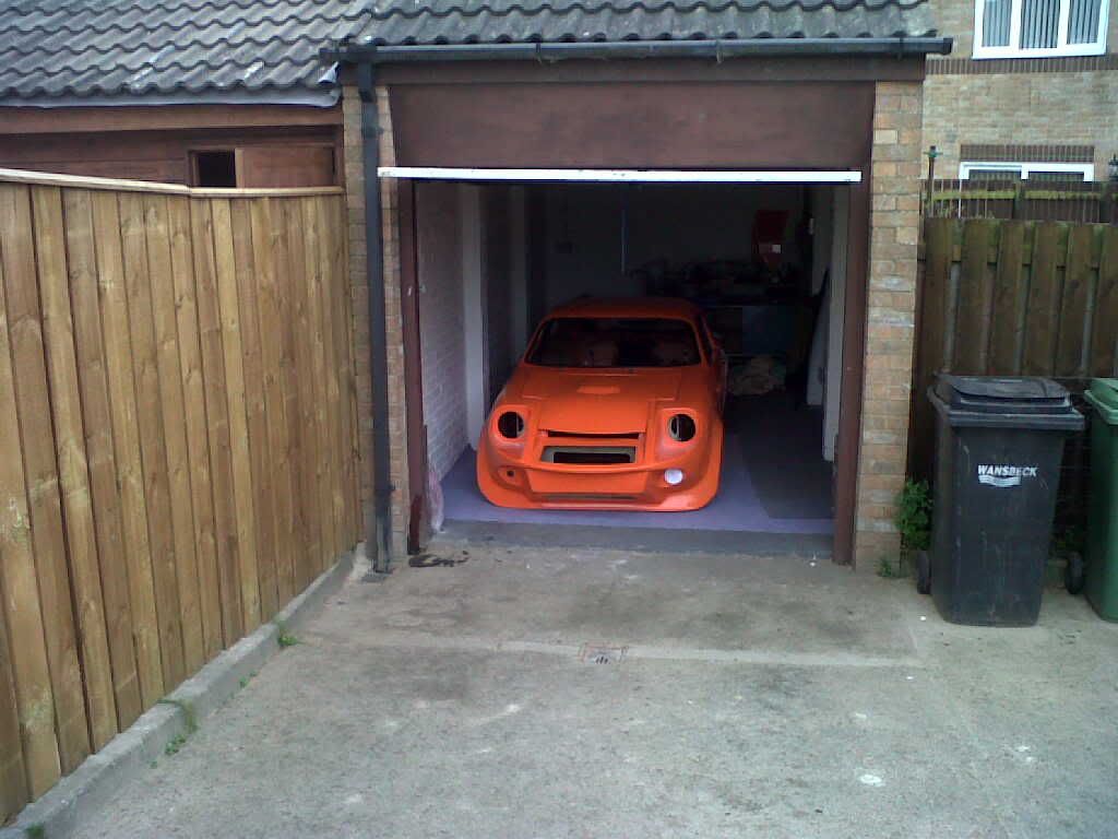

Well, not to much to report, except that with the help of my nephews my mother now has her garage back:
 And I've got a new job! But it does mean long hours and a lot of travel so I'm not too sure how much time I'll have to get the build completed. But at least now I can pop out of an evening, as and when! But I did get half an hour in there this afternoon, and refitted the newly repaired pedal box:

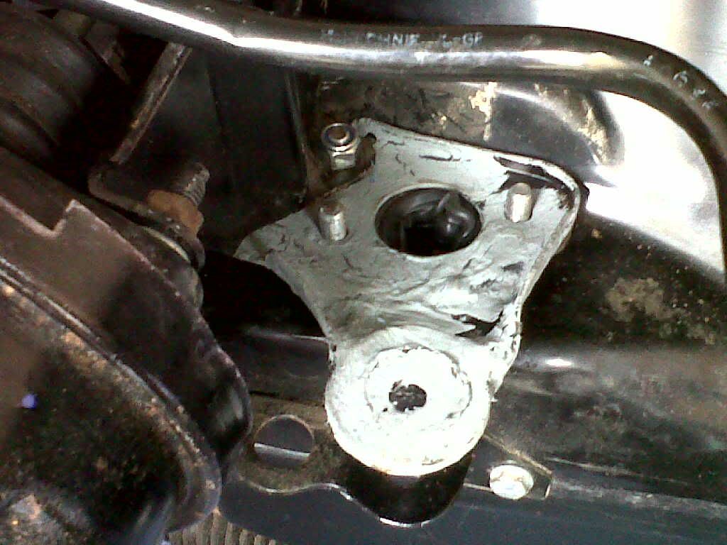

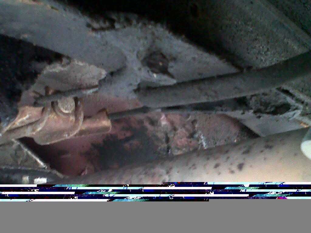

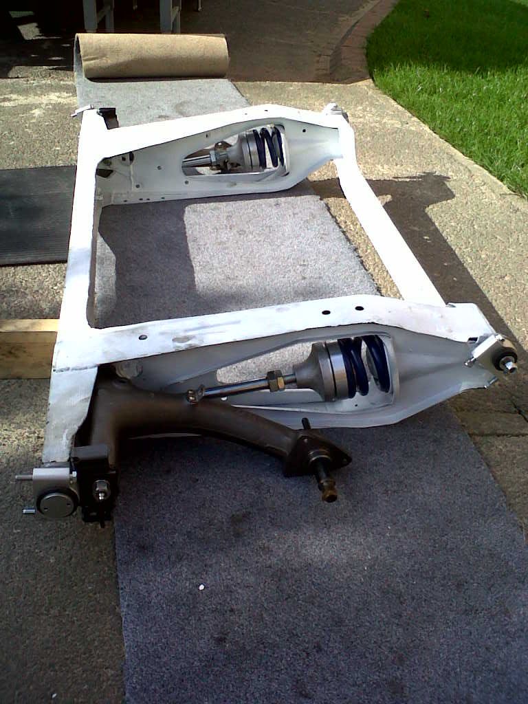

Couldn't work on my college project so started building the rear subframe this afternoon:
 I guess its an copy part, not an original because I had to do a fair bit of fitting to make things fit (opening up holes and the like). Richard, I take it this is the bracket you mentioned earlier in the thread, for the handbrake cable? Are they available seperately, or does anyone have an old subframe they've changed recently?

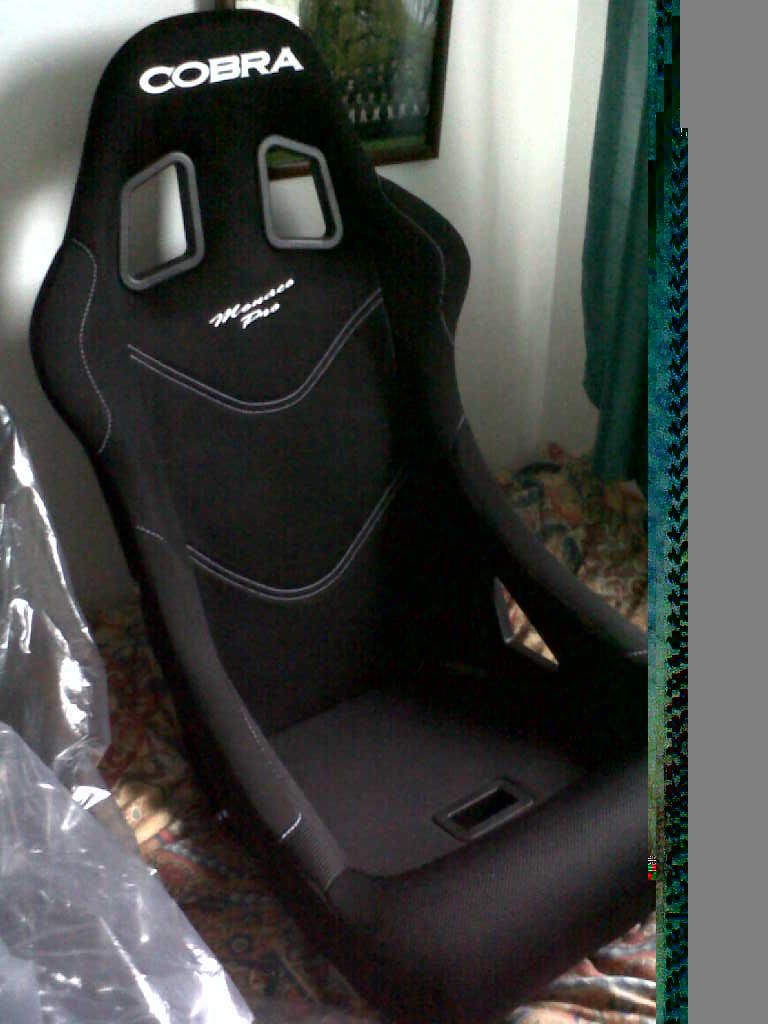

Cheers Joost - I take it they hub itself is the same? And is the spacer the same for both types of bearings? Well the new job may prevent me getting into the garage much but at least it allows me to pay for these:
 Not quite the Imola S (or Pro as it is now) - the job doesn't pay that well! They are Monaco Pro, very similar in dimension to the Imola (which was important) but with a steel frame, not composite. |

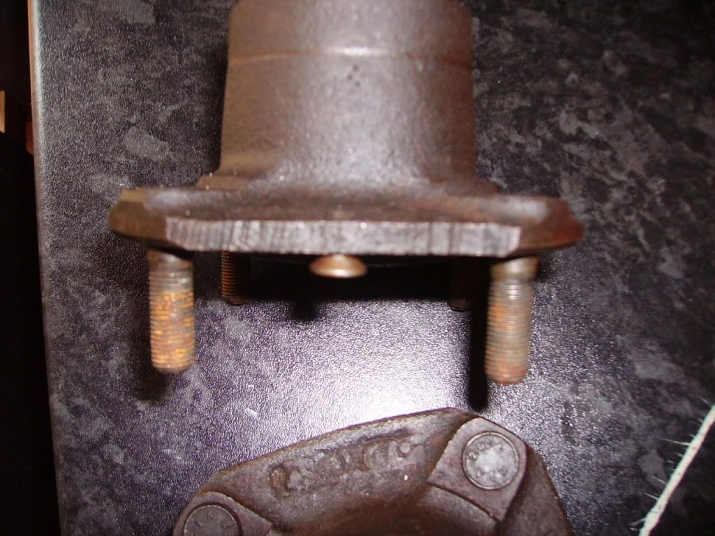

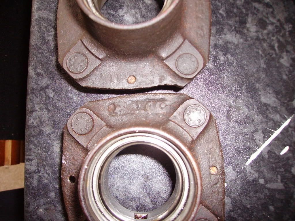

Can I ask for some opinions here? I was looking at the rear hubs with a view to building up with the new bearings that I've got and noticed this - the edge seems to have been 'fractured' off:
 Looking at the edge itself, it doesn't actually appear to have been broken off:
 Can I use these or not? |

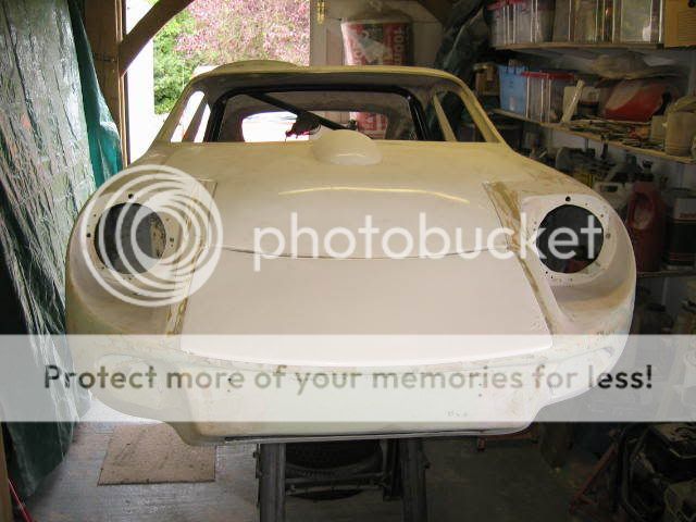

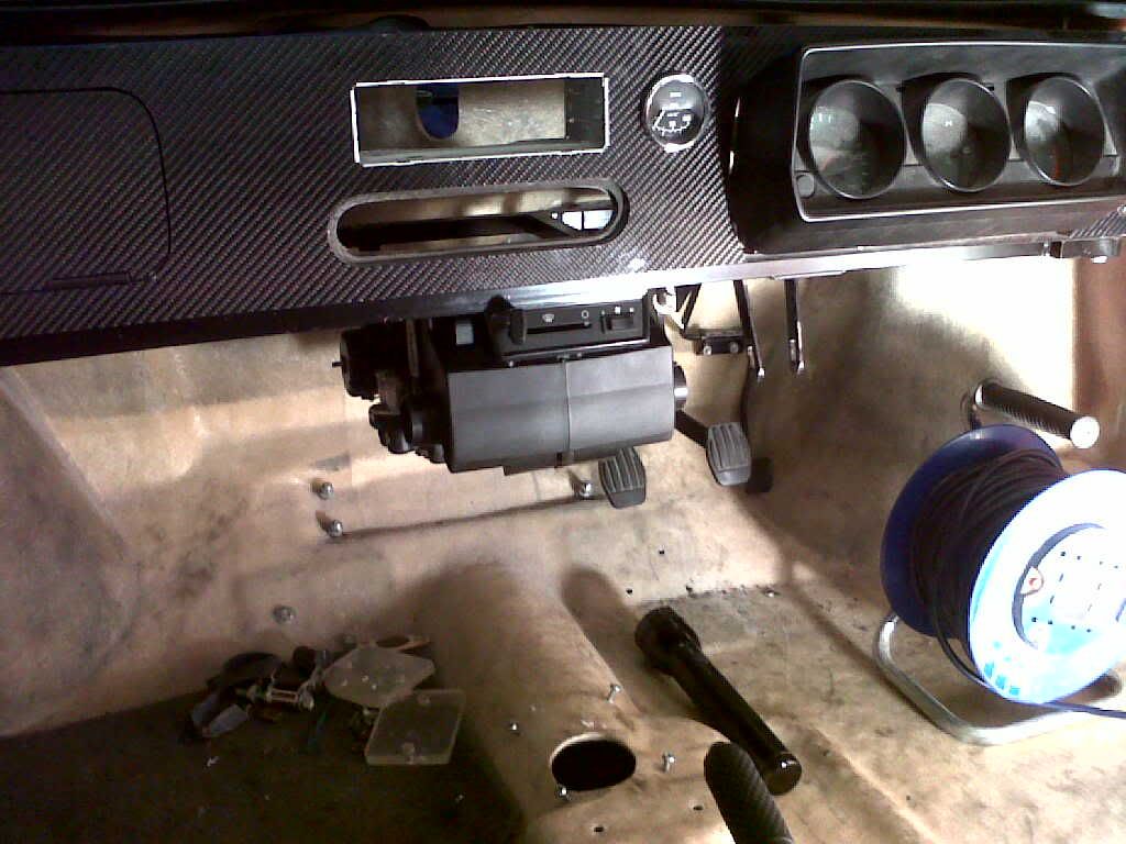

Well, I knackered the vacuum motors on the flow bench so went into the garage. I managed to (loosely) mount the wiper motor - I used an existing hole in the bulkhead. When I've got things positioned I'll secure everything properly and put some silicon in the holes to water proof them. I also offered up the heater unit:
 Not remembering what Richard recommended was next I attempted to fit the headlight bowls. The plastic bowls I've got have come with screws and securing clips (as opposed to the rivits I was expecting to use), but am I right in thinking I'll have to drill a hole for the adjuster screws to go through? I tried to compare it with my MPi, but its' headlight bowl is a little different having motor height adjustment. And is it only the chrome surround that holds the lens in place? I seem to remember my old mini having some sort of spring arrangement. And does it matter where the adjustment screws are positioned (as in at the 12 o-clock position)?
And would anyone out there use those rear hubs? |

I'd use those hubs. I also know someone who cuts off parts of the hub with an angle grinder to loose a bit of weight. |

Hello, on my headlamp bowls I had to drill two clearance holes for the adjuster for each bowl. They were positioned at 9 (or 3) o'clock and 12 o'clock. That way you can adjust for up and down as well as side to side. The chrome rim around the lens had two tabs each with an angled slot and one tab with a hole. You slide the slotted tabs onto the adjusters (they have a effectively two heads 1 mm apart) and put a screw through the third tab. Screwing the adjusters in an out moves the lens, they pivot about the retaining screw. You'll have to squint but you can see the larger adjuster holes, both sides at 12 o'clock, offside 9 o'clock and nearside 3 o'clock
With my heater I made a lot of work for myself by swopping over the intake to the nearside. I also made up some diverters for the screen demister vents so that the plastic demister funnel laid flat against the top of the dashboard rather than poking down. It allowed the demister trunking to have a better run from the heater.
My hubs looked like that too |

Cheers Stuart, Peter - I'll get the rear hubs built up then. And get the bowls fitted. As for the heater inlet, it's an MPi twin speed heater which has the inlet on the nearside already. I haven't drilled the holes through the bulkhead yet (but theres lots of time for that yet!)

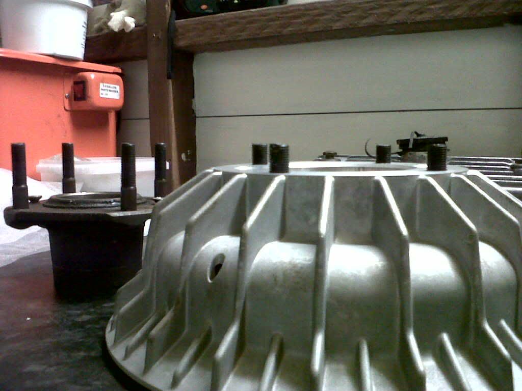

ETA Put the new wheel studs in and offered up the minifin drums (with inbuilt spacer). Theres only 12mm of stud protruding which (from memory) seems less than the MPi. Does 12mm seem right to you?

No, you need more than that. That drum looks a lot taller than normal. Those studs would be OK with normal Cooper S drums or standard Super Minifins.
Btw don't buy the cheap Chinese minifin replicas as they are inaccurately made. I had to return one pair because one of the stud holes was slightly out of position and the drum clamped tightly onto the backplate when the studs were tightened up. |

Cheers Richard. The drum are from minispares and seem quite good items so I'll look at getting longer studs if available. I drilled the holes to fit the bowls yesterday. Who on earth would paint a shell before sorting out all the drilling . I thougth I was being careful - masking tape, pilot hole etc but some paint still chipped off. Oh well, I need to get some coloured gel coat for the scratches on the rear quarters, so will use some to fill in the chips eventually before fitting the bowls. |
