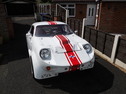

Yes that is mine in my profile and the mk5 swift powered was also a crashed car plus I've rebuilt 4 other crashed cars for club members.

Phil Smethurst
Posted on: June 20th, 2014, 02:39:52
Quote Report to Moderator
Medium Member
Posts: 145
Hi Alex,
           a couple of pics of the car. I would definitely look for a shell with a rear hatch as others have pointed out it makes it so much easier to do anything around the rear inside. The bodywork on mine is anything but perfect but still took ages as I was young and learning to mould (still lots of room for improvement!) during the (long) rebuild. Trying to get the car into any shape to paint (also done at home) was the hardest part of things. Tackling a big bodywork job just wears you down and I thought about giving up with mine but nobody would of bought it as an empty half done shell. Good luck with the project if it gets going.
Private Message Reply: 61 - 113

Private Message Reply: 63 - 113
Phil Smethurst
Posted on: June 21st, 2014, 04:30:47 Quote Report to Moderator
Medium Member
Posts: 145
Sorry Alex - no such thing as a MM body kit!. I moulded the arches and skirt and front end though the front end needs a new mould making and a better front pressed out of it at some point in the future.
