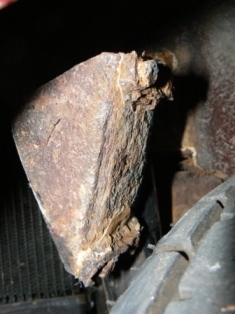

Quote Report to Moderator
Team Member Administrator
Location: Maidenhead, UK
Posts: 2,369
Reputation: 1 (tot: 1)
Photo for Hervé. Sorry one or two members are having problems uploading photos.
Front damper bracket mount.

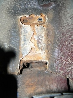

Posts: 2,369
The other one.

Looking at the photo it's pulled through both the cross member, steel plate and the fibreglass. Your only real coarse of repair is cut it all out and rebuild with either new metal or if you know what your doing it is possible to do it with just fibreglass.
Mike

the under of the shell is not in good conditions (wood parts are fixed in the tunnel for the gearbox linkage)
Shell view at the front suspension bracket. We will work on it during the restauration (on both side) and we will make new steel insert
Private Message Reply: 25 - 58
