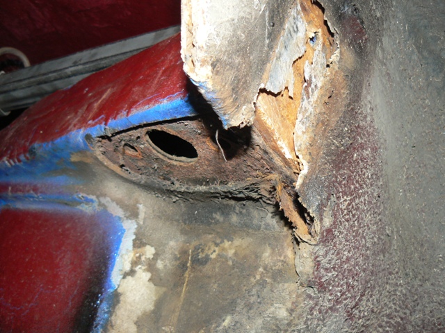

I have one question. When I bought my marcos, the bulkhead was cut in carburator zone !!! not good for rigidy I think. (see picture). My concern is that with new bulkhed, we could not put in place the carburator. The engine is a british open one transformed in carburator instead of injection (I bought it like that).
For you, Is there an alternative ? could I change my SU by another one (for information, I am not intersted in weber one because my engine has no modifications to have more HP)

mike brown
Posted on: September 6th, 2017, 05:58:52 Quote Report to Moderator
Location: Southampton
Posts: 374
Some inlet manifolds give better clearance so you could try a different one. Cutting the bulkhead is no problem as long as the hole is fibreglassed over later cars have no steel in the middle of the bulkhead and the steel is only there to stop the bolts crushing through.
