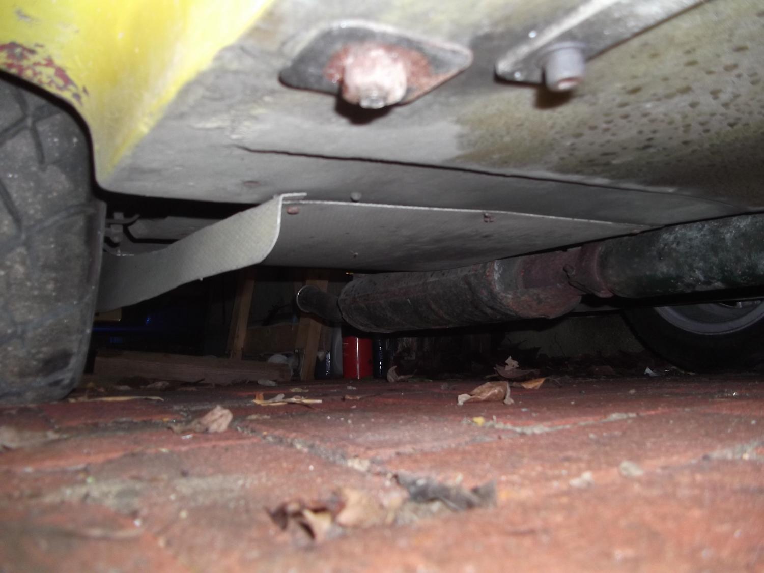

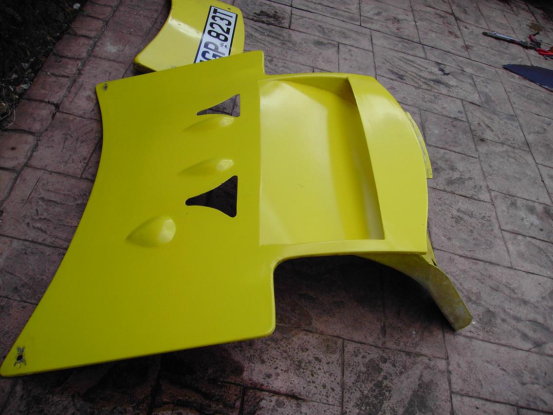

Unfortunately I can't find the video, but here are some photos of the bonnet and diffuser. I remember when we did the bonnet we originally dipped the the whole front of the bonnet but found the air flowed better with about 5" of the front of the bonnet left in place.
As for the rear diffuser it was more about creating a smooth air flow under the car and therefore less drag than improving the handling. As for speed on a hillclimb or sprint, I used to get 80mph at Gurston down and 115mph at Goodwood. |

Allan Brown |
Posted on: December 20th, 2014, 21:26:53
Administrator
Location: Billingshurst, UK Posts: 452
front of rear diffuser |
