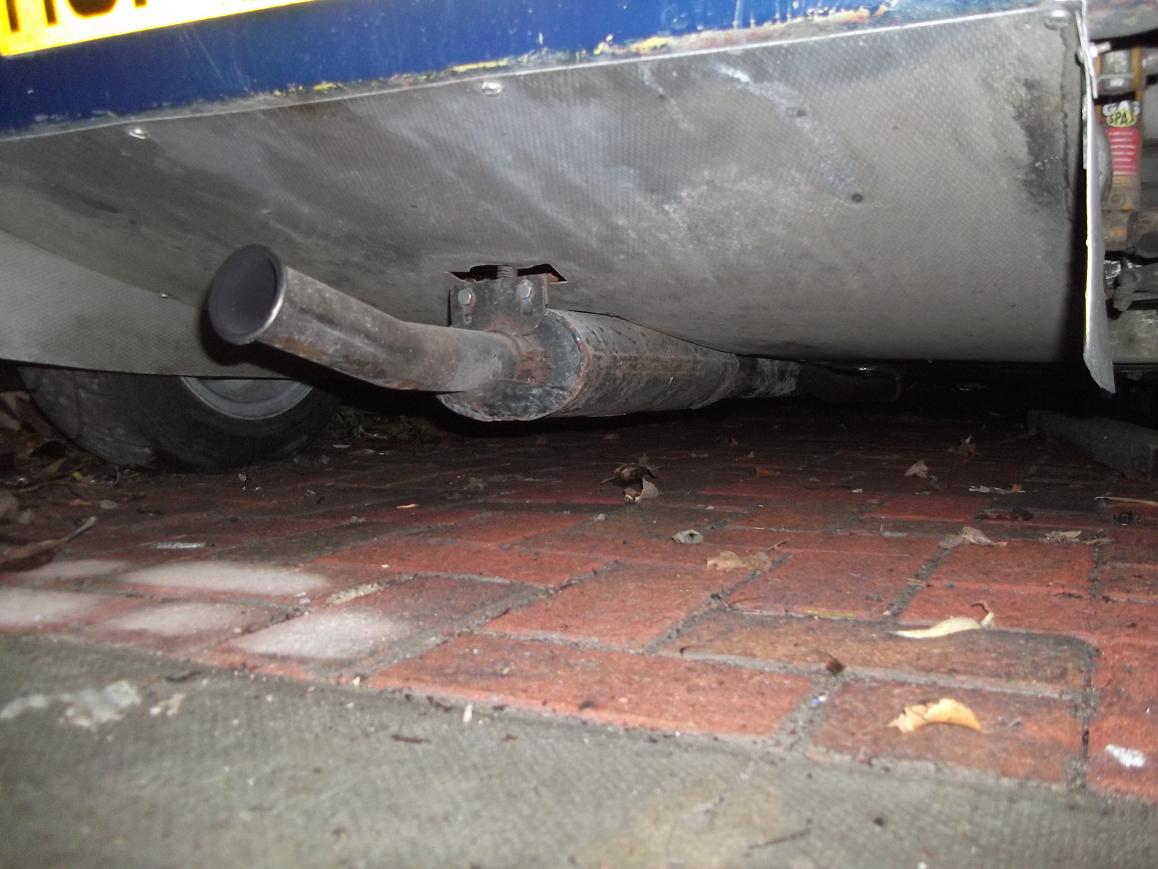

Back of rear diffuser. |

Good photos Allan. That's the reason for my experiments - to smooth the airflow under the car and try and reduce drag. Putting a smooth cover over the subframe may also keep some of the dirt offof the fuel pump (on my car). I would have the fuel tank in the way too, of course, so couldn't raise the rear in a diffuser style.
Interestingly, I would look to have a lip going up the front of the rear subframe, between the subframe and the heel board if room allowed. I've read this is the best way of achieving a smooth flow.
If I get the gearbox stripped down tomorrow, I'll try and set up the tunnel and show the results I obtain. Also - are there any other MM models anyone knows of I could try using, preferably with a more accurate underside? |

Have you considered putting rubber skirts along the lower sills of your car (regs permitting, of course). I'm thinking something like conveyor belt type stuff (quite rigid) mounted behind the wheels, probably fixed on the lower floorpan bit. Not really practical for a road car, but I believe containing the air within the floorpan area (as opposed to spilling out the side between the front and rear wheel) can have a big effect (as proven by Colin Chapman!). One thing I have learnt through investigation/reading is just how much air is forced around the sides of cars, not up and over as you might expect. In fact this is something that my mini tunnel might be able to show.

Rodger, I'm not building the car to compete - I'm aiming for a nice long legged GT car hopefully (one day!). The wind tunnel is for a college project and my idea for the flat bottom undertray is to smooth airflow, hopefully reduce fuel consumption, improve refinement (by reducing wind noise) and hopefully help keep some dirt off of the fuel pump. I'd like to think the car will be IVA'd in time for the LMC 2016 - that's the target, and will be sure to cheer you on! (I admt, it may not have any fancy underfloor arrangement though - I'll just be happy if it materialises on the road)
I seem to recall when Peter Stephens designed the body kit for the MG ZT's, he stated his aim was to remove lift from it (as opposed to producing +ve downforce). One of the ways he went about this was by trying to manage the flow under the car. But if the MM is actually neutral lift already, by smoothing the underfloor some downforce may result (if class rules allowed you, of course). |
