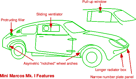

3.3 DetailsBody number ranges given below are based on cars known to the club. Mark I (1965-66) - look for notched wheel arches, fixed perspex door windows with sliding ventilators for racing, otherwise aluminium frames with pull-up windows, non-recessed fuel filler and very narrow number plate panel under the nose. High open-bottom tunnel; fixed rear window; fake louvres behind rear side windows. Made by Marcos Cars Components Limited, Greenland Mills, Bradford-on-Avon. Body numbers 6001-6152 (Mk. 1). Dimensions:
See side elevation and plan drawings and photos.
