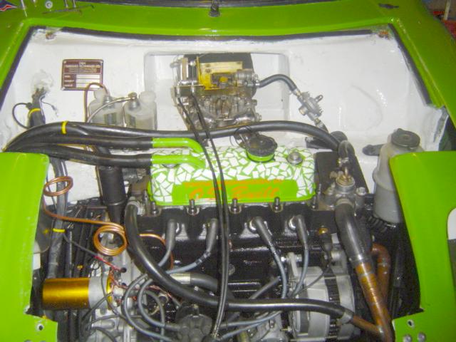

Engine1380cc A-series, full race head with 37mm and 31mm valves by Billy McMillan formally of Nick Stagg engineering, Omega offset bowl forged pistons, lightened Metro rods, wedged, cross drilled and bladed crank, Kent 310 scatter cam, 1.5:1 full roller rockers, ARP fasteners used through out. Aldon yellow distributor with ignitor and Lucas sports coil, Dellorto 45 on 7" Maniflow inlet, large bore Maniflow LCB with modified 2" Maniflow system that exits through the rear panel. All built by Ollie Howell of O S Built Racing and set up by Dave Young at MechRepairs.
