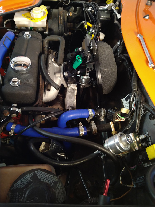

There has probably been a double carburetor before, so a big hole has been cut in the bulkhead, so I had plenty of room

So the inlet manifold fits - it's tight but it fits:
There are a couple of issues ot be addressed.
1. The Specialist Components stainless exhaust manifold has a different thickness flange than the inlet manifold (this was the same situation with the MPi inlet manifold) so I'll have to make a set of shims for this.
2. It's very difficult to access the inner branch studs for fitting the manifold nut too.  Also the MPi nuts (which have an in-built spreader washer doesn't seem to fit, so I'll have to find out the thread size and get some alternative nuts.
3.  The throttle cable on the SC set up exits the throttle body vertically, whereas on the MPi set up it exits horizontally.  This could be (will be) a problem with the bonnet in place.
Bent - did you see this throttle cable problem?  How did you address this?
