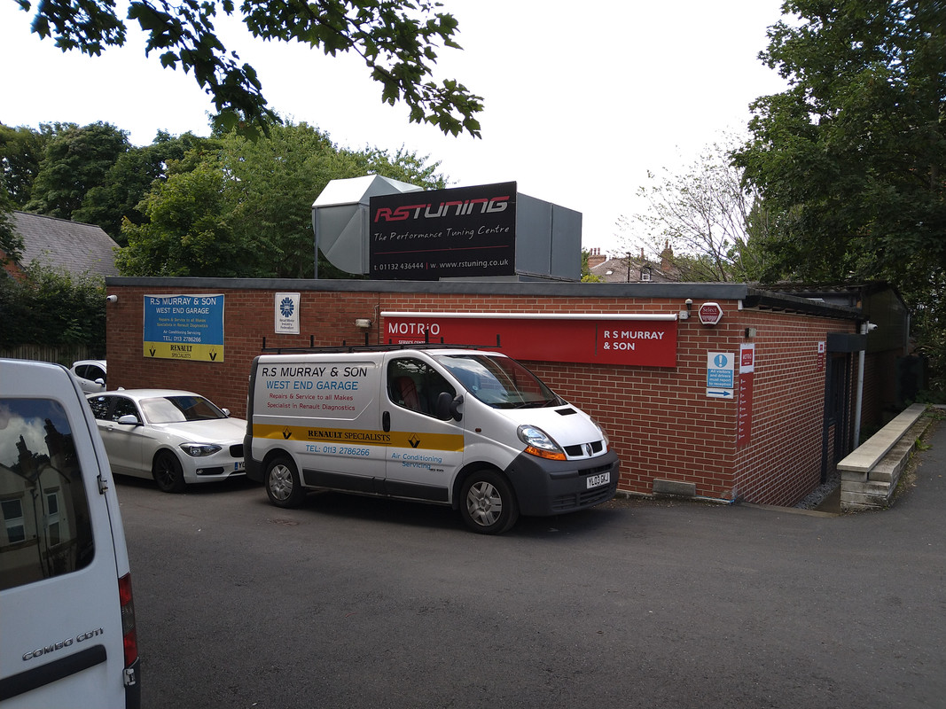

Went to visit RS Tuning in Leeds on Friday:
photo hosting sites
The garage is located 'down a back street', at least the way the satnav took me.  But it certainly didn't have the look or feel of a back street garage - clean & tidy, appeared organised.  And took the time to have a quick chat about the MM and what might be required.
While I don't know anyone who's used them personally, there doesn't seem to be anything negative online either, so these could be the people to map the ecu.
What the guy did recommend is sorting the throttle cable throw first to prevent having to have a revisit to re-map at a later date.
Not quite sure what the solution is for the throttle cable at the minute (full throttle application only opens the butterfly approx. 75%, so a longer throw needed somehow I think).  I also need to get a 90 degree bend cable made.
And I'll need to sort out getting the car transported to (and back from) Leeds, which I'm sure won't be cheap.
But another small step forward I hope.

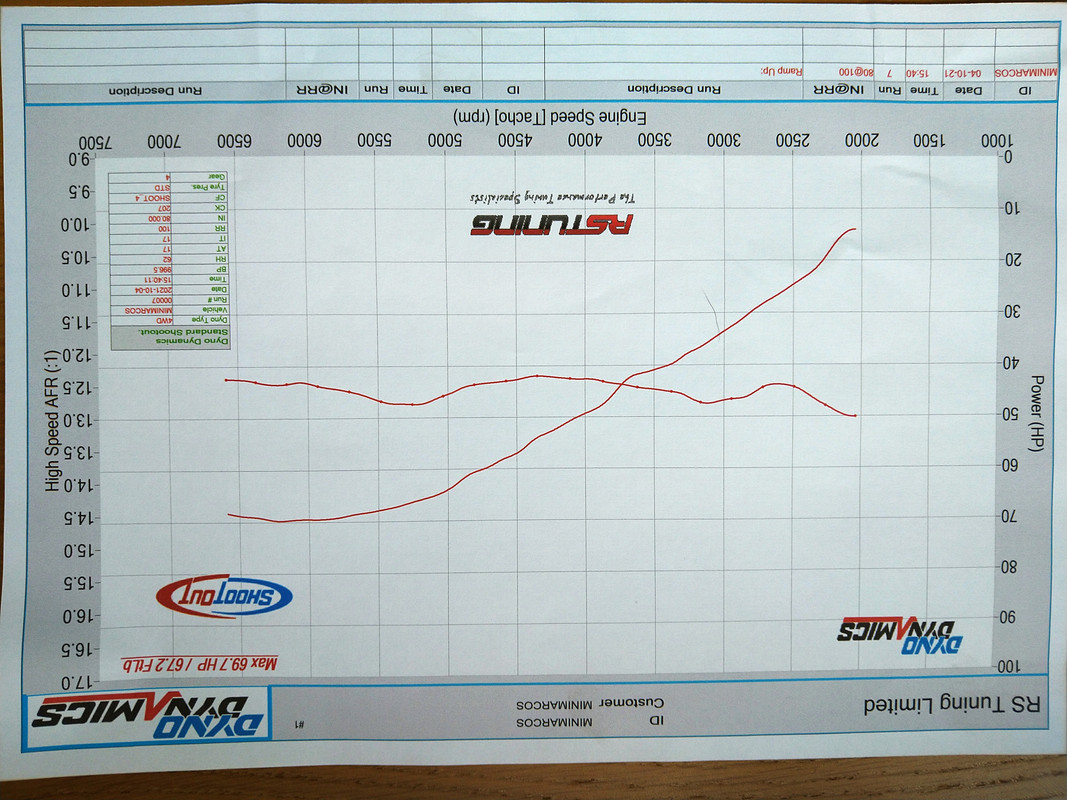

Finally, while my scanner isn't working at the minute, a couple of photos of the printouts received from RS from the session:
This first one gives a plot of power/torque - 88.7bhp (89 for cash?) and 85.6 ft/lbs.  While I'd hoped for a little more power, look at the power/torque curves!  Should be very nice to drive (eventually!).  RS did say that the car could probably do with another hour or so on the rolling road to fine tune the car when it has a few miles on the engine.  Hopefully it might break 90bhp.
As an aside, MPI mini 90bhp kits used to give around 82-85bhp (on a good one), and I know 1380cc carb engines can give 100bhp, so ~90bhp on a home built engine with a home ported head isn't so bad.  And at least I know it holds together up to 6600rpm .
This second photo shows the fuel/air ratio (14.7 being stoichiometric):
So there we are - two steps forward, one step back (again!).
